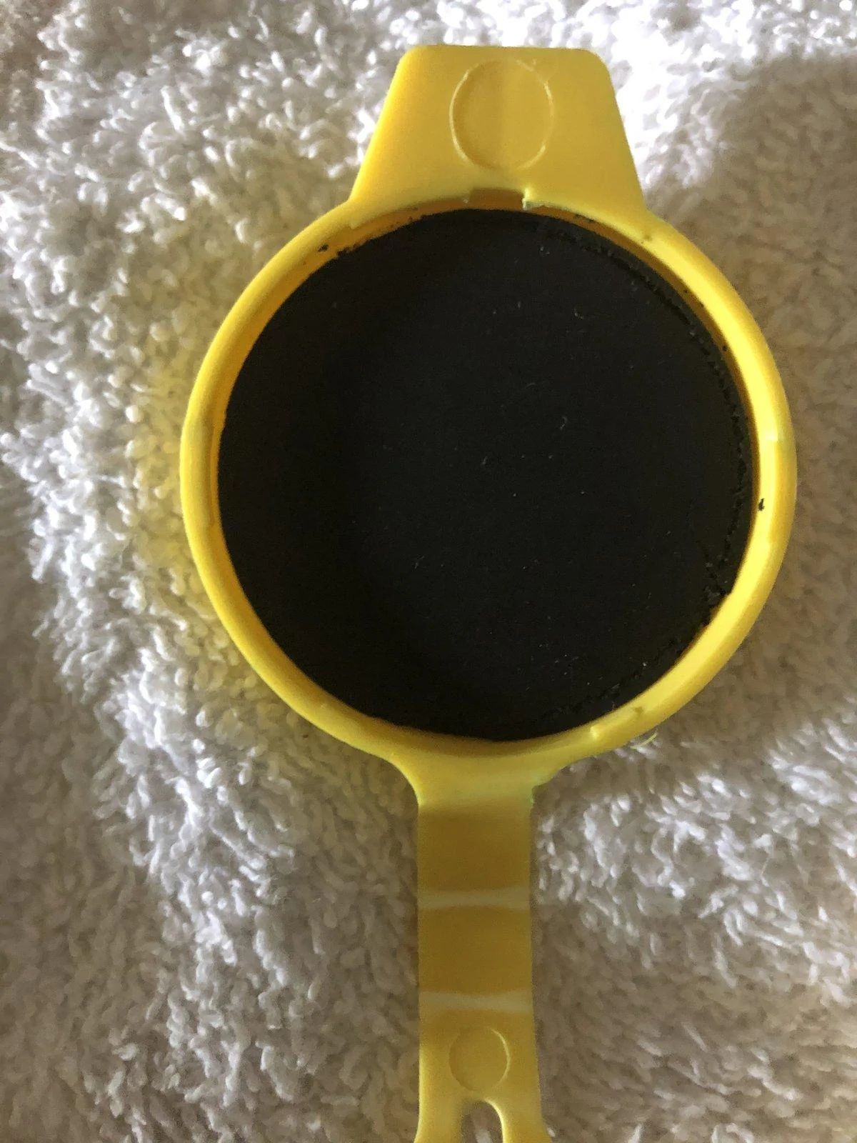

Here is my original cap after I tried peeling off the rubber seal and sticking it back on To center it. The rubber is either too thick or still slightly off center so that it makes the cap sit slight ajar. And the rubber is torn up a bit. Some of the rubber elderly fell in reservoir. Maybe 1/16” an inch. Just not completely tight.
