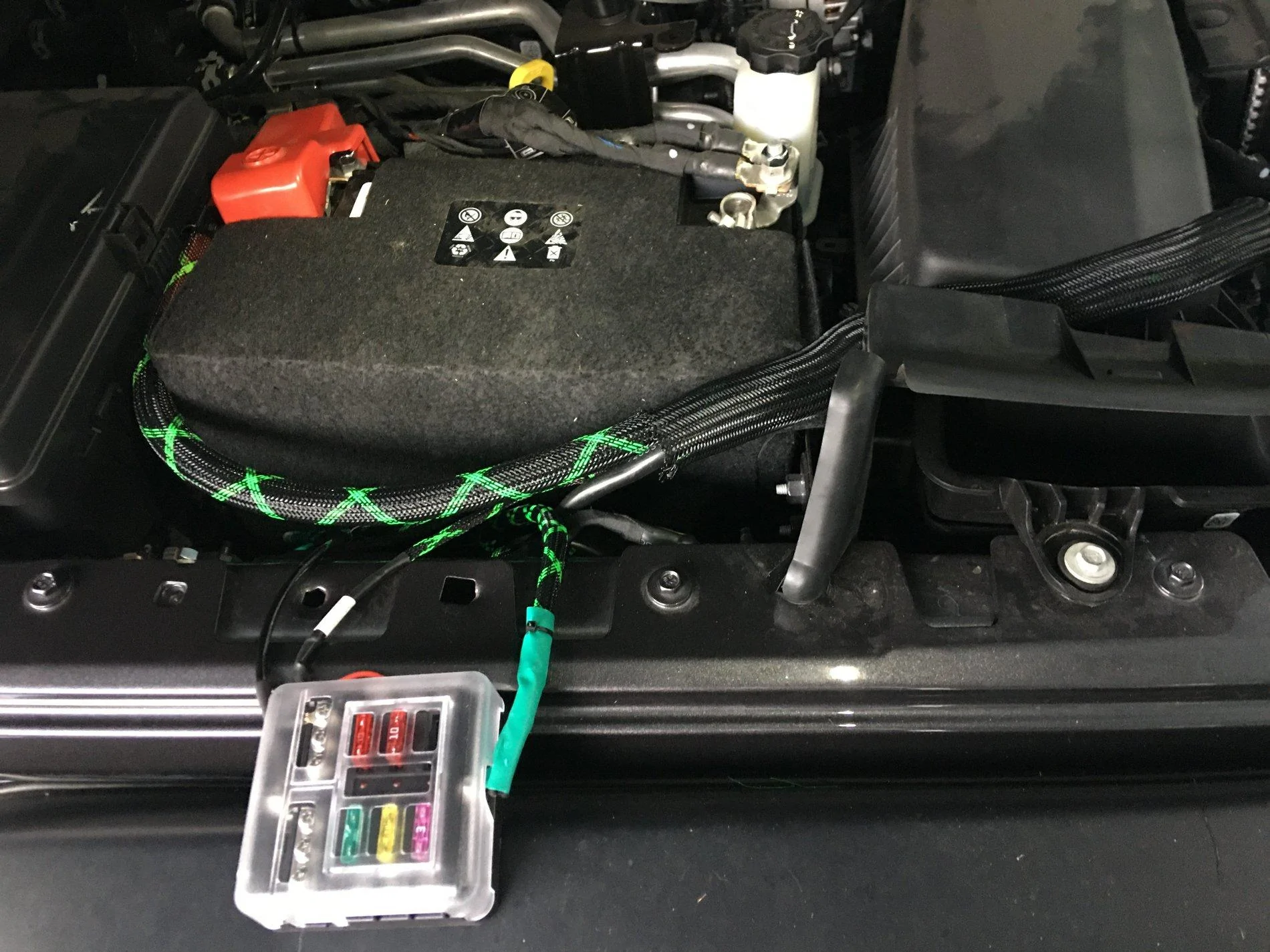

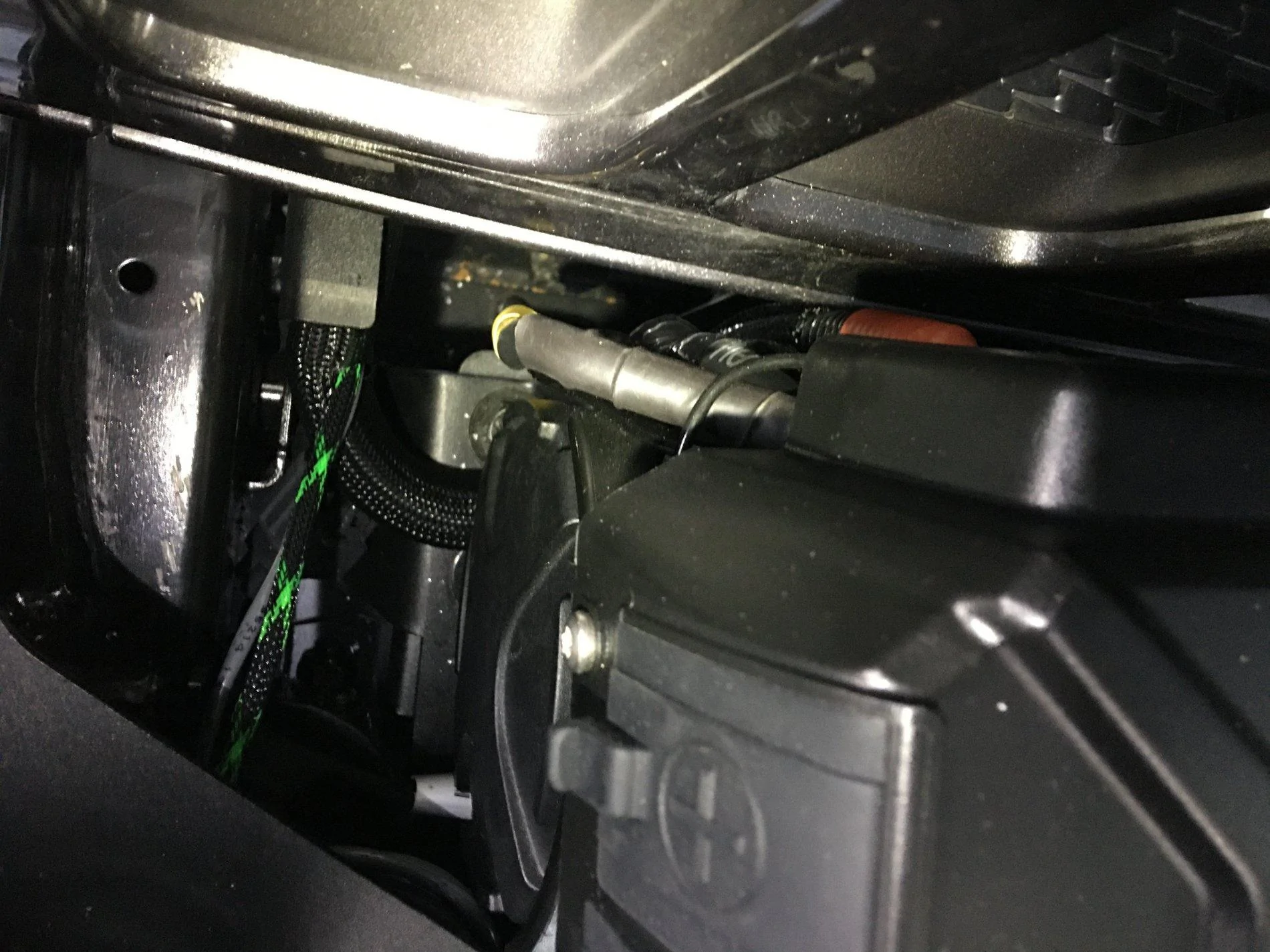

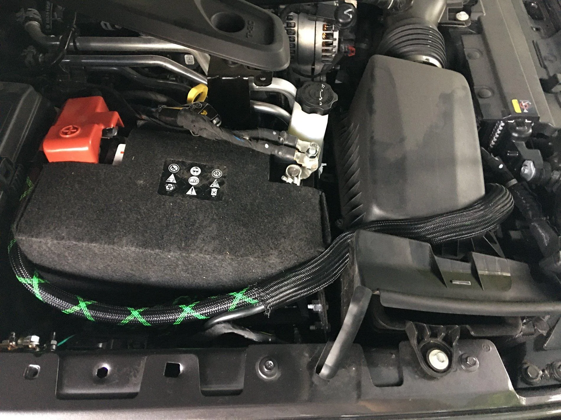

I added a few pictures of how I decided to wire. Used a small fuse block to allow me to quickly add circuits in the future. I ran a common wire sleeve to the front of the vehicle for the power wires to the winch and also the switch wires for the light bar I installed on the front of the jeep.
