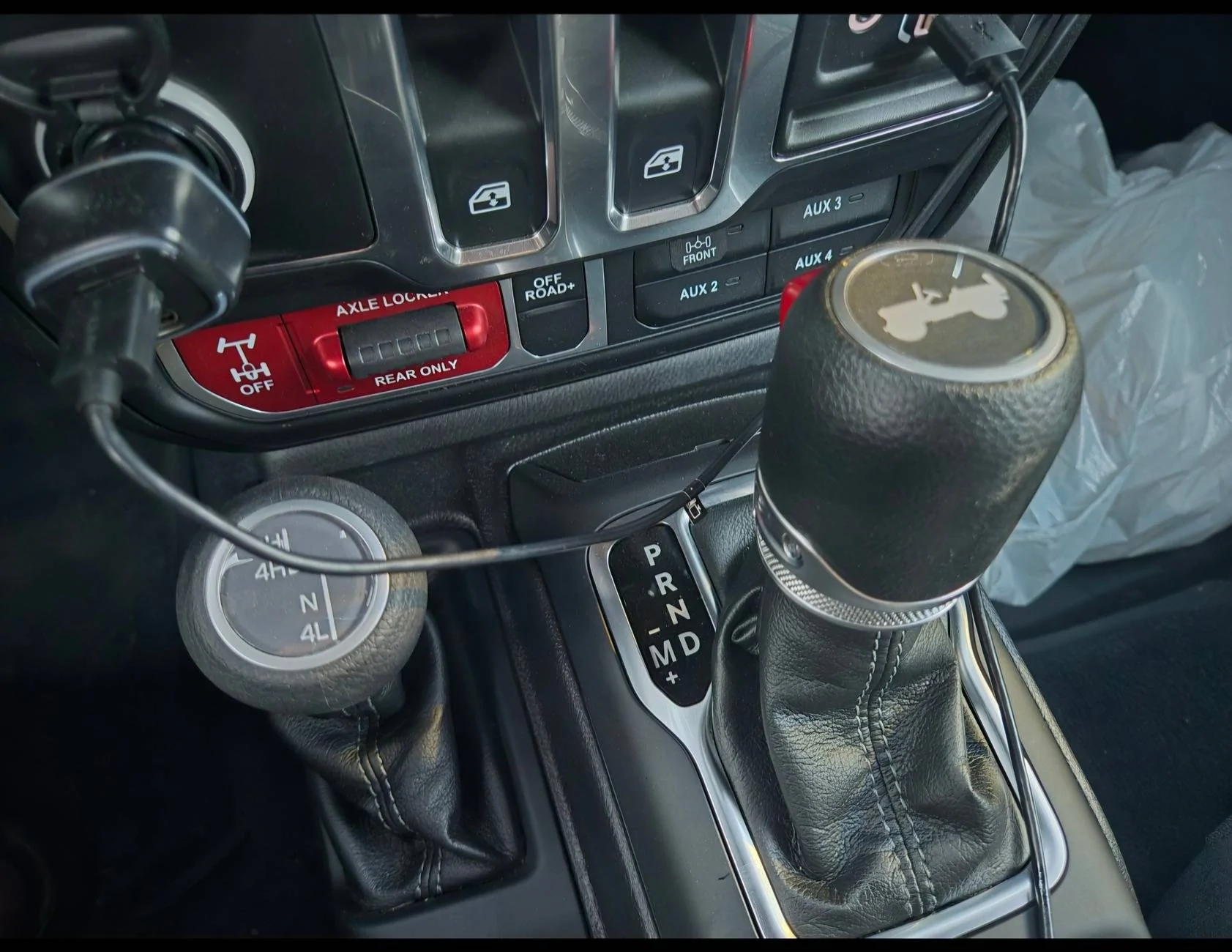

Why does our 4WD thingy have a Neutral?

Maybe it just means you have to be in neutral before going into 4low. Just throwing a guess out there.

No, I don't think so. The long one has to be in neutral for that.

The Jeep is being towed by a larger vehicle. Typically a motor home.
You ever see a vehicle attached to the back of a RV? Just means towing with all 4 tires on the ground.
I see, yes I think I have seen those. Thanks. Which means I should be Towing my Jeep like that when I get my dream truck, Ram 2500 6.7 L Cummins, Tradesman regular bed

For flat towing the transmission should be in park and the tcase should be in neutral. This works because the rear output shaft on the transfer case drives its pump so fluid is still circulating and the case doesn't overheat. The transmission on the other hand has fluid driven by the front pump, which isn't rotating if the transmission is in neutral and being spun by is output shaft. Nearly burned my old XJ up flat towing when my dog hopped in at the gas station and stepped on the transfer case shifter putting it back in gear. You could hear the fluid inside the transmission boiling when I pulled over from the smoke in the rear view. Trans was shot obviously.

So it can be flat-towed behind another vehicle. We towed our '03 TJ and later out '10 Liberty behind our motor homes for 20-years ans thousands of miles.
