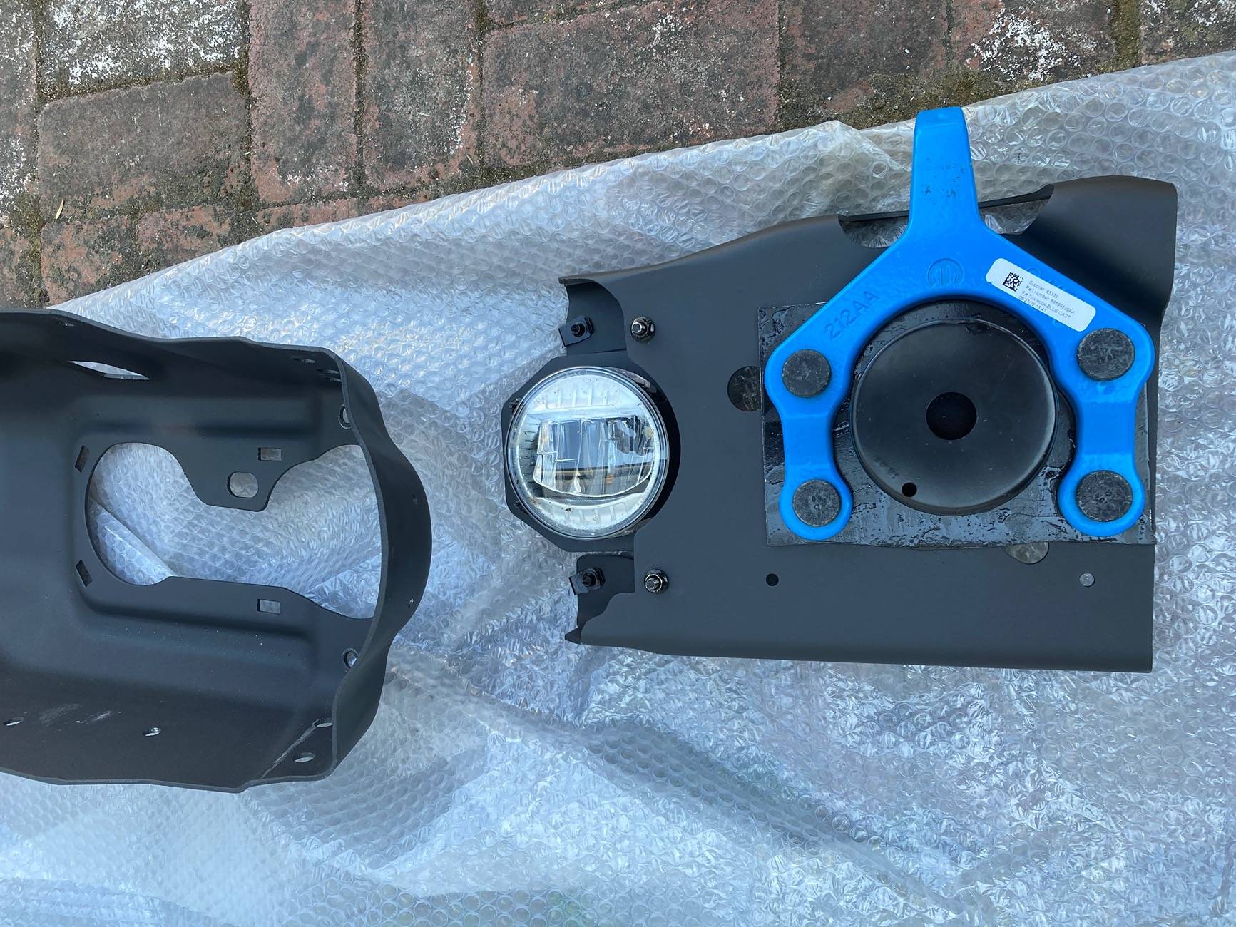

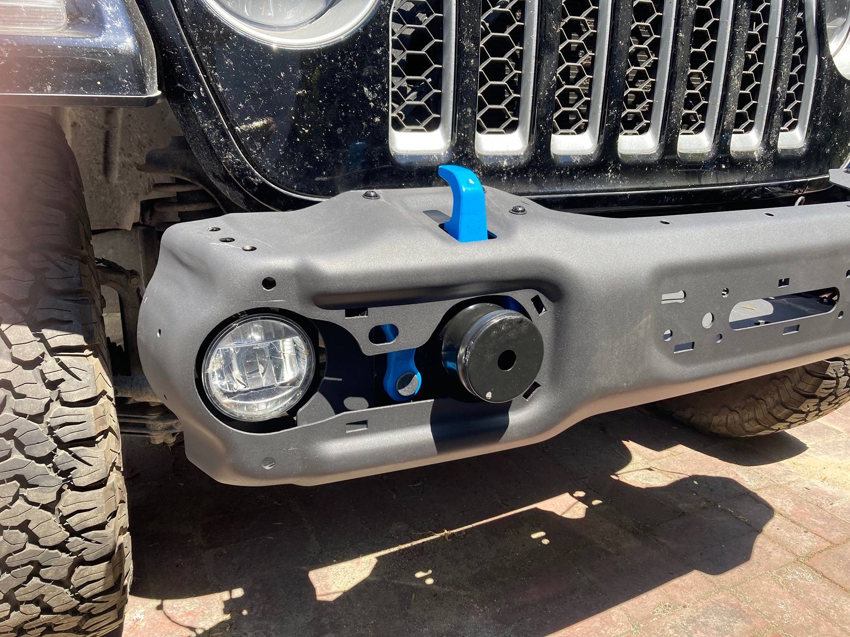

I wanted to keep my blue hooks, so I did the exchange yesterday. That required fully dissembling the old plastic bumper (already mostly taken apart anyway to retrieve the wire harness) and taking off the MP wings and inside aluminum bracket pieces on each end of the bumper.
I also reused the OEM hook bolts and nuts.

I was a bit reluctant to destroy the OEM parts but my winch wasn’t arriving for a few days so I sawed off the crash/crunch cans, took apart the MP bumper again and added those. Now I have some extra sheet metal for other possible projects.

The MP Concepts bumper has to be taken off of the Jeep and completely dissembled to do these mods. I thought I could remove bumper shell while on the vehicle, but it wouldn’t come off.
