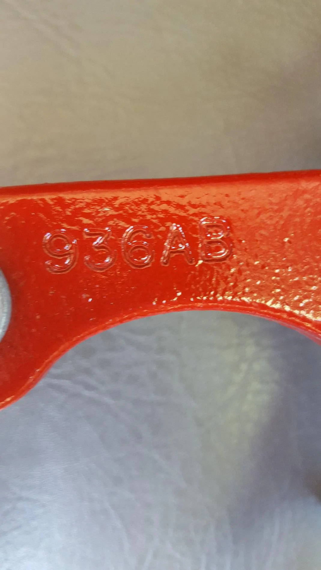

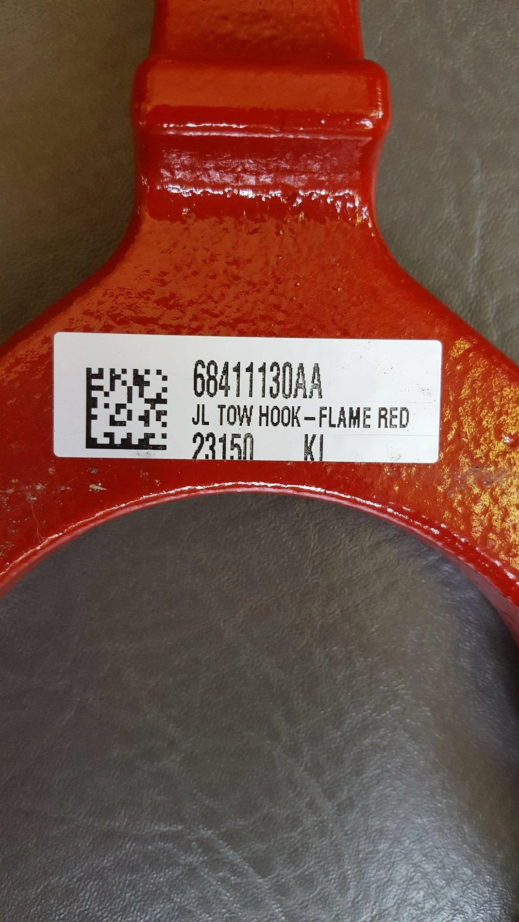

I took my stock bumper off today, and I *think* there was a part number on the hooks. If nobody gives you an answer by the morning, tag me or message me, and I will go dig them out of the box to check.

There are tons of vendors of Mopar parts online, though I think you'll find that searching for that part number (6841130AA - nice find Michelle!) will take you to a ton of distributor links. Unfortunately, most Mopar distributors provide very little in the way of product detail, other than the fact that it's a hook. I would "assume" the part number Michelle provided is tied to the red color, but just to be safe, here's a recommendation...
