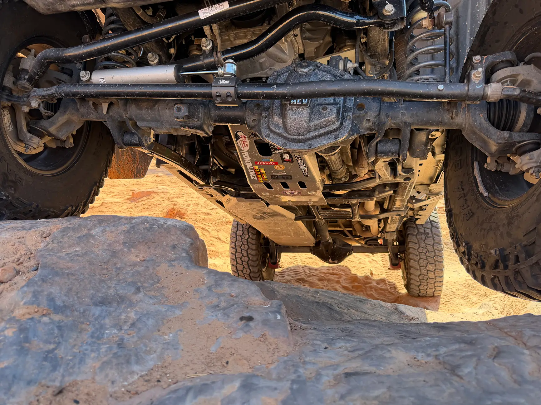

hard to beat ASFIR4X4 for price and customer service...Mine shipped from Israel and was delivered to Montana in like 3 days from ordering it seemed impossible..
Jeep Wrangler JL Which Skid Plates Work With e-Torque 3.6 Engines? tempImagev2KXlf

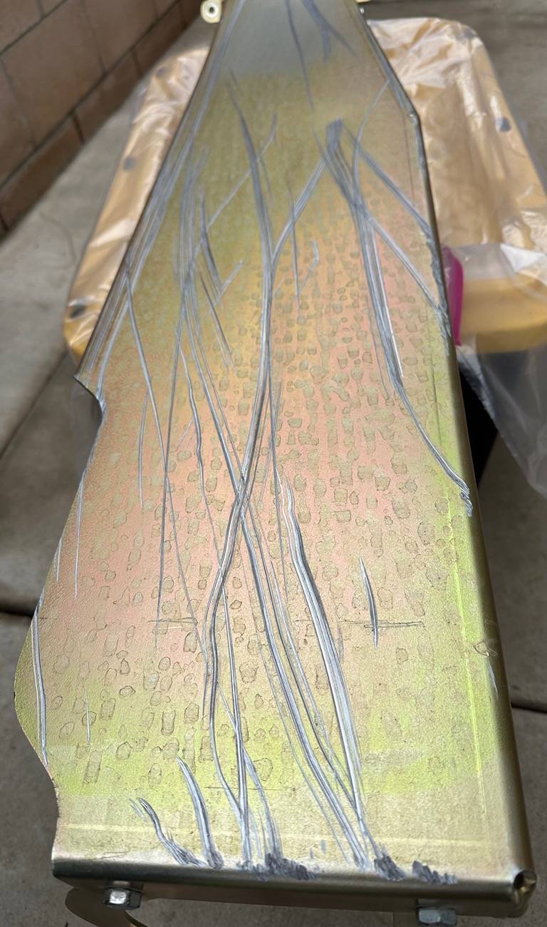

Another vote for @Metalcloak skids. I have done things to their etorque battery skid with no concerns. As a side note, seeing you avatar and speculating based on the user name @yokramer I’m going to guess you are more Jesus dude looking.
Jeep Wrangler JL Which Skid Plates Work With e-Torque 3.6 Engines? {filename}
Yea Ill hand it to em the undercloak can take a beating, and they were SUPER quick to ship out a bracket that went missing in shipping too.
