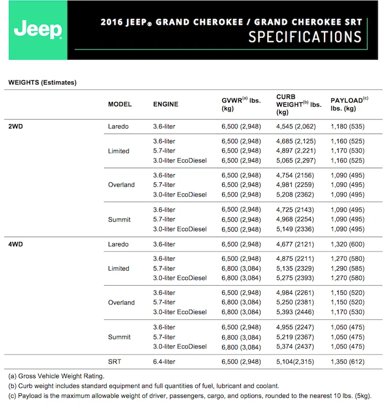

800-900 lbs less would be amazing ... but I bet that the VM Diesel weights more then the V6 Penstar so you would gain some of that weight back .... I wonder what the weight difference on the grand cherokee is between the V6 Penstar and the V6 Diesel?
Looks like it's about 400 lbs in each trim. HUGE difference so we're probably looking at most about 400 lbs lighter than the Ram 1500. I'd bet the JL is no lighter than the JK with what's sure to be a more complex roof structure and some more interior comfort features.

I bet your right .... but still 400lbs should be enough to see a bit of MPG gain, although the Wrangler aero could make that even.
