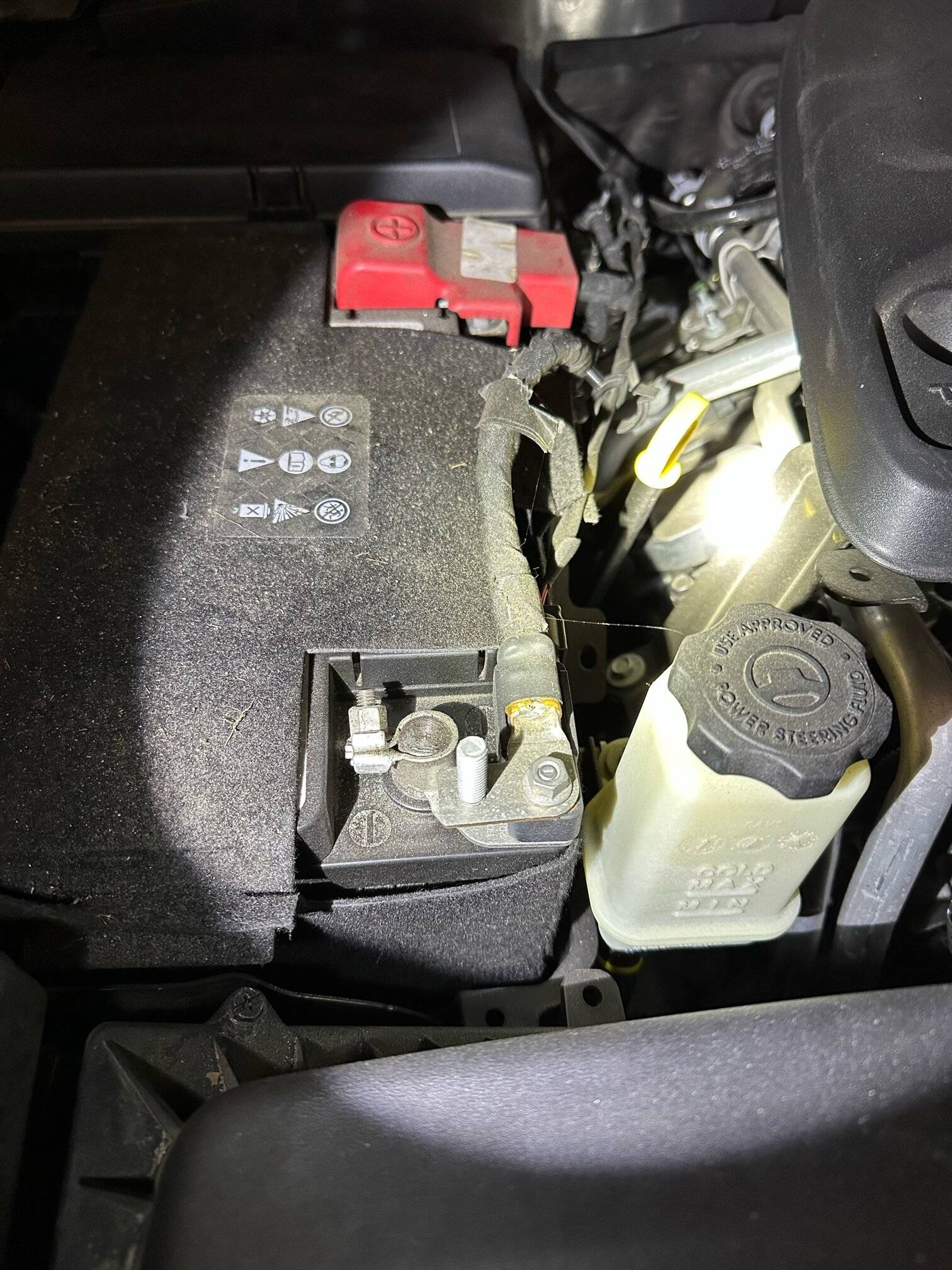

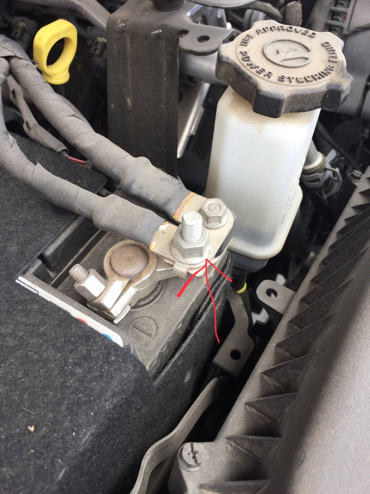

Just saw this video and riddle me this, why does my 2021 have a "positive" lead for an aux battery but no "negative"??
You have an eTorque, JL...
To tell ... eTorque or not...
Pop the hood and in say 15 seconds you can take a looksee and tell if it is an etorque JL or not....
With eTorque ........and the JL, you will see the factory has placed a solid metal jumper between N1 and N2 in the Power Distribution Center (PDC).
You will also find that there is NO, Aux battery negative cable attached to the Main batteries Neg terminal... you will just see an available stud on the Main battery neg terminal, with no cable attached to it...
And indeed, the plastic box under the PDC/ hiding behind the passenger fender flare, is there... but does not have an Aux battery in it.. it is just an empty box.
And of course, if you crawl under... with eTorque, you will see, the 48v battery box will be these... - (with battery) just ahead of the rear axle on the drivers side.

Cool thanks, I saw your post which made me look. Thanks for that.
I got the dreaded "AUX Switch, battery charging" alert, so I'm taking it to the dealer tomorrow morning.
