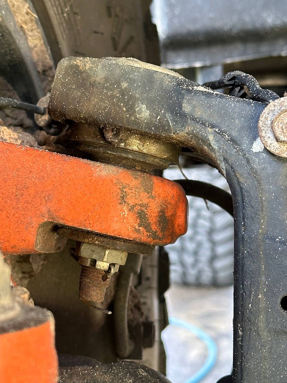

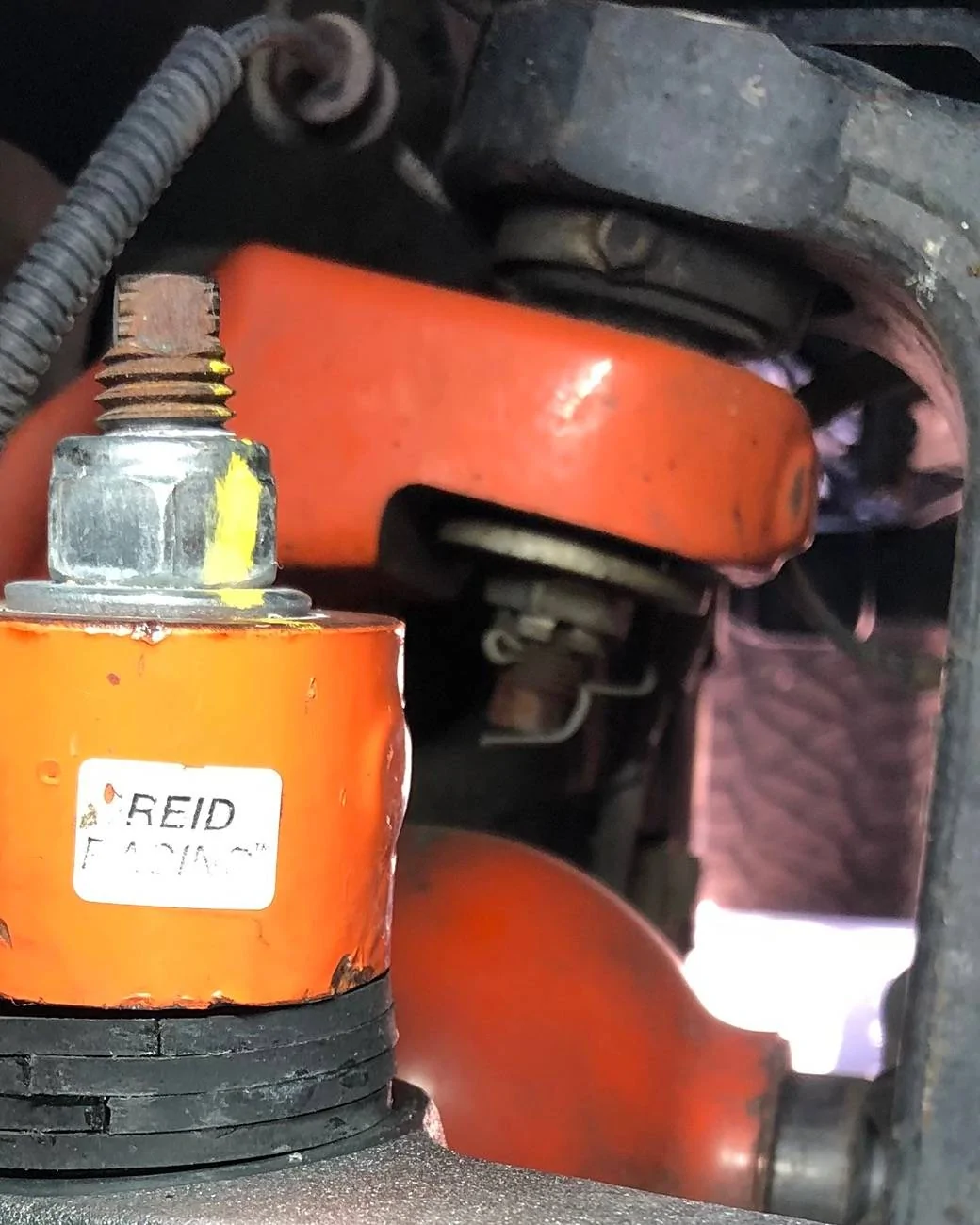

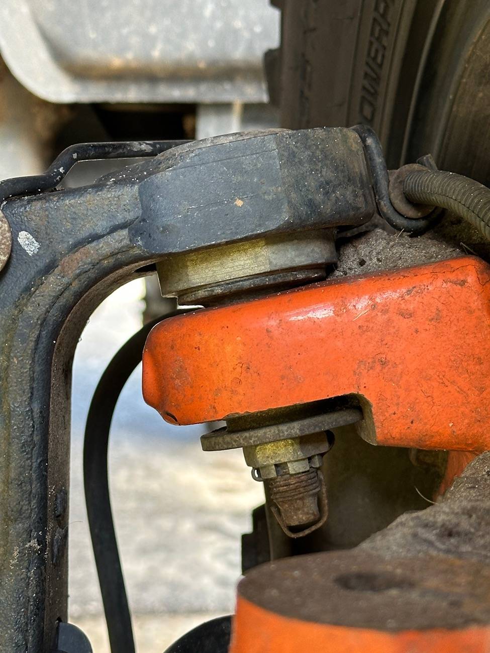

Was out wheeling over the weekend and now I notice a very slight pop/shift/thump type feeling when turning the wheel initially in either direction. Thought it was a tre but was under looking for anything out of the ordinary and noticed the ball joints sitting differently.
Driver side:

Passenger Side:

Old Dogger
Bill
Nov 15, 2021
3,276
3,960
Cave Creek Arizona
Your top Ball Joint is loose. Some of them left the factory that way. Torque it to 55 ft. lbs. Then you will have to tweak it a bit back, and forward for the cotter pin to fit in the hole. The actual specs are:
Top ball joint: 52-59 ft. Lbs. Bottoms ball joint: 30-37 ft. Lbs.
I suggest that you retorque all of them.
Lofty
Casey
Oct 16, 2023
76
76
Ohio
JL Wrangler
Seeing as you don't have stock knuckles or ball joints it's a little hard to determine. The gap seen on the drivers side camber slug to Knuckle (bottom of Knuckle to flange of slug) looks closer to that of a production axle. I'd lean towards that side being the noisy side.

Be on the safeside, replace them with the Metalcloak Baller Joints

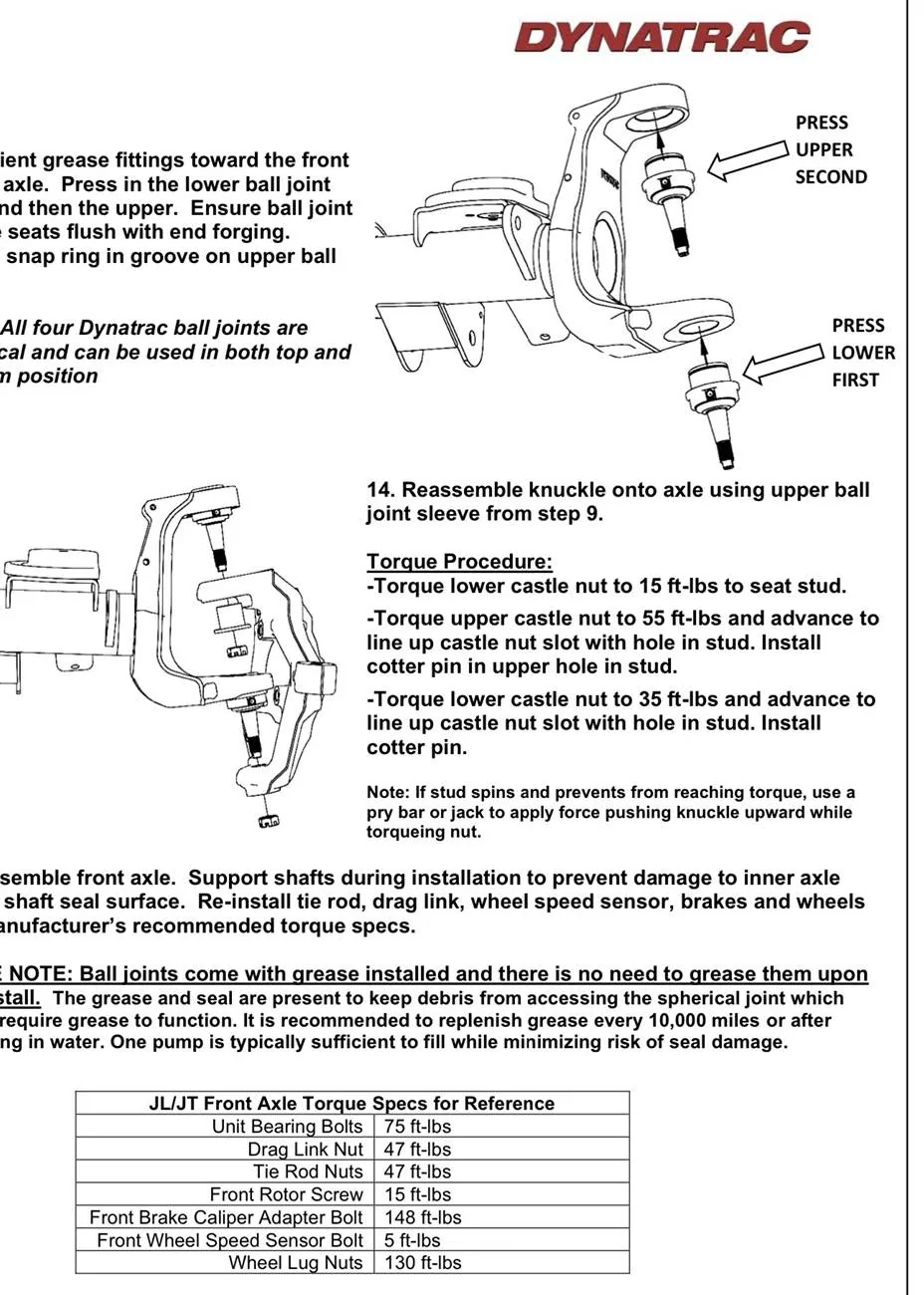

Here is torque spec for Dynatrac ball joints…..

However, I don’t think they’re the problem, ( I could be wrong, happens a lot, 🤣) Dynatracs sit that way sometimes, here’s mine for example:
Jeep Wrangler JL Which Ball Joint Is Off? IMG_9026
I would check the drag link and tie rod ends and track bar….even if it’s aftermarket…I had same symptoms you’re describing and it was my Yeti drag link that shit the bed…..
