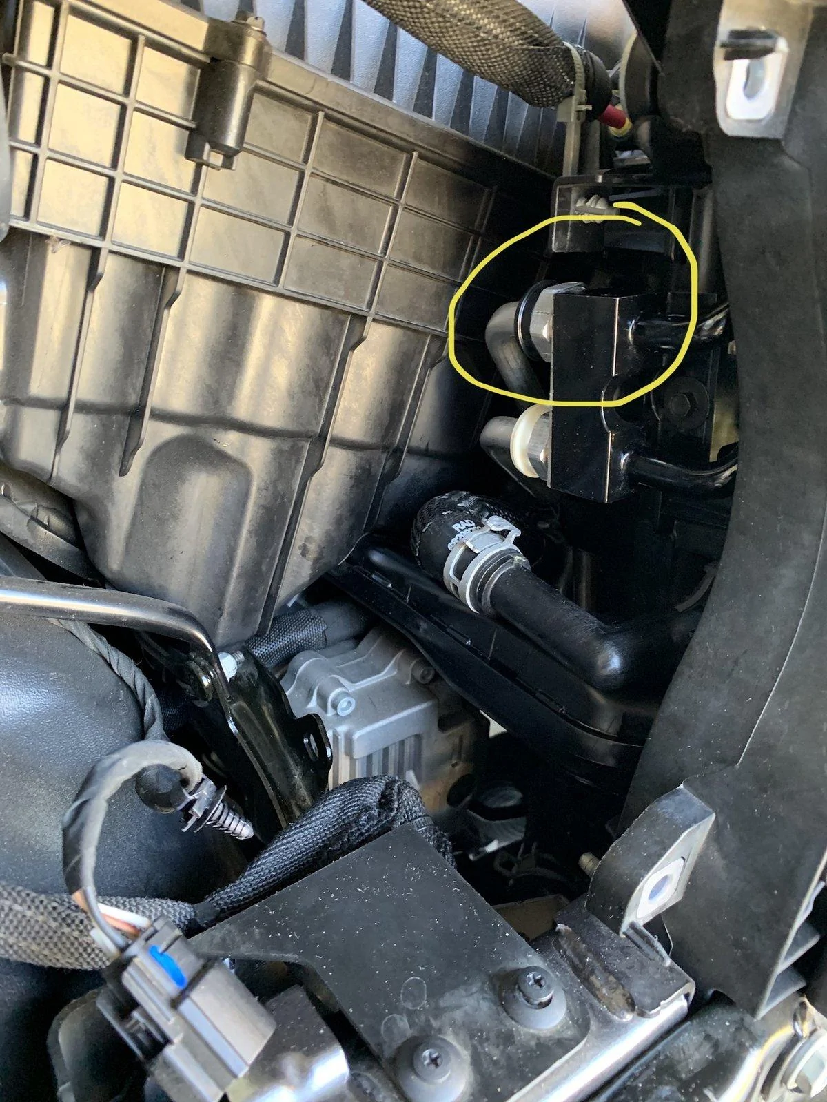

I don’t know of this will help or not, but I traced my leak up to this manifold. I’m not entirely sure what fluid flows through here but it’s gold and could be engine oil. Hope it helps.
Jeep Wrangler JL Where's the leak!? E31FA3FA-54B4-4C1B-A21C-22A94B365FEF
Where is this?

Right next to the passenger side headlight.

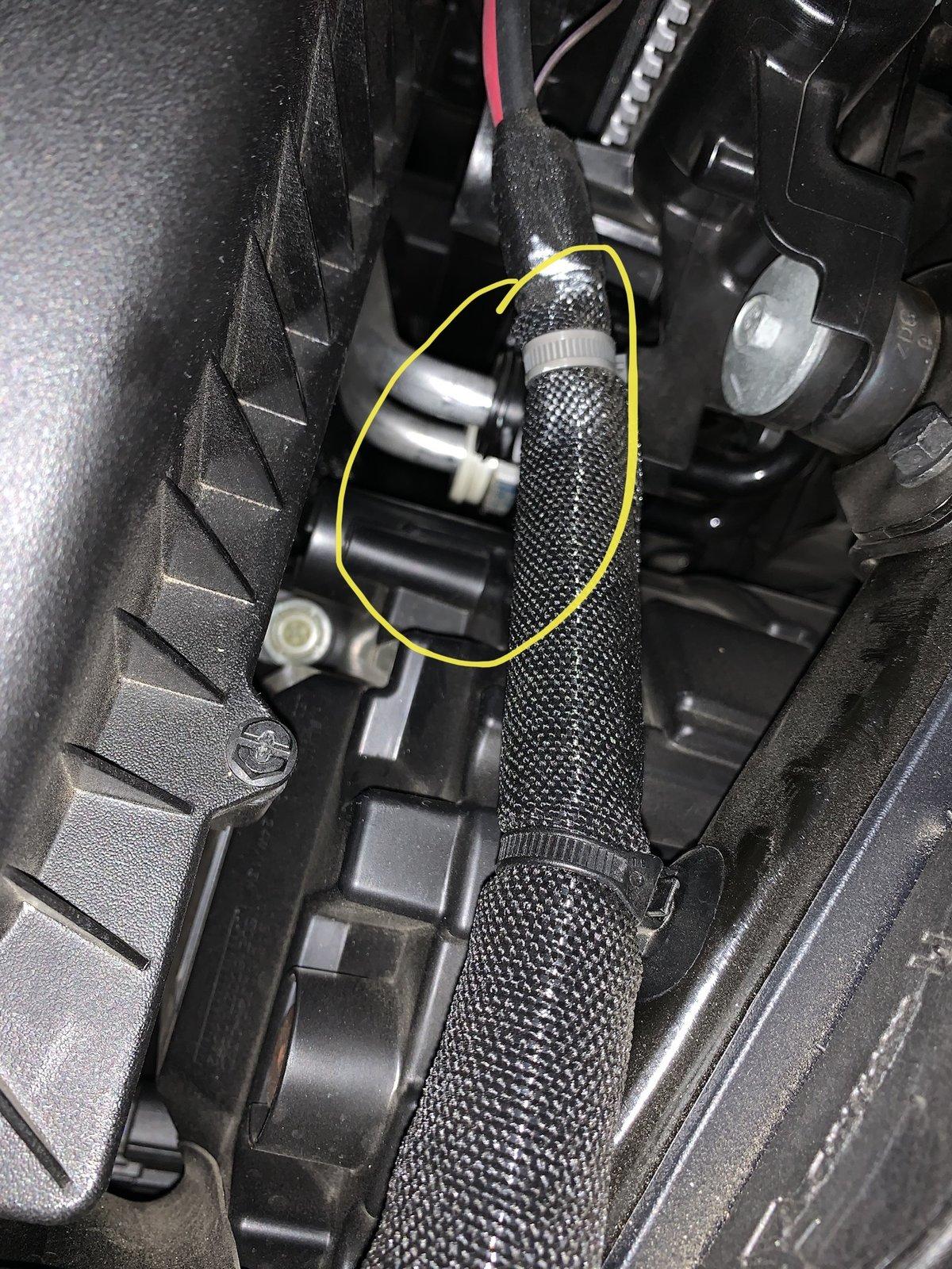

Fixed it!
Sadly, the nut that was causing the leak was literally hand tight. I'm shocked the leak wasn't worse. It turned out it was the top line, and I might have been able to access it without pulling the grill and headlight. However, it made it easier to find the source.
It looks like the oil was dripping, and then the wind was blowing the drops farther back into the engine bay.
Jeep Wrangler JL Where's the leak!? IMG_0550
