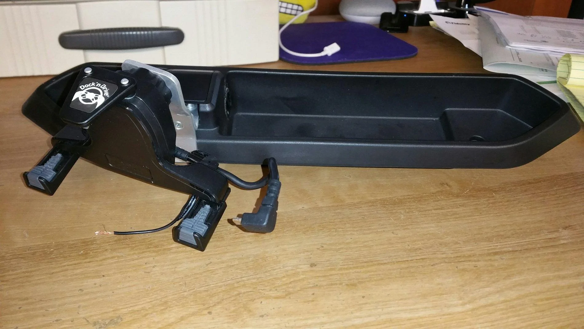

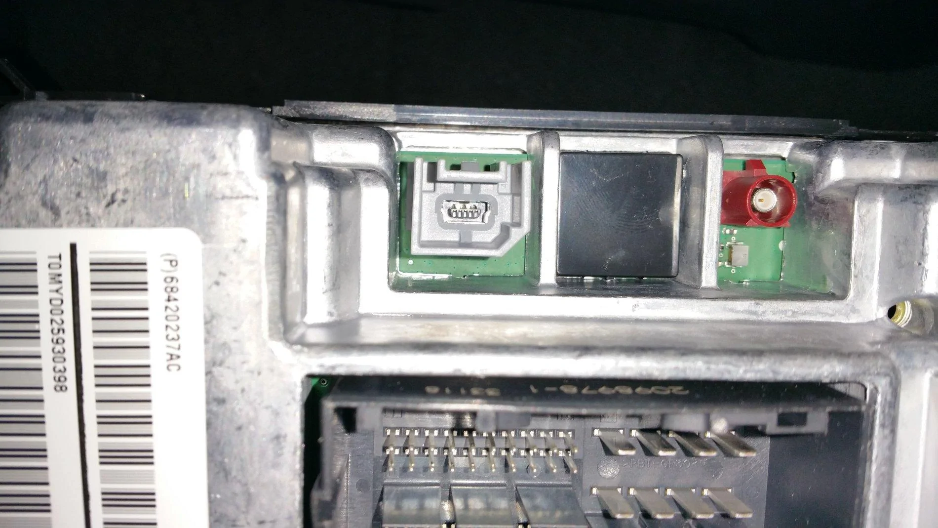

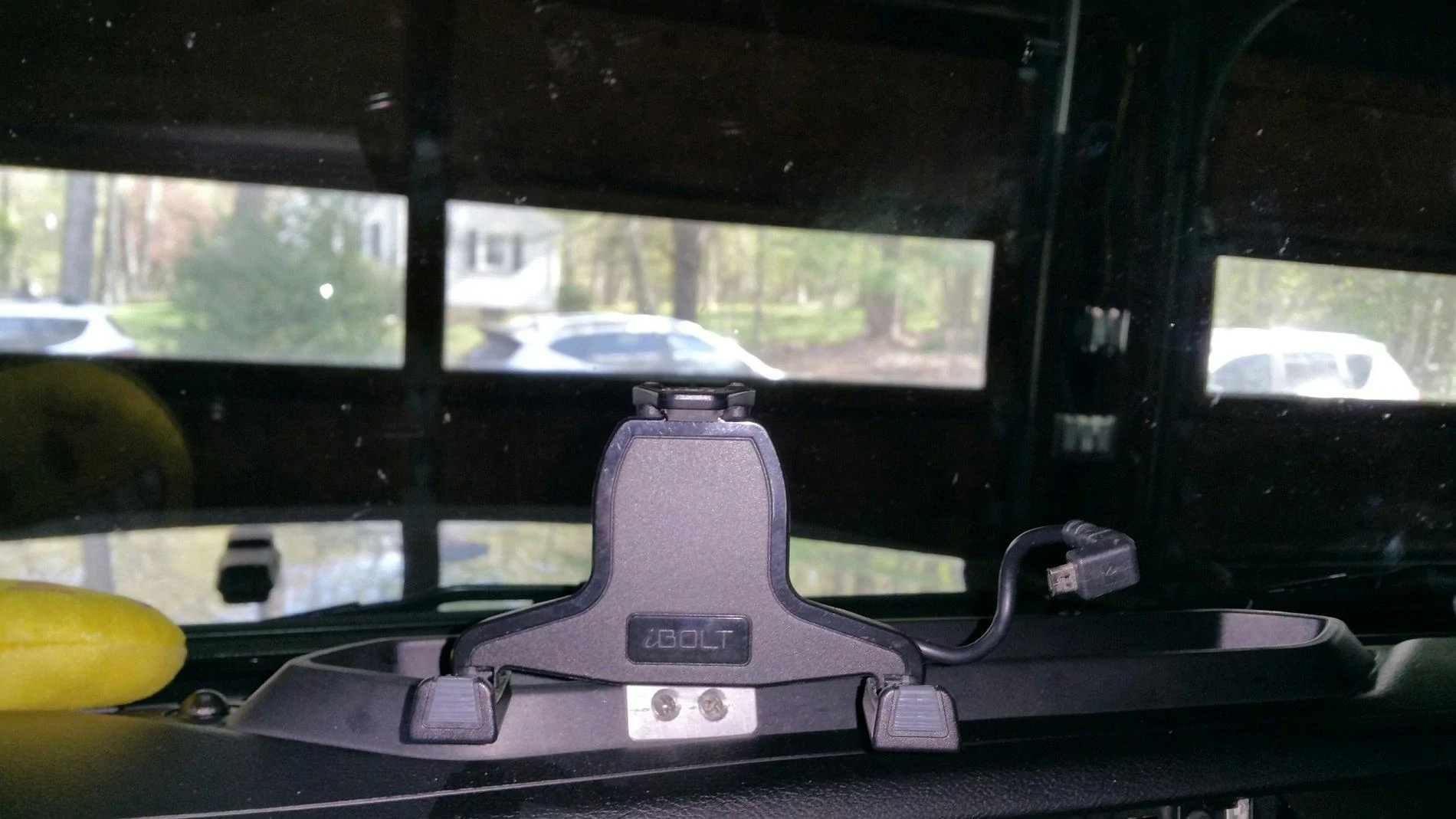

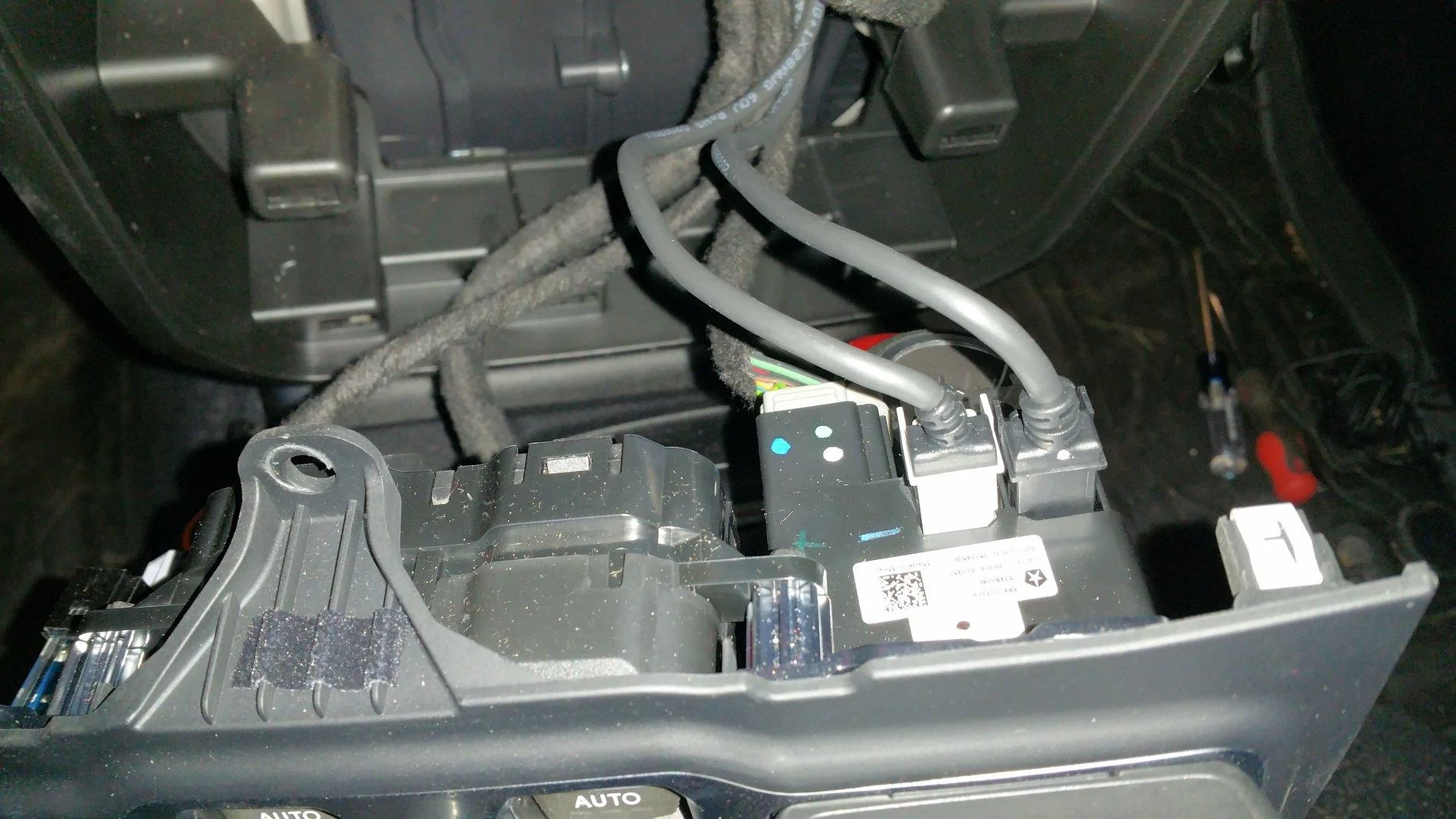

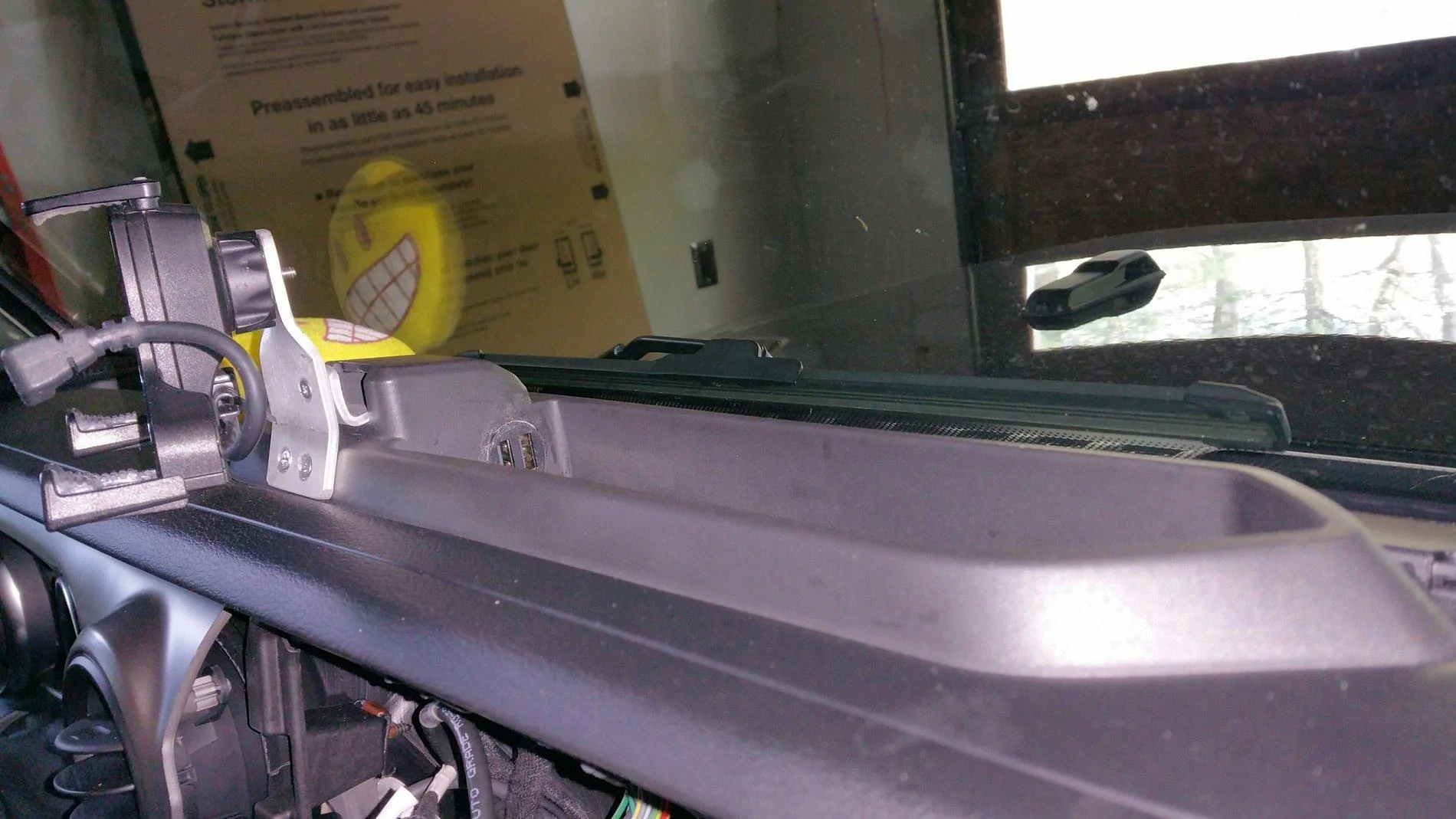

The single usb port on the back of the radio (uconnect 7) is of the "mini" female. This cable runs first to the dash mounted data port (in connector). The a second cable runs from the dash mounted data port (out connector) to the center console data port. I have not yet investigated what is in center console, but the dash port is probably a usb hub. I used a usb right angle cable extension to run it up to the top of dash. Need to keep factory usb in tact as I have music usb attached in center console port. These cables have specific connectors on each end, but looks to have room if a "standard usb cable end was small enough (or was ground small enough). I to hate cable clutter. In an effort to not cut factory stuff I opted for a aftermarket dash bucket, mounted an i-bolt phone holder, and usb charger on that. Can easily be removed. https://smile.amazon.com/gp/product/B07QB6RYV2/ref=ppx_yo_dt_b_asin_title_o07_s00?ie=UTF8&psc=1

You're right about the outlets facing up - rain, dust, dirt, windex, etc.. - I had the same thought .... but I also agree it is a really good looking install. I know that tray is removable. I was thinking about an outlet UNDER the tray (buried in the center stack) with just a cable or two plugged in and running out a small port cut into the front-facing rear edge of the tray (hidden from view in the passenger compartment. The cable could be changed by removing the tray and any extra cable could simply be dressed down inside the hole. (I hate cable clutter too. I'm kind of a neat-freak.)
Thanks for posting the info on the radio and the dash panel USB/CarPlay port. I've been meaning to figure out how to get an extra USB cable plugged in.

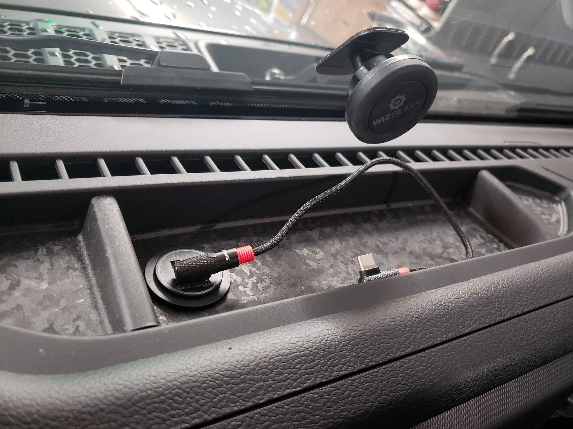

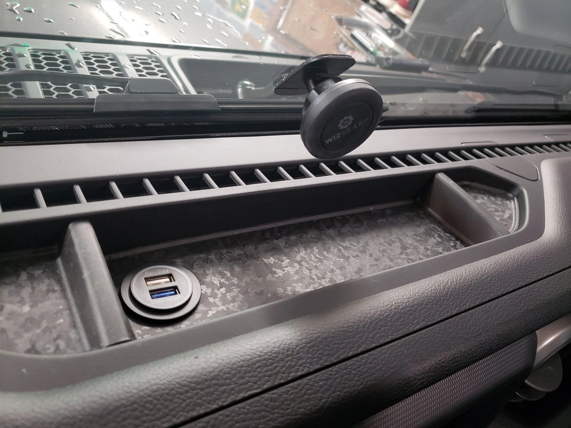

I added a dual USB accessory outlet on top of the dash. I keep my phone on the dash so I can run my dashcam app. Now I can keep my phone charged without running cables to the 12 volt DC adapter.
Tricky parts were cutting the hole in the dash and running the wiring down to the glovebox area... Making the hole on top of the dash was the most stressful part because I was cutting blindly into the dash and not really knowing what was behind where I was making the hole. I did drill a small pilot hole first, then make sure I wasn't going to cut anything.
To make the hole, I had to heat up a hole saw bit and use it to melt the hole. I went this route because I couldn't fit my drill and drill bit on top of the dash without hitting the windshield. And yes, I know I could have just lowered the windshield, but that would have taken more work...

I don't think you mentioned removing the front dash components to get access to the underside of that tray. If that's the case, how did you screw the large retaining ring on the underside of this USB socket product?

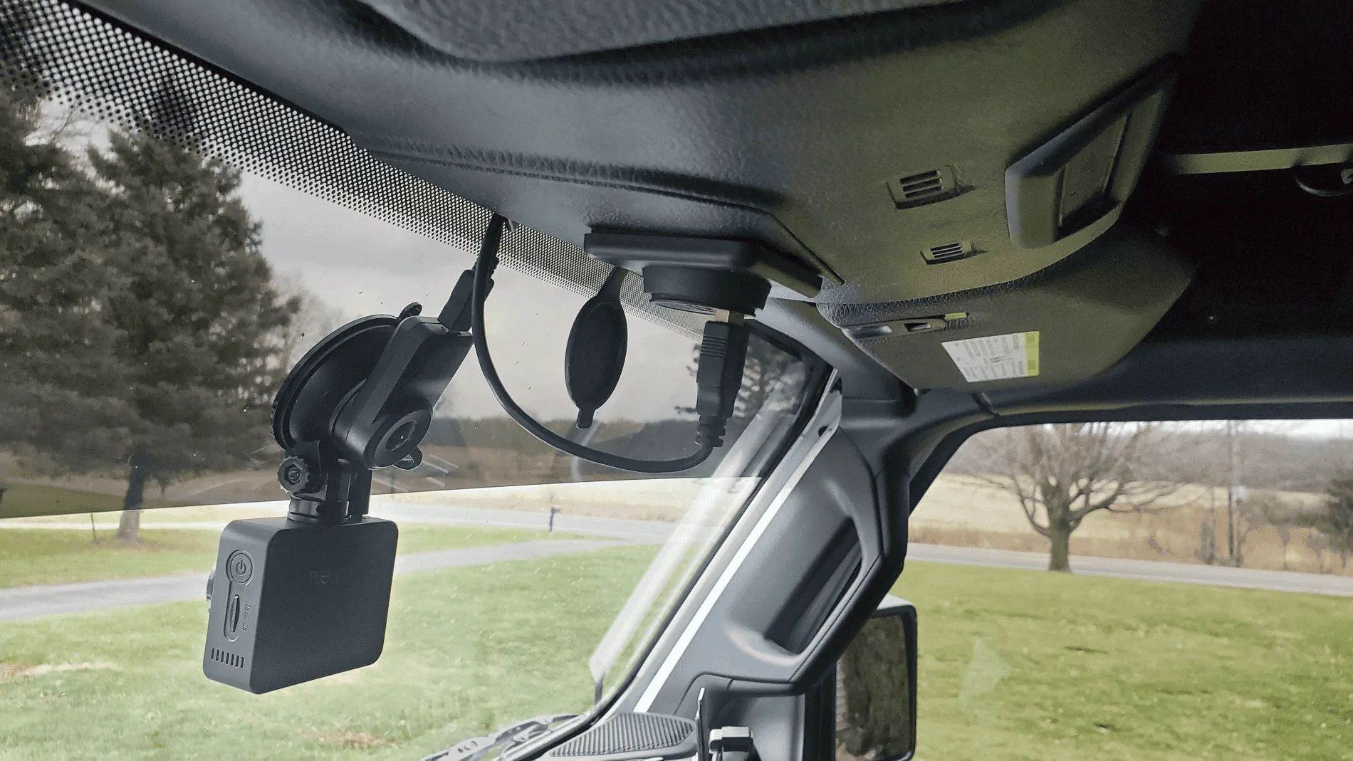

I have removed the rear view mirror and installed USB ports in its place. I use the USB to power a dash cam.

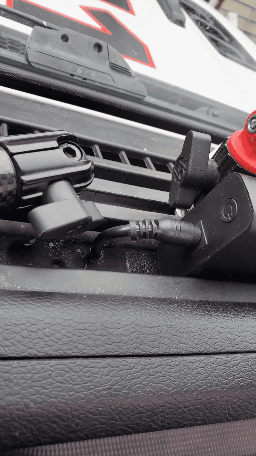

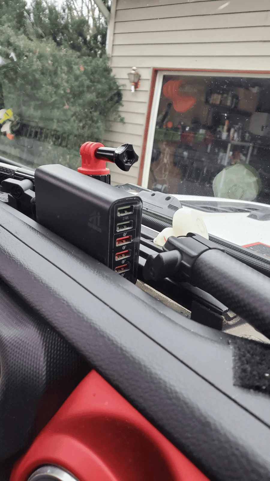

I could not see out of the mirror anyways with the big tire and Roto-Pax blocking the rear window. I also added a USB bank on the dash to power tablets, gopro cameras, and phones. The power bank has power to it all the time, but the power bank can be switched off.

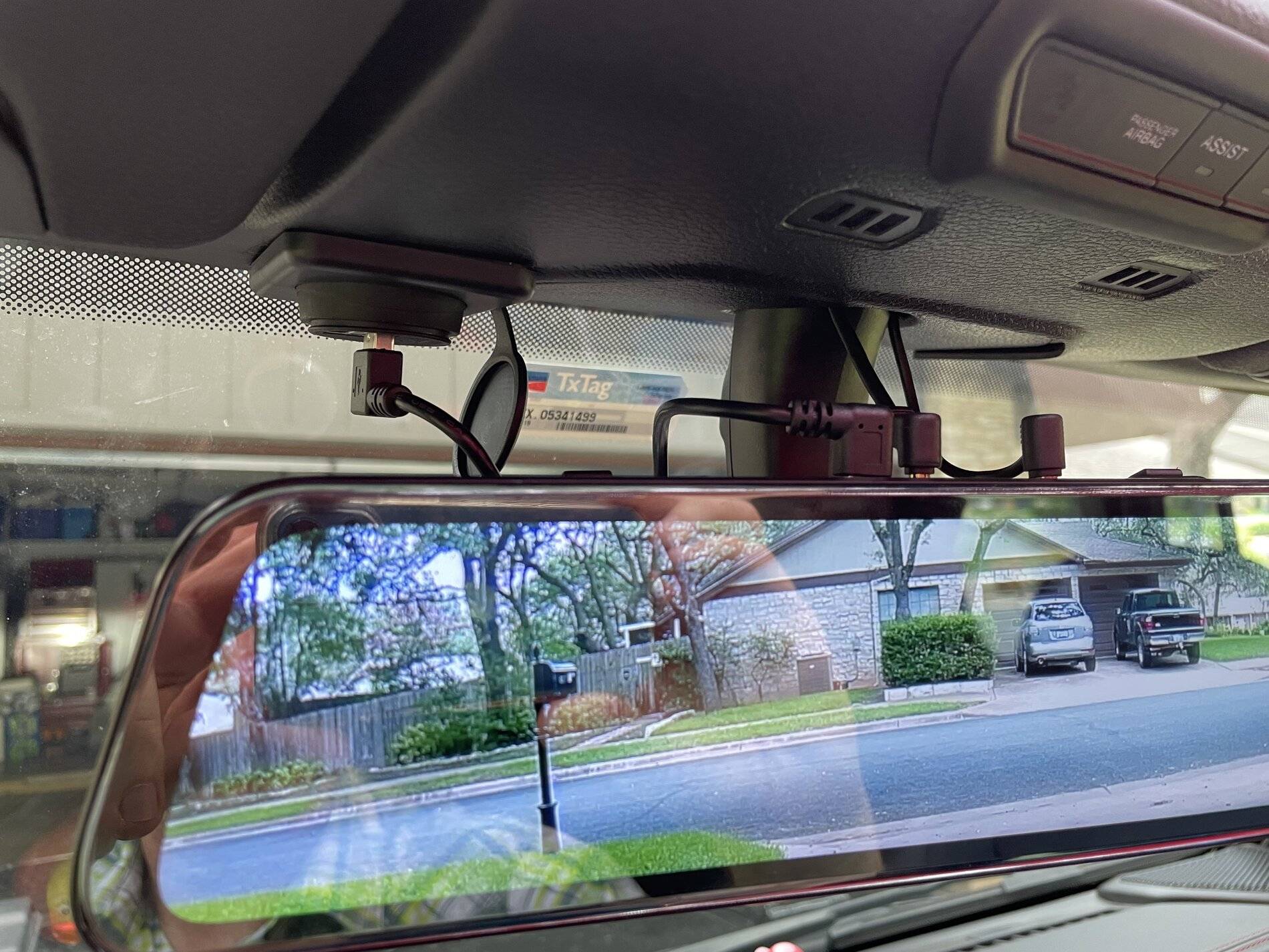

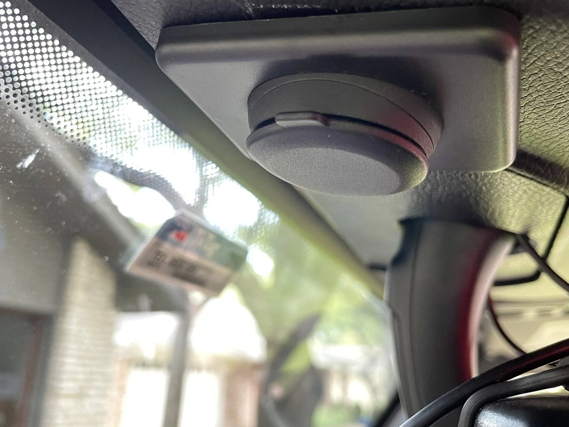

Thanks so much for this post. I was struggling with a clean option for my dashcam. This worked great. I just modified and used a low profile USB port mounted next to my mirror.
