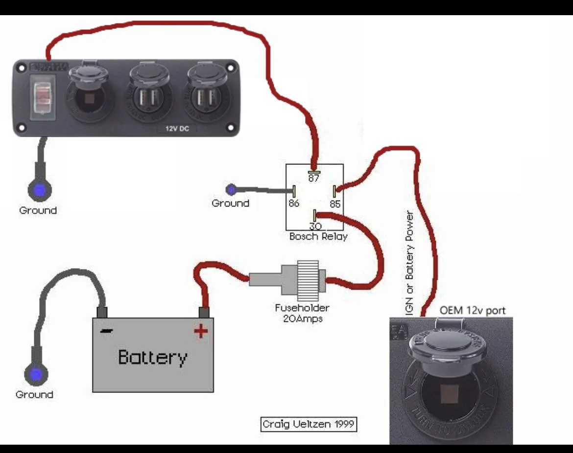

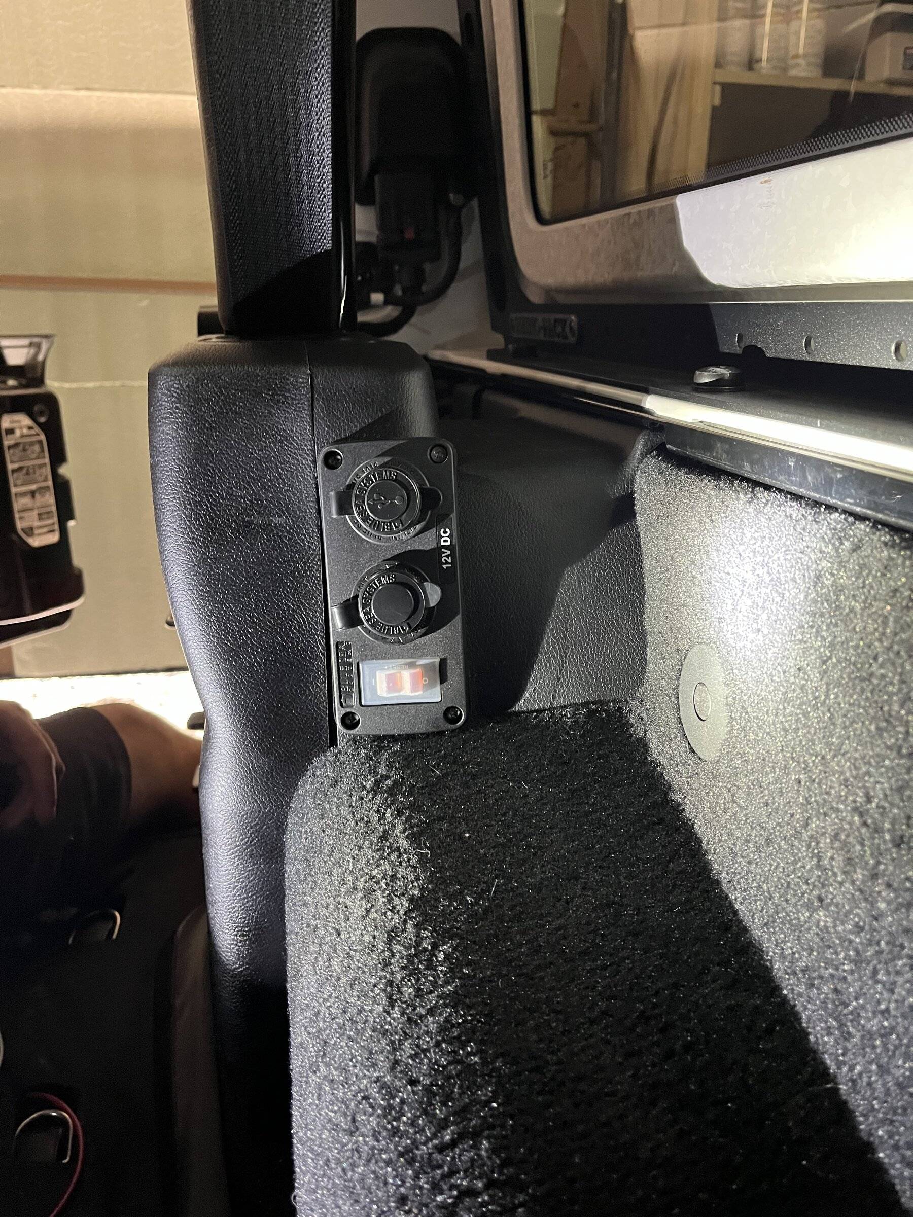

For anyone who comes across the post in the future just wanted to update. Here’s a picture of the finished product and a diagram of how I wired it up. Thanks JAF for the help and just noticed you’re from Pittsburgh as well. Always nice to see local people on the forums. We’ll have to wheel sometime.
Also can’t take all the credit, the diagram below is from Kevin on OverlandBounds forums. They helped me out a lot too.
