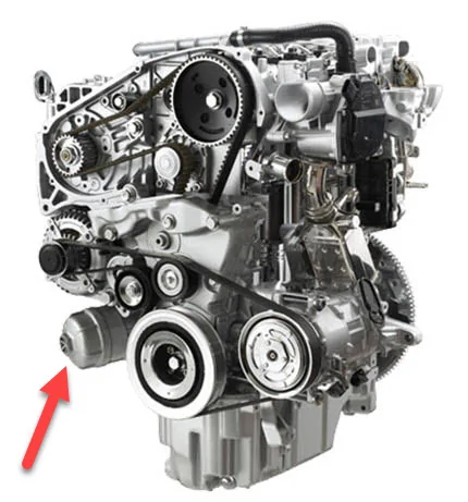

I wanted to change my oil and therefore also change the filter. Whereas on the V6 petrol there are videos and moreover it is very accessible.
On my Diesel I have some doubts ... I did find something underneath that should be the filter box, but with a VERY difficult access :devil:
Do you have any idea if it's the filter box underneath, on the right side of the engine and almost surrounded by ducts ?
Thanks for your advice.

I think that's what I saw ... it is, in my opinion, well on the right side of the engine and really not easy to access with tools. Not to mention getting all the oil on it...
Jeep Wrangler JL where is the oil filter ? Motor
https://www.jeep.fr/wrangler/performance-moteur
Can anyone confirm that's what this is?

I changed oil and filter for the first time today. The location of the filter is as per the previous post.
A 27mm spanner is required to fit the end of the filter housing. (I believe a 1 and 1/16 imperial will also do the trick.) There wasn't enough room to get a socket on the end of the filter cap. The spanner did the trick but access was tight so I had to keep reversing the spanner to take advantage of the head angle. Once the o-ring of the filter cap is clear of the housing, it is easy to turn by hand to remove.
One thing I did discover is a bleed nipple on the bottom of the filter housing. A 12mm spanner was able to undo this and using an 8mm plastic tube, I was able to drain the oil from the filter rather than have it run over everything below.
Oil and filter now changed. Not a quick process.
The o-ring for the sump bolt which is suggested to change is part number 46823518. This appears to be a Fiat part number.
