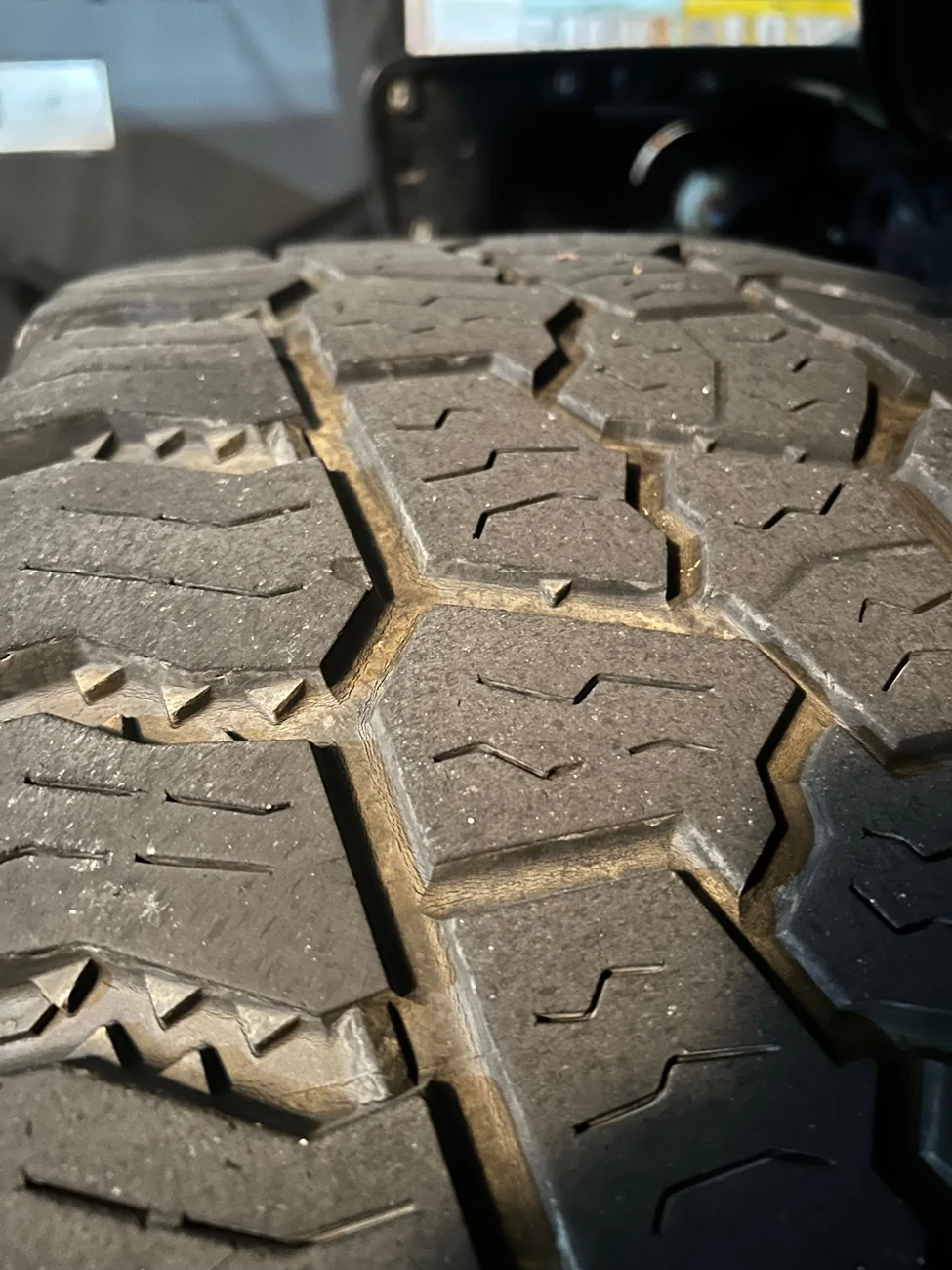

The code on most of them is 4721, so late 2021. They are all around 6-7 mm (8-9 32nds). No signs of dry rot. I assume at some point the effectiveness of them when off-road riding trails will be diminished, I’m just not sure what that point is.

Those are rich worn, I'd replace.

Ha I used to work in the tire industry. Rich worn is when people with money replace tires just because they feel like it is time. The tires could be 50% worn, but better safe than sorry. Which is funny, because as long as a tire doesn't have uneven wear, a worn tire will perform better in the dry than a new one.

depends on what you're wanting to do with them.
the tires in that pic would be fine for dry road, or perfect for slickrock.
i've had very good luck selling used tires on Craigslist and elsewhere when they were no longer suitable for my dirt use but would still be fine for someone to use on the street.
