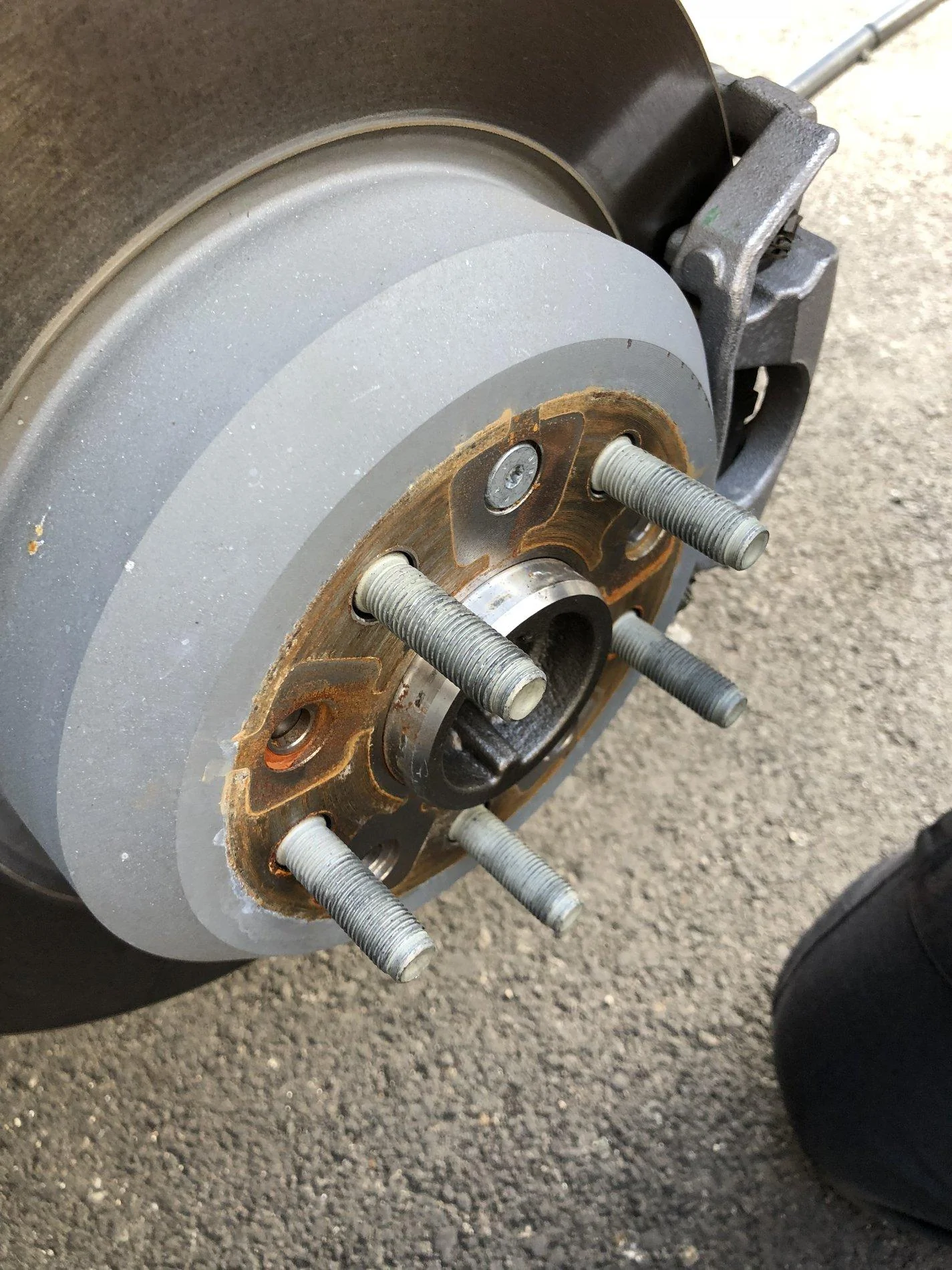

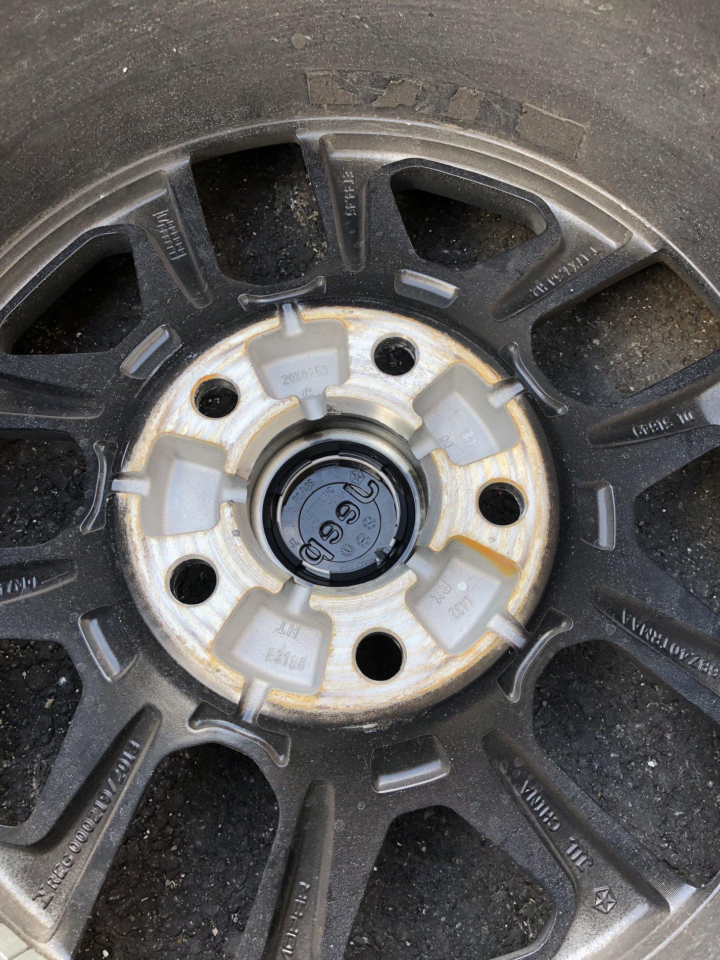

SPIDERTRAX has 1.75" spacers, great quality and I had them on my JK for 60k miles without issues. I didn't wanted 1.75" so I had custom made 1-3/8" and regret not goin just 1-1/8". Paid $270. Make sure you get machined billet aluminum. There are lots of horror stories about cheap China cast aluminum cracking. BORA is supposedly another good quality brand.
Wheel studs protrude about 1-3/8" but OEM wheels have pockets so if you keep stock wheels you should not have any issues going 1" or thicker.
Jeep Wrangler JL Wheels spacers on fully stock JLLUR IMG_0301
Jeep Wrangler JL Wheels spacers on fully stock JLLUR IMG_0302

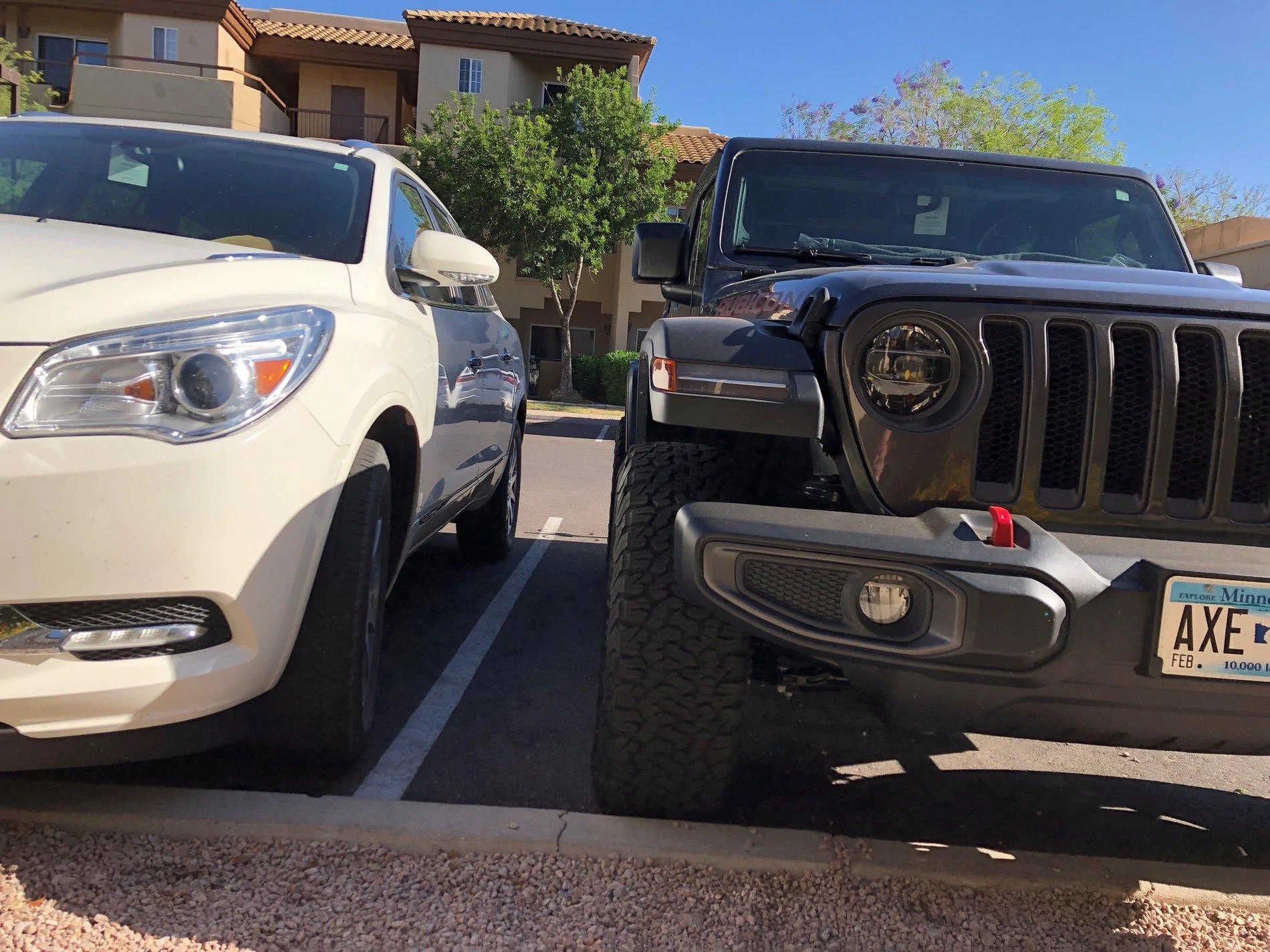

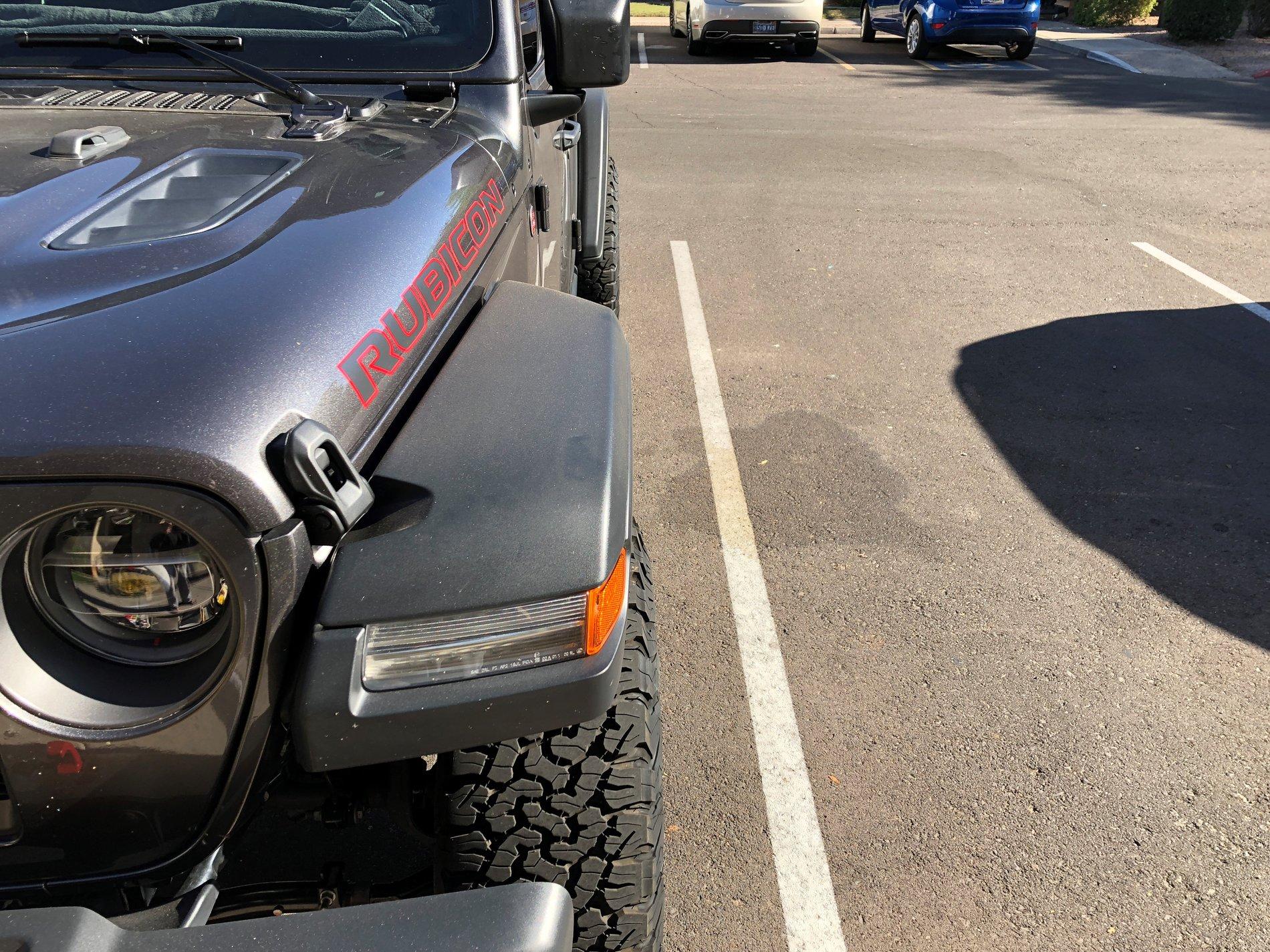

I currently have 1.5" spacers on my Rubicon. They sit just a tad out from the fender but that is the look I wanted. It saves me from having to get new rims for now. I have put almost 4,000 on the spacers I have. As mentioned above make sure you look at the machined billet ones versus cast. I think they are also going to be more well balanced as machined too. I haven't had any issues or vibrations. I just put about 2,500 miles on a big road trip and didn't notice a thing

Well you need to post some pictures dude!!

I will try to get a picture later today if I remember standing further back so you can see the over all stance. I am at a resort right now and feel stupid taking pictures lol.
Jeep Wrangler JL Wheels spacers on fully stock JLLUR Spacer_Left
Jeep Wrangler JL Wheels spacers on fully stock JLLUR Spacer_Right

No! If you look at the pics posted by Berkfan there are spots where the studs (at 1.5" you wont have extra length) if they do protrude will have the slot in teh wheel to go. It is essentially rotating the stud so the extra if any goes in to the hole and then you have new studs for the lug nuts to bolt to. One thing to note or that I do when doing spacers is put a little anti-seize on the back of them (very little) so that they dont get stuck to the rotor or hub from corrosion. Im in the midwest and had a car that I couldnt get the spacers off of after only one winter. Also, check the torque on the internal acorn lug nuts a few times. I used some locktite on those just to be safe. Then I got my tires rotated at the dealership and had them use their impact with hopefully the correct torque setting on all the lug nuts.
