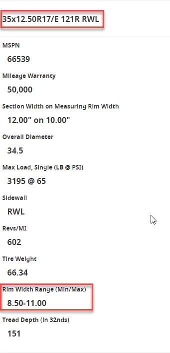

BFG site shows this.
Jeep Wrangler JL Wheel Spacers and Alignment bfgtires_mfg-png

Hi, I'm not trying to make it too complicated, but when you say "33s", that can mean any tire of different widths that have a ˜33" diameter.
For example 285/70R17 that will be within manufacturer's spec on a 7.5" wheel, which is exactly what the Rubicon JL uses. It can also be a 33x12.5R17 tire, that the manufacturer will specify 8.5"-10" wheels.
Same for a 35. There are 35x11.5R17s (narrower) and 35x12.5R17 (wider).
A 33x12.5, 35x12.5 or 37x12.5 tire on a 7.5" wide wheel is not ideal, but it is not doomsday either. It is a compromise that may use with decent performance and tire wear. Crowning and other wear issues can be mitigated with tire pressure and rotation.
If you bought wider wheels, you did the right thing. If you mounted on 7.5" wheels, you did an "ok" thing. Don't lose sleep over it.

I was just wondering. I read the BFG tire chart size and some on forum threads when I changed my Sahara Bridgestone Duelers out. They were 255/70/R18 I went with BFG 275/70/R18 33's for that was the biggest size recommend for my stock 17x7.5 wheels I wanted to keep.
That's why I bought new wheels for my New Rubicon for the bigger tires I wanted then.
Then I start seeing all these Jeepers putting 35/12.50/17 on stock 17x7.5 wheels and wondering why. But some say it's good and some say it's not good.
