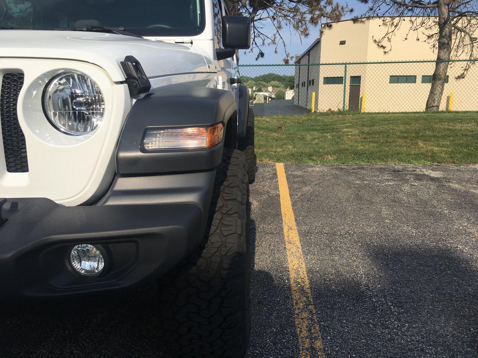

Same here. Check out the spidertrax spacers. 1.75” is not too much. Just right with stock wheels and 315/70’s, imo.
Here’s a pic before I removed the plastic fender pieces. But it’ll give you a good reference for the stance with the spacers.

@EMJeep, were the 1.75" spacers necessary for the stock wheels and your 315/70s or just for look? I'm looking at 315/70s(35"s), but keeping my stock Rubi wheels as well. I can't seem to find if the 17x7.5 wheels need the spacers or not.
It may not be necessary for your rubicon. Longer axles than my sport. I was rubbing on that plastic bumper piece that sports have. Added spacers, lost the rub. Then decided to take off the plastic pieces.
You would definitely be able to test drive that tire size before committing to the spacers.

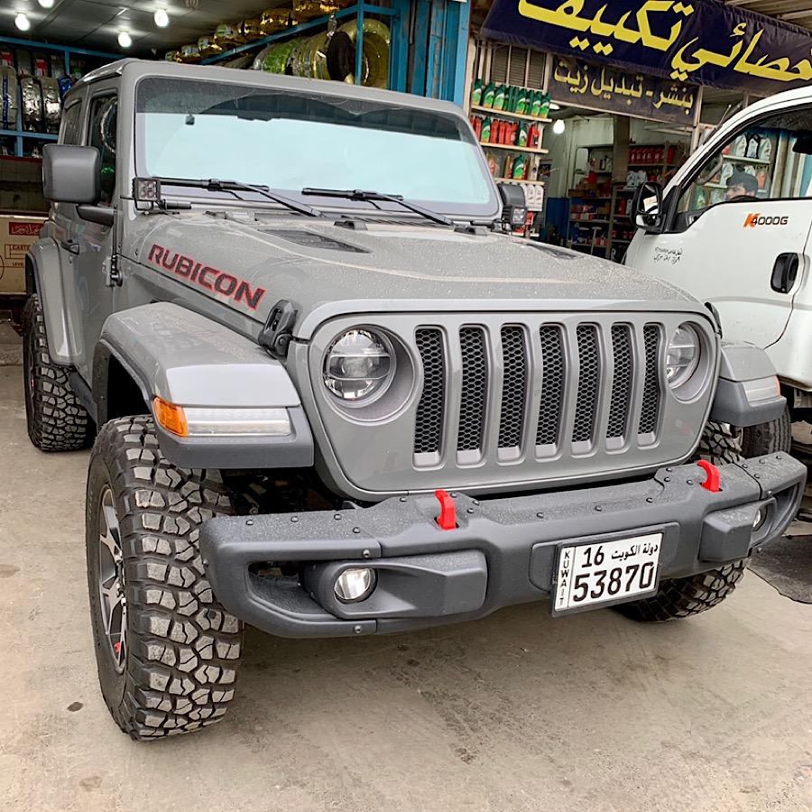

Had spacers on most vehicles I've owned
Not a single issue
G2 1.75"
