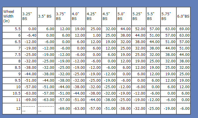

you convert the offset in mm to offset in inches. so -12mm/25.4= -.47"
then you add the -.47" to 1/2 of the wheel's "true width" (outer edge to outer edge which is always 1" wider than the stated width).
so on a 9" wheel, you add -.47"+5"= 4.53" aka -12mm offset on a 9" wheel is 4.53" backspacing
if we have an 8.5" wheel with -12mm offset...
-12/25.4= -.47" (same offset in inches)
then you add the -.47" to the 1/2 of the wheel's "true width" which is 4.75" (8.5+1 then divided by 2).
so on an 8.5" wheel, you add -.47"+4.75"= 4.28" aka -12mm offset on an 8.5" wheel is 4.28" backspacing (sticks out more)
**less backspacing means more "front spacing" which means more deep dish ala sticking out more.
to convert from backspacing to offset, just do the opposite of above
4.28"-4.75"= -47" offset in inches. then convert that to mm -47*25.4= -11.938mm (slightly under due to rounding)
**however "wide" your wheels are, they are always 1" wider in their true width. this is because the industry counts the width of the wheel between the tire bead flanges. the flanges are 99% of the time, .5" wide on each side, ie an extra 1" overall. so when measuring backspacing and offset that of course comes in to play as it affects the numbers. your number is will be way off if you do the calculations using the standard width of the wheel. of course, online calculators do this for you so you just put in the stated width of the wheel. next time you have a rim with the tire off measure it from outer edge to outer edge and you will see what i mean. we had a customer order 9" wheels once. he received them and i guess measured them for the heck of it. he started freaking out called me all upset that he wanted 9" wheels and we sent him 10"!!! he was measuring the wheel from the outer edge to outer edge, ie 10". he checked while we were on the phone and said "oh. it's 9"

no, not really. no offense. you either found a page with the wrong info or you possibly interpreted it wrong. ive been in the wheel business since the TJ days. spent quite a bit of time in the wheel hall at sema. everyone uses the same calculations. its basic math. its not like the tire industry where they measure the width of a tire from different locations on the tire. its standard for wheels.
measuring backspacing is super easy. to measure the backspacing of a wheel, you lay it face down on the ground, lay a straight edge over the back of the wheel (preferably sans tire) then measure straight down to the mounting pad surface. that's your backspacing. that is always correct, when you measure it yourself.

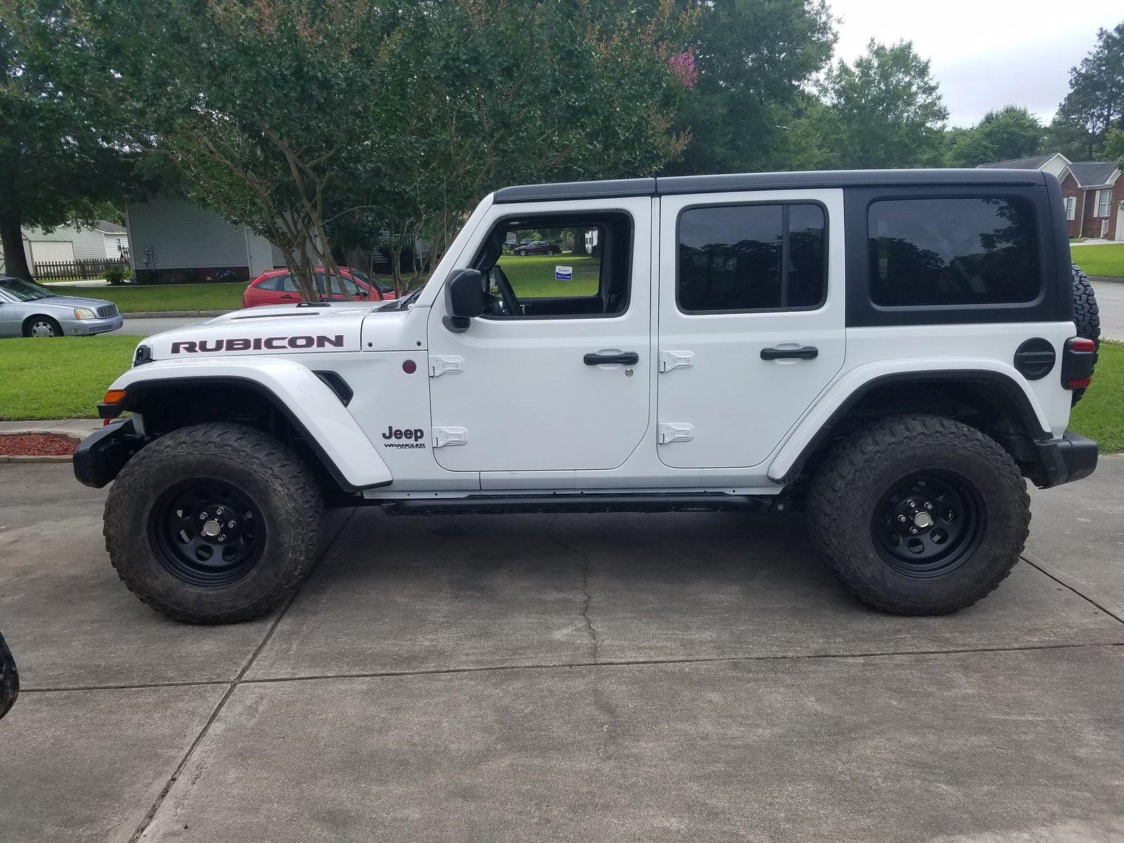

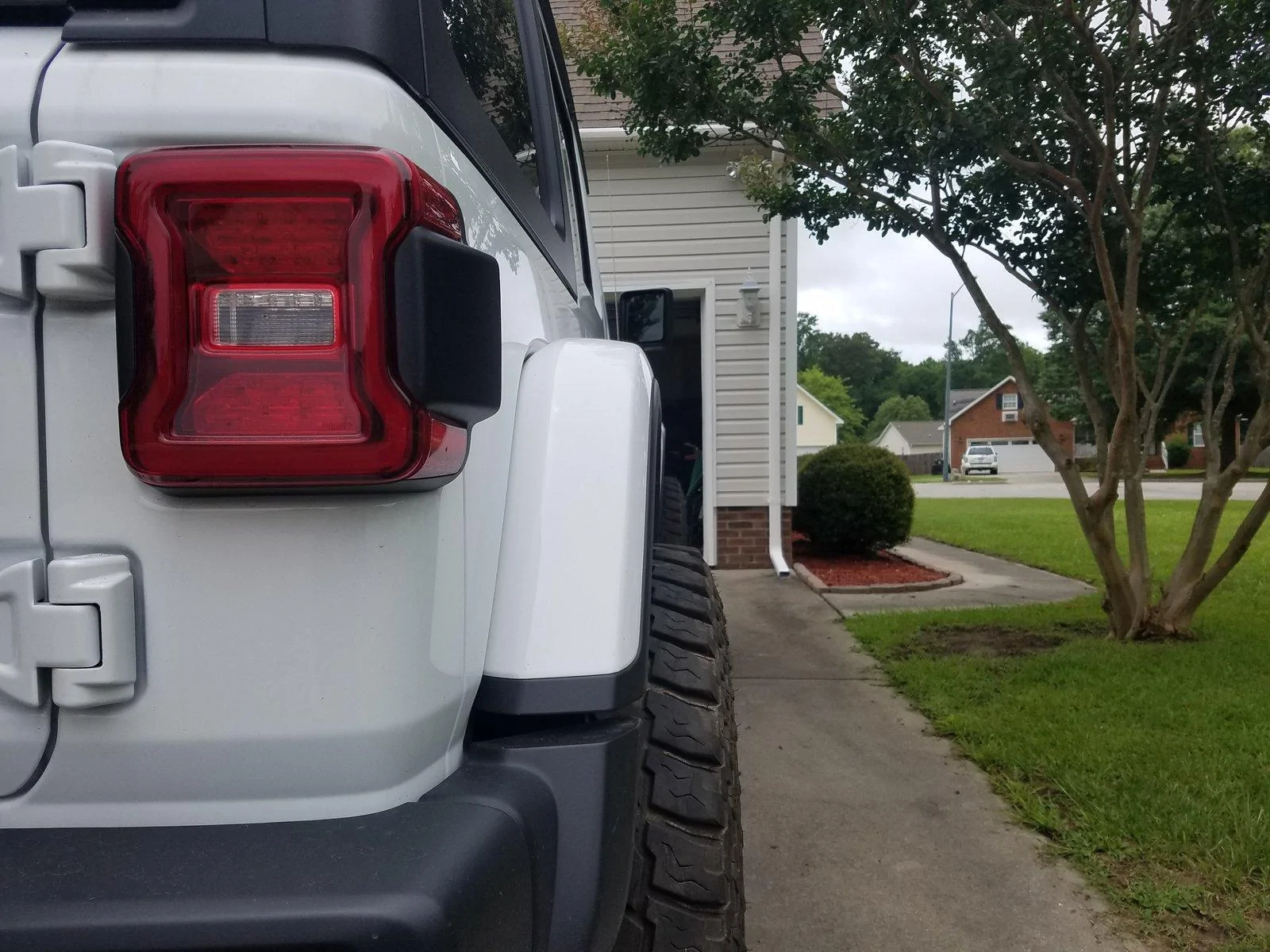

Sahara and Rubicon offset is the same, just diameter is different. My new rims are 17"x9 with -12mm offset. Here is what the 34" ridge grapplers look like on mine. Check out this thread, lots of pictures from a few different people that have gone this route. There are a few other threads as well and a few with 37", they seem to look good as well.

Jeez, those look HUGE for 34s! Is there some flexing going on in the rear tire in that side shot that makes them look like they fill up the wheel well more, especially with the lift? The front looks more like I'd expect. I have a JLUS with 1.5" leveler on the front and am debating between 285/70/17 and 285/75/17. I like the fuller wheel well look, but don't want to rub. I don't plan on rock-crawling, but would like to take it on trails.

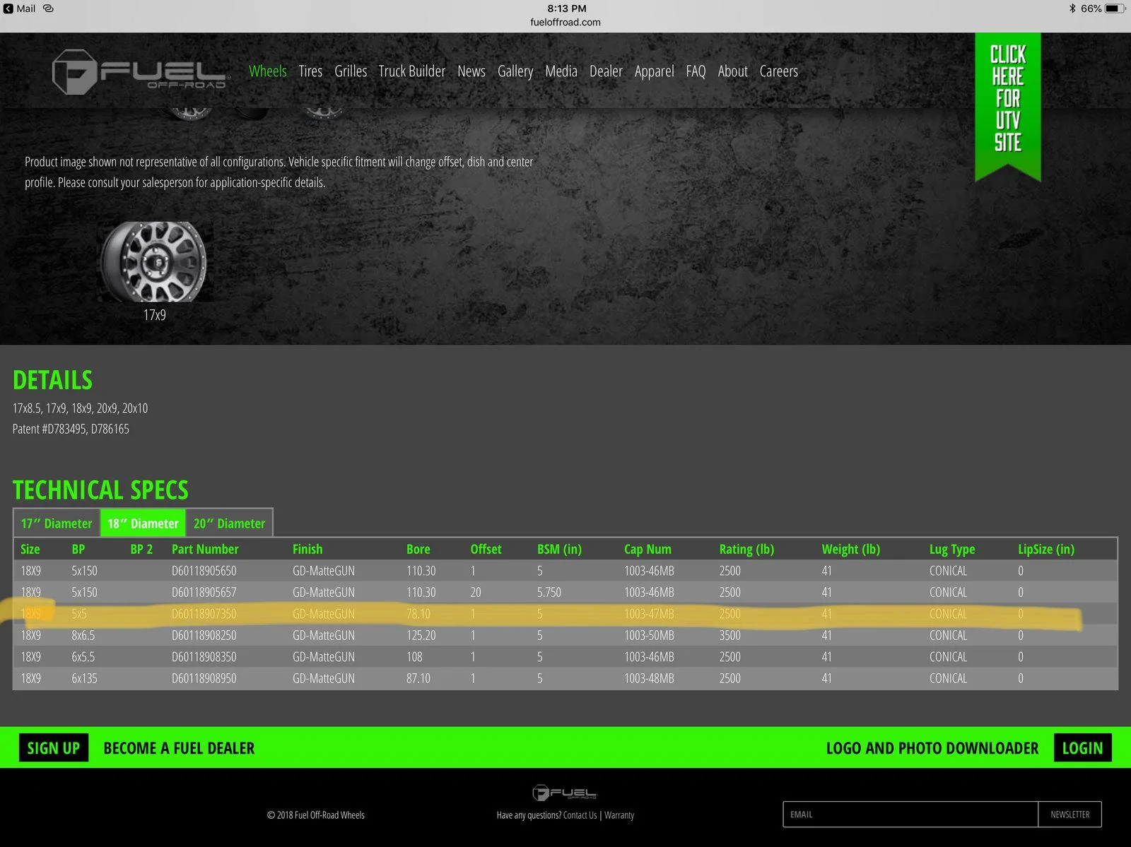

I really don’t get this whole wheel thing. Can someone tell me if these will work on a jlu Rubicon? I don’t want the tires to stick out much? Putting toyo at2 35” tires on the 18” rims.
That wheel will protrude 2.34” more than stock rubicon wheels.
