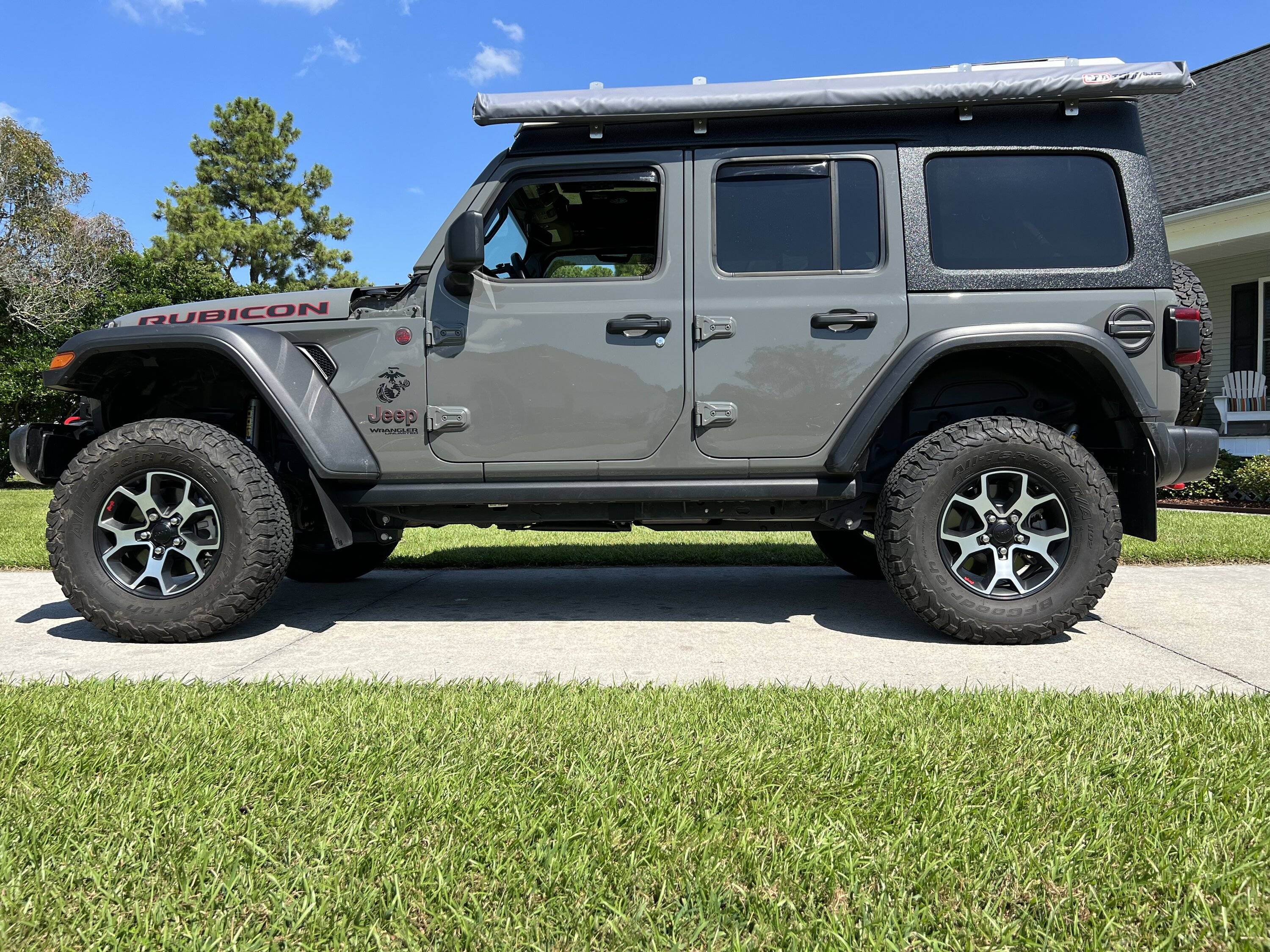

2021 JLUR. Bought new. Now 27,000 miles. Manual trans. Ursa Minor camper top. 2.5" AEV lift. Long range America aux fuel tank. Stock 33" KO2. Tire rotation every 5000 miles. Front end alignment after lift installed. Tires normally inflated to 35-36 for pavement.
Jeep Wrangler JL What's Causing Tire Cupping IMG_0013
Felt shimmy yesterday above 60mph on interstate. We have no interstate at home. Stop at discount tire in TN for rebalance. Nice folks. Helpful. But they found tire cupping. I felt it with my hand. All the tires.
We discussed what it could be. No real idea. We had alignment when I installed the lift. Tires rotated very 5000 miles. AEV dual sport lift had correcting geometry. Good components. Reputable.
Thoughts on why tire cupping?
Looking for some insight.
Continuing on to NM, Colorado, Utah. Maybe I'll see ya out there.

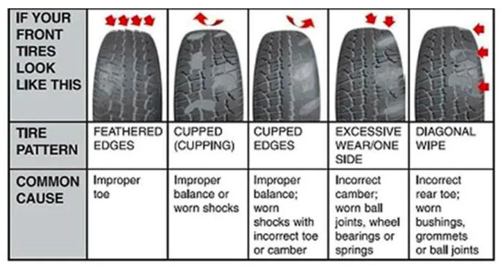

typically bad camber angle, bad shocks, bad ball joints. you can chalk test your tires and see how flat they're running. If its a good solid pattern then start doing ball joint testing and check camber angle

The instigator is often a tire out of balance and in days gone by tires that are out of round. Also failing suspension components.
Shocks Failed or failing
The shock is to the tires and suspension the same that a Steering Stabilizer is to Death Wobble. In other words the shocks job is to mitigate the vertical loads and inputs. This makes it critical that the tires are balanced because that is the origin of erratic input and if the shock cannot mitigate it then the result is cupping.
A weak shock and or an out of balance tire will cause a tire to 'bounce' as it goes down the road and every bounce take a bit of tread off until what time you get cupping.
