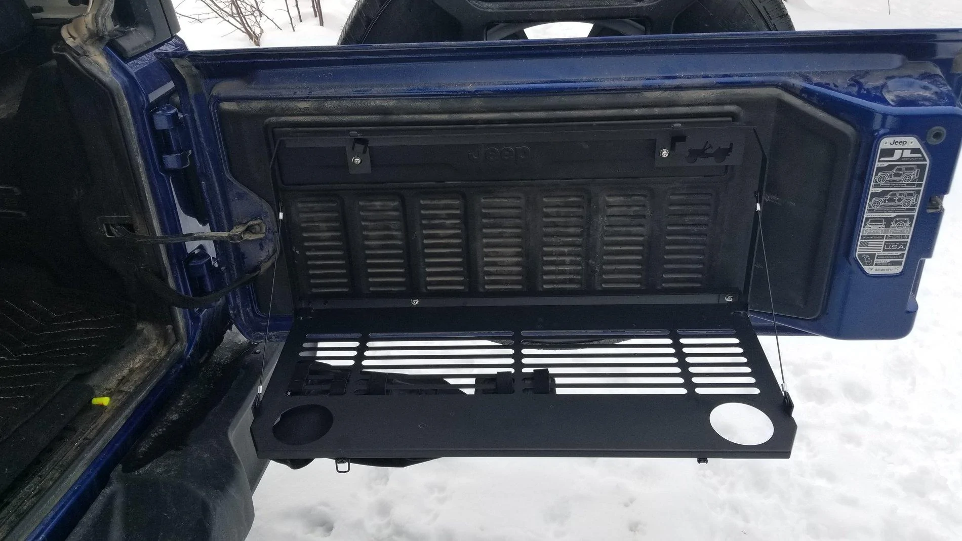

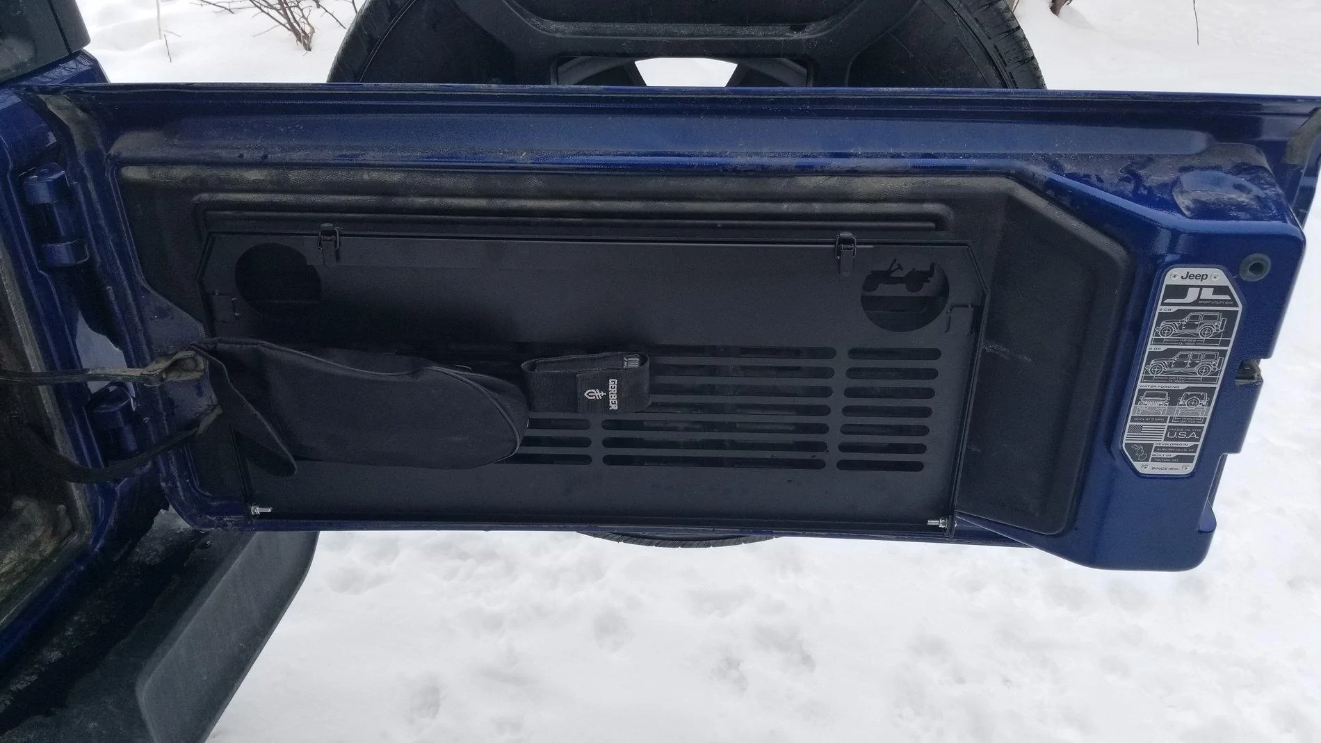

Finally had a chance to put mine on. As expected I used 2 washers to space out the bottom left and as expected it rubbed on the top right when stowed. I was able to loosen all the mounting bolts, push the top of the frame as far right as possible, tightened the top two bolts, pushed the bottom of the frame as far left as possible and tightened the bolts. It ligns up perfectly now. I grabbed a pair of water pump pliers and smashed the cable crimps and they are tight now. It doesn't rattle it is pretty sturdy and the install took under an hour including the tweaks, taking pics and drinking a beer. If you're not worried about it not saying mopar and doing a little extra on the install I would definitely recommend buying one of these and putting the money saved somewhere else.
