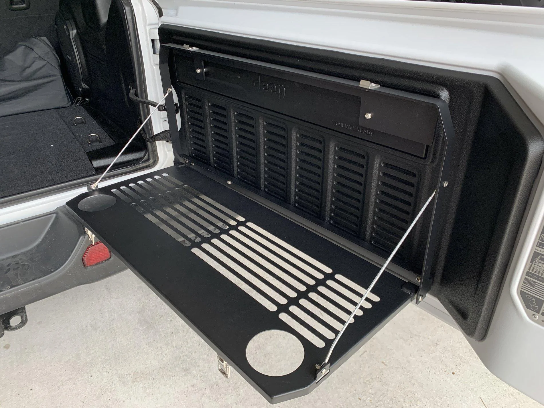

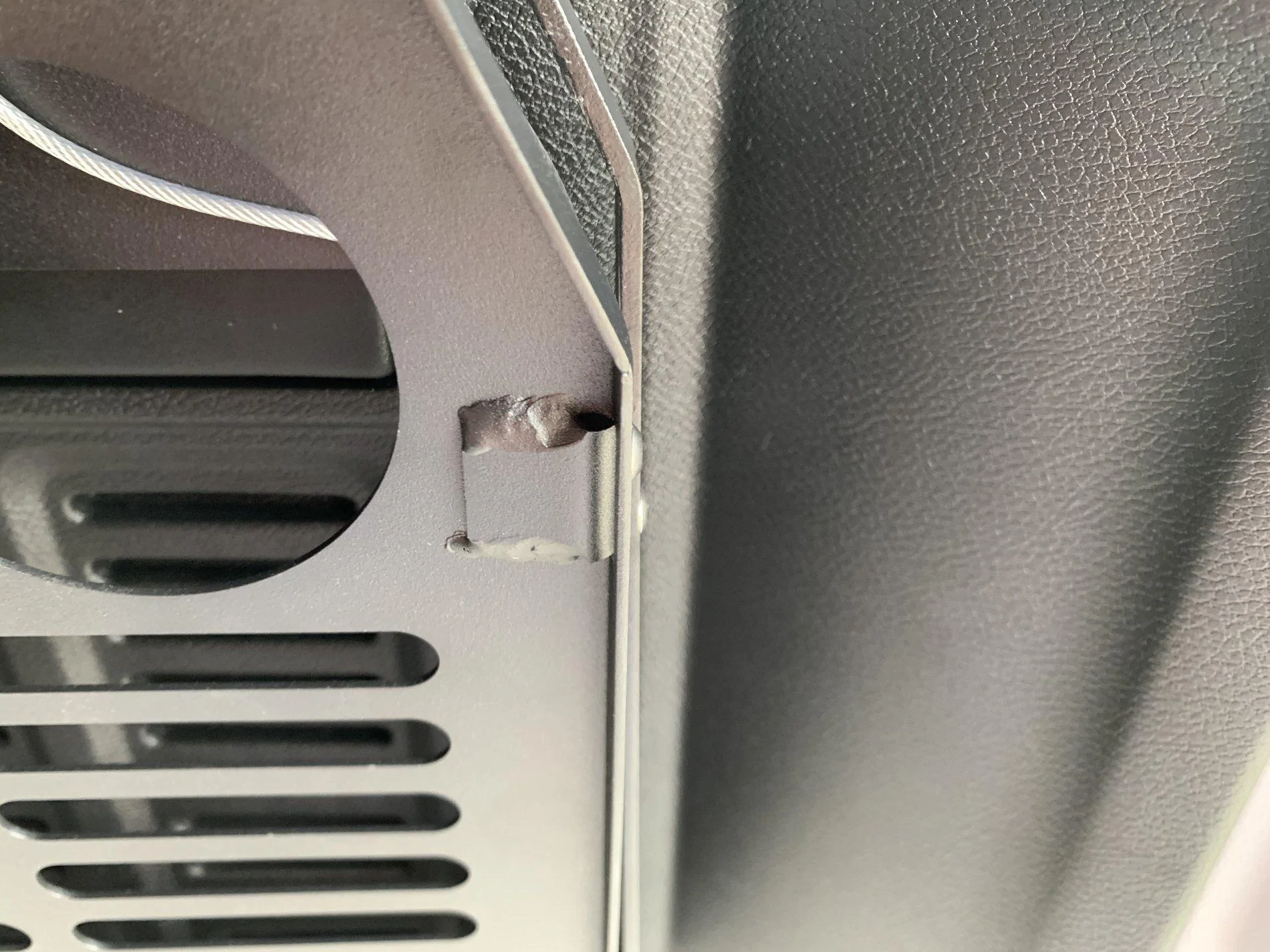

UPS
The cutting board does slide out for cleaning. There is a thumb screw that keeps it from sliding all the way out. Just remove the screw to take it out.

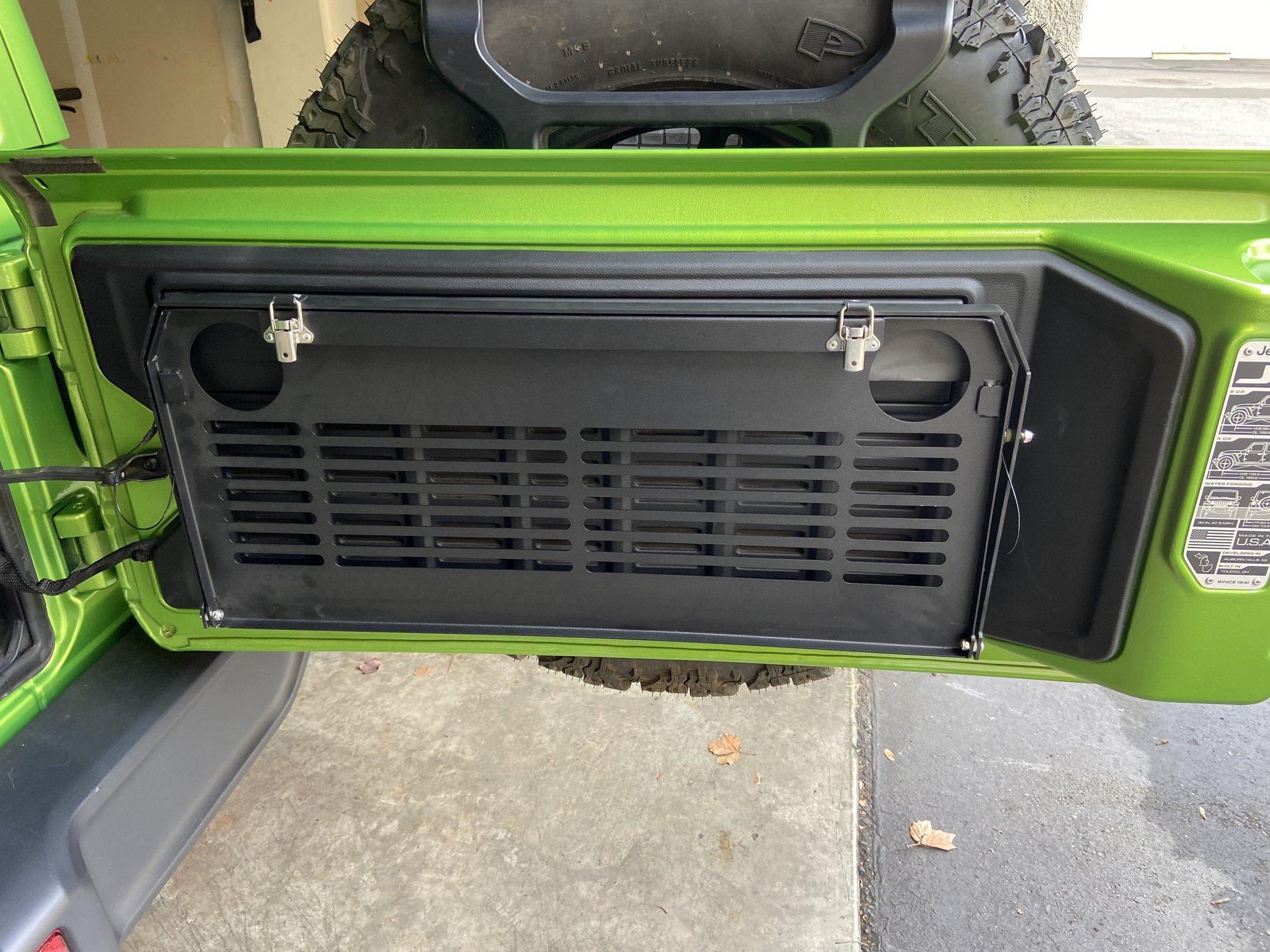

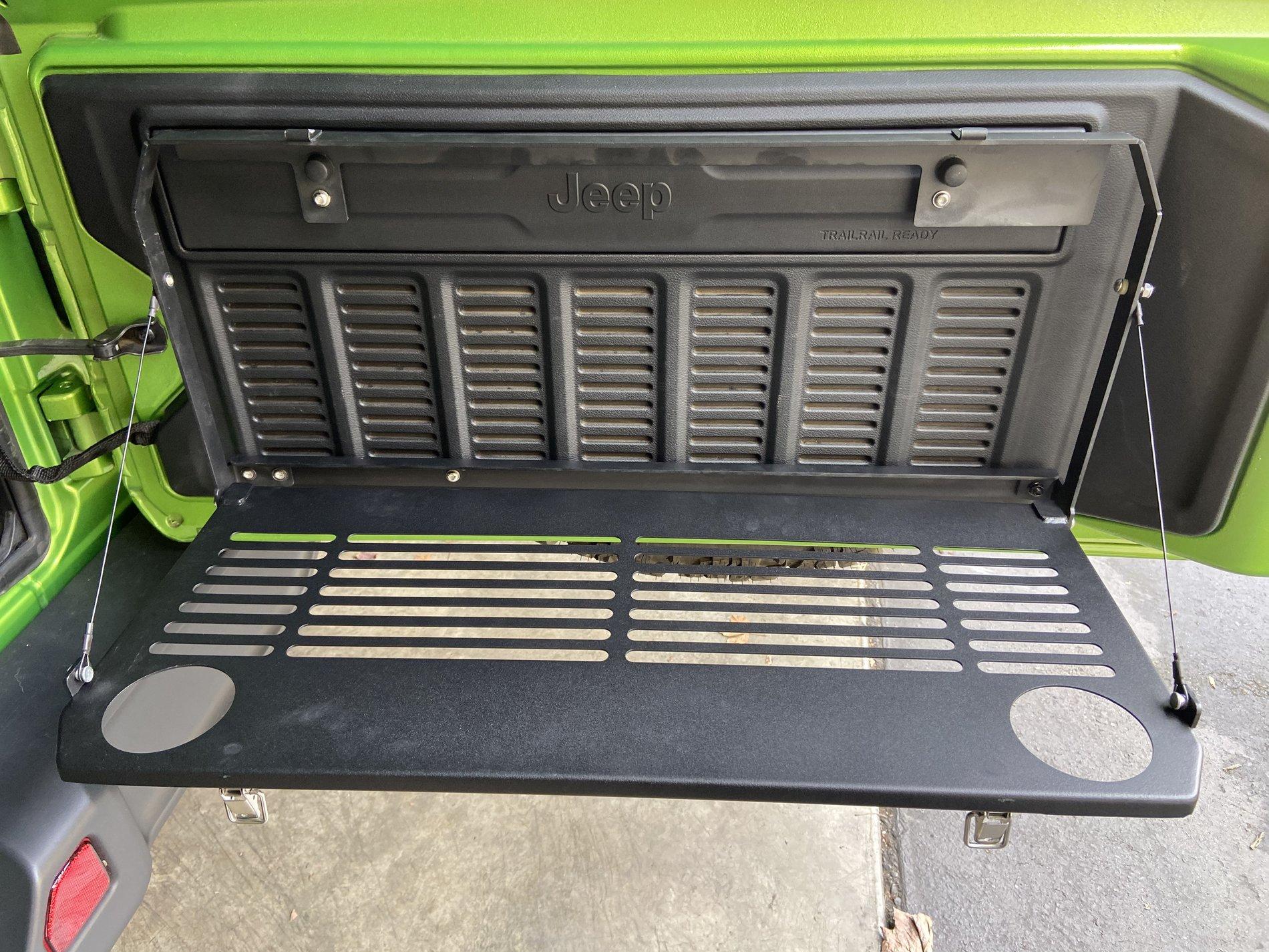

Installed this one a few days ago. It was a Christmas present, but I think it is one of the $60 ones on Amazon. I followed the Mopar instructions for the most part. Pretty straightforward. The right upright rubs a bit against the table when it’s stowed, but otherwise works great. I just tweaked it a bit with a wrench and then will paint it a tad.

I have to say for $60 it’s not bad. It seems solid, all the parts were there. One of the spacers should be longer which they didn’t provide but did provide some washers to stack. It’s hidden and worked so all good with me.
Installed mine yesterday and had this exact same rubbing problem in the upper right corner. Used a pry bar to slightly bend out the upper right frame. Sits perfect now.
Awesome! I couldn’t find my pry bar so I used a pair of channelocks with fabric wrapped around the jaws. It still marred it a little but nothing a sticker can’t fix.
