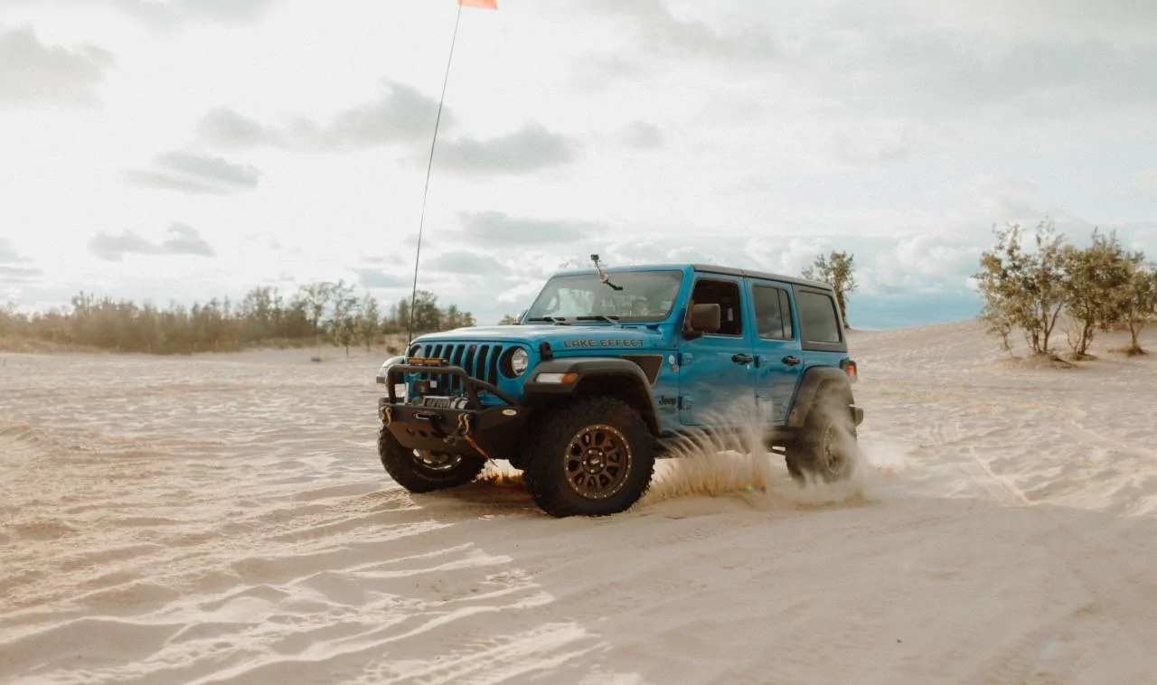

I have a JLU with a steel bumper and a winch. Currently coming from a Zone spacer lift with nitro shocks. I'll be picking up the Mopar 2" lift kit without the shocks. I'm deciding between the FOX 2.0 Adventure shock and the Rancho RS7MT shocks. A majority of the driving is on road with some mild off road in the summer months. We frequent some sand dunes and hit mild trails with some rock obstacles. I use to have a JKU with 5100 and liked them but these nitro shocks on my JLU are not my favorite.
Now the Ranchos are only $79 a shock which is very attractive. I can get the FOX 2.0 for $130 a piece, and the Bilsteins are usually in between. The Ranchos seem too good to be true. I view them as a value brand but they do have a great warranty. I personally wanted the FOX shocks for some time but purely because I "think" of them as more of a premium brand.
Is FOX what I make it out to be? Is it worth the cost difference between the Ranchos? Or should I shut up and buy the reliable Bilsteins?
