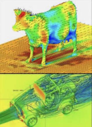

I had a career in aviation. Whenever I see a vehicle (plane, car, truck, etc,) with high drag, I see big opportunity for reducing drag.
If you take a plane like the 787 Dreamliner, there is very little opportunity for aerodynamic improvements.
I owned an aerobatic biplane that had tremendous drag in comparison. There were many easy things I did that greatly improved aerodynamics. I increased the top speed of that plane by double digits and reduced cruise fuel consumption significantly.
With a Jeep, it likewise has a lot of low hanging fruit. A lot more than a new modern sedan or sportscar. Also, with a vehicle that gets low fuel economy, driving the same miles per year, an X% gain in fuel economy equates to more $$ per year than for the high efficiency car.
In other words, higher drag vehicles have higher gains in $$ for drag reducing efforts.;
Also true. This is why a cow is more aerodynamic than a Jeep.
