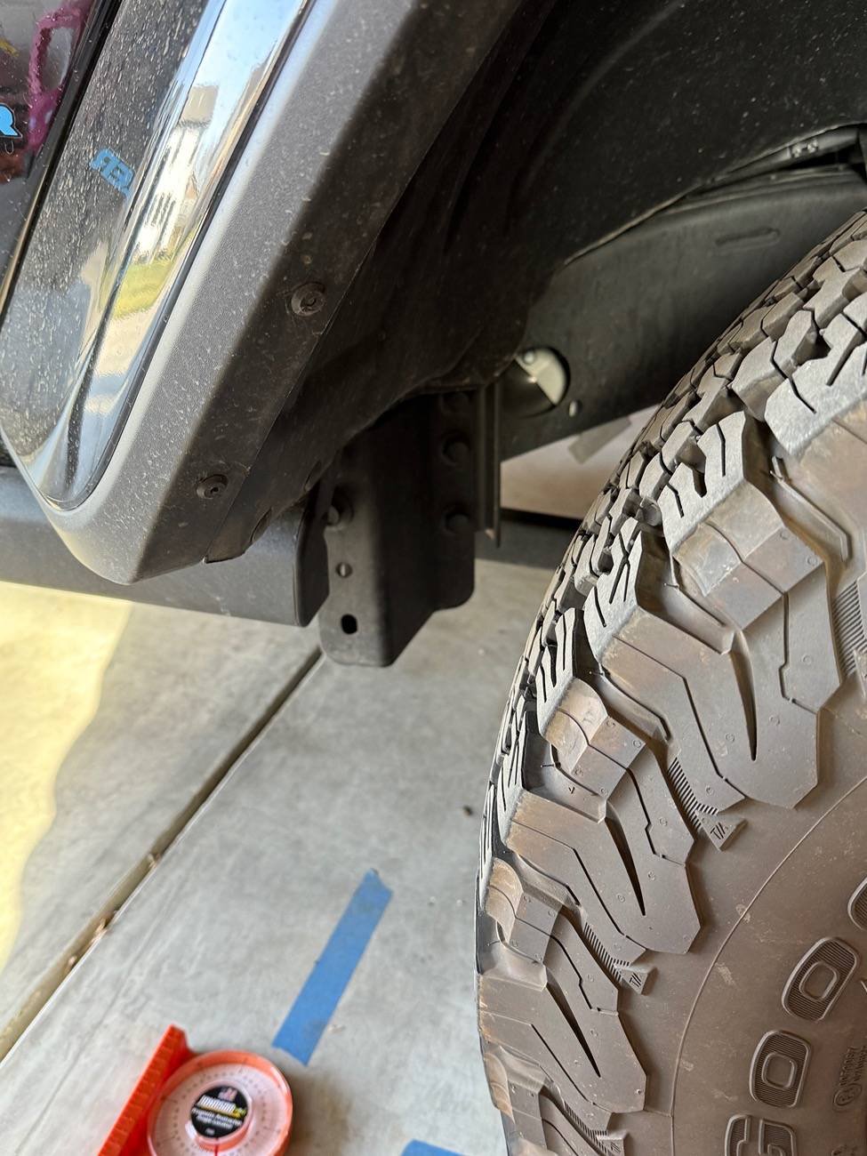

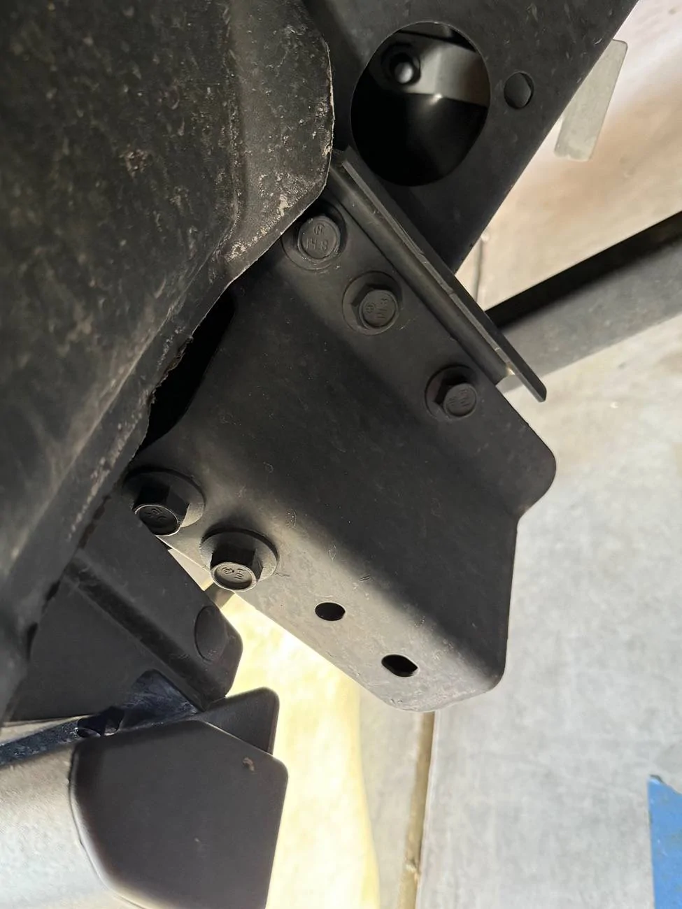

Noticed this piece attached to the frame of my rubicon 4xe at the passenger side wheel well. I do not have this on my JK and cannot figure out what this is. It’s a pretty big piece of metal. thanks.

Crash bar for some safety regulation. There are other posts here if you search it. Most people remove it when installing tires large enough to interfere.
C.Sco
Mar 19, 2023
1,264
2,698
2023 4xe Rubicon
Anti-rollover bracket.
The idea is that if you get into an offset passenger side corner collision, the tire will smash into that bracket and stop, rather than going all the way under the body, theoretically helping prevent a rollover. Wrangler massively failed the offset passenger-side front end collision crash test, rolling the vehicle in spectacular fashion (there's video of it on youtube somewhere), and after that this bracket was Jeep's solution to prevent rollover in that very specific circumstance during that one specific crash test.
Oddly, the Wrangler has the exact same rollover problem in the driver-side offset collision test, but they didn't put this bracket on the driver side at all, just the passenger side. Not sure why.
If you have non-OEM tires, lift, or wheel offsets, then the geometry is different and the bracket is now probably doing more harm than good.
Removing it is kind of a pain, because some of the bolts are installed before the body is lowered onto the frame at the factory, so it's impossible to get them back out without cutting the bolts. Back the bolts out as far as you can until they hit the body, then use a sawzall or other metal-cutting saw to cut the bolt in half, and then finish backing it out the rest of the way with vice-grips.
You'll still have a small second bracket welded to the frame, but I found that part doesn't really pose a clearance issue offroad so I just left it, you could angle grind it off if you really wanted to.
