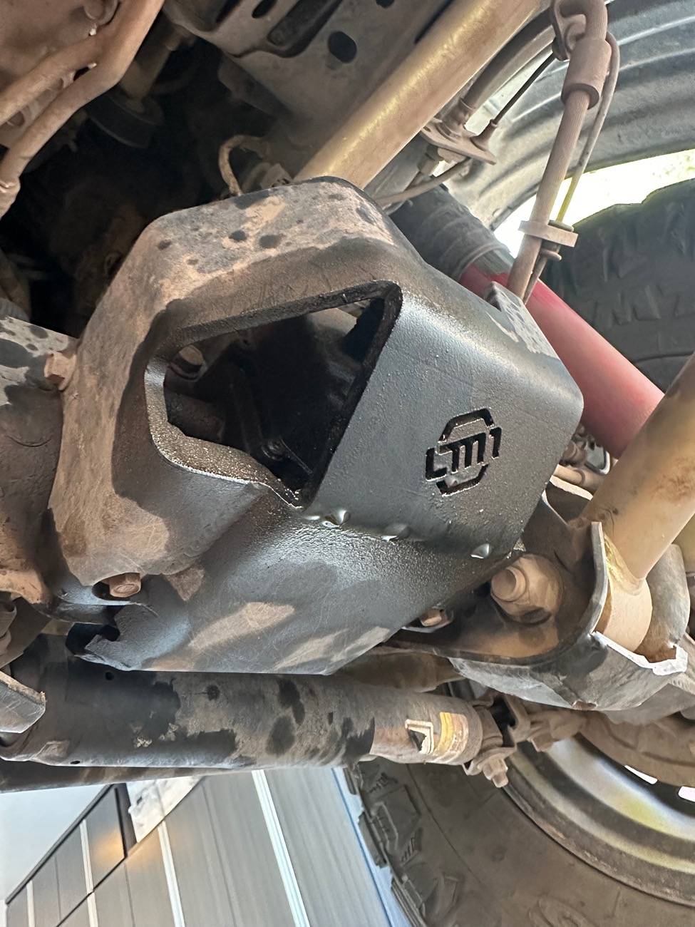

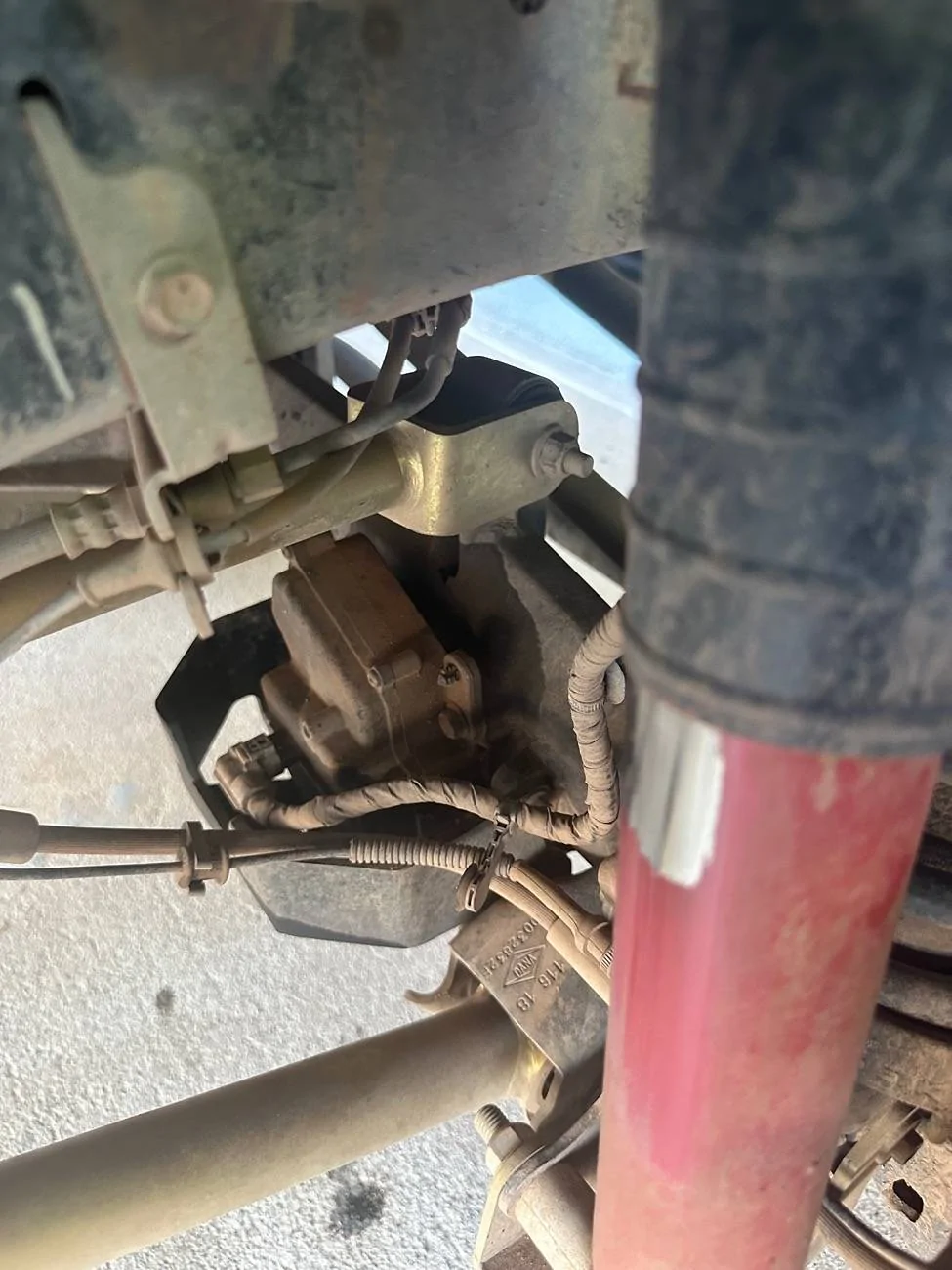

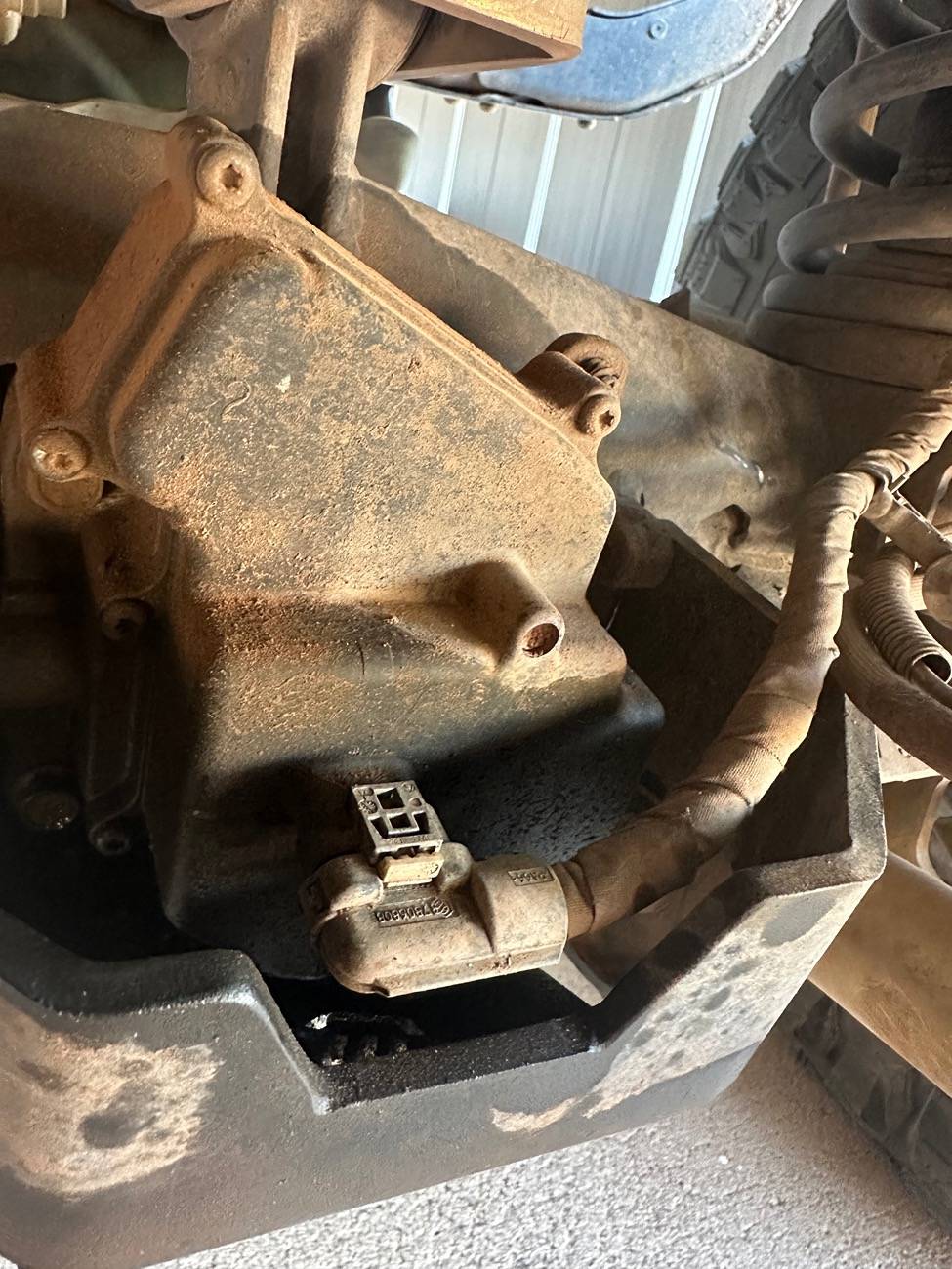

Hi all - this is leaking and it looks like a power steering component but I can’t find it on a diagram. What is it and cost to repair?

Front axle disconnect, you might be able to get away with just replacing the gasket
FAD gasket is part # 68391562AA... It'll run you less than $20. Easy to change.
