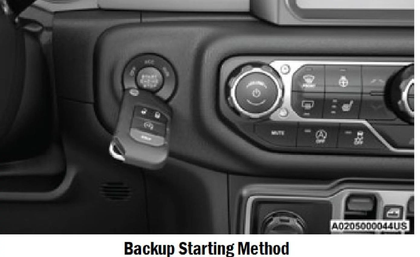

There is a RFID chip in the nose of the key fob. You can start the vehicle with a dead key fob battery. Press the START/STOP ignition button with the nose of the key fob. Or hold the nose of the key fob very close to the START/STOP ignition button and push the button with your finger.

:) :) The point is a car not starting (65k car) cause a keyfob is cold is ridiculous regardless of whether it's the battery or the fob. How many of us ever had a car not start cause the "key" was cold?
In terms of readings a manual you shouldn't need a manual to figure out how to start your car in the cold. Yes, i knew to press the key against the button and guess what it took 5 times of pressing the button with a key to finally get it to start.

You need to have your foot pressing firmly down on the brake pedal ....when you press the end of the fob with the RFID chip, on the start button firmly and depressing the start button fully down. Do this and the JL will start on the first attempt, not after "5 times of pressing the button with a key to finally get it to start."
