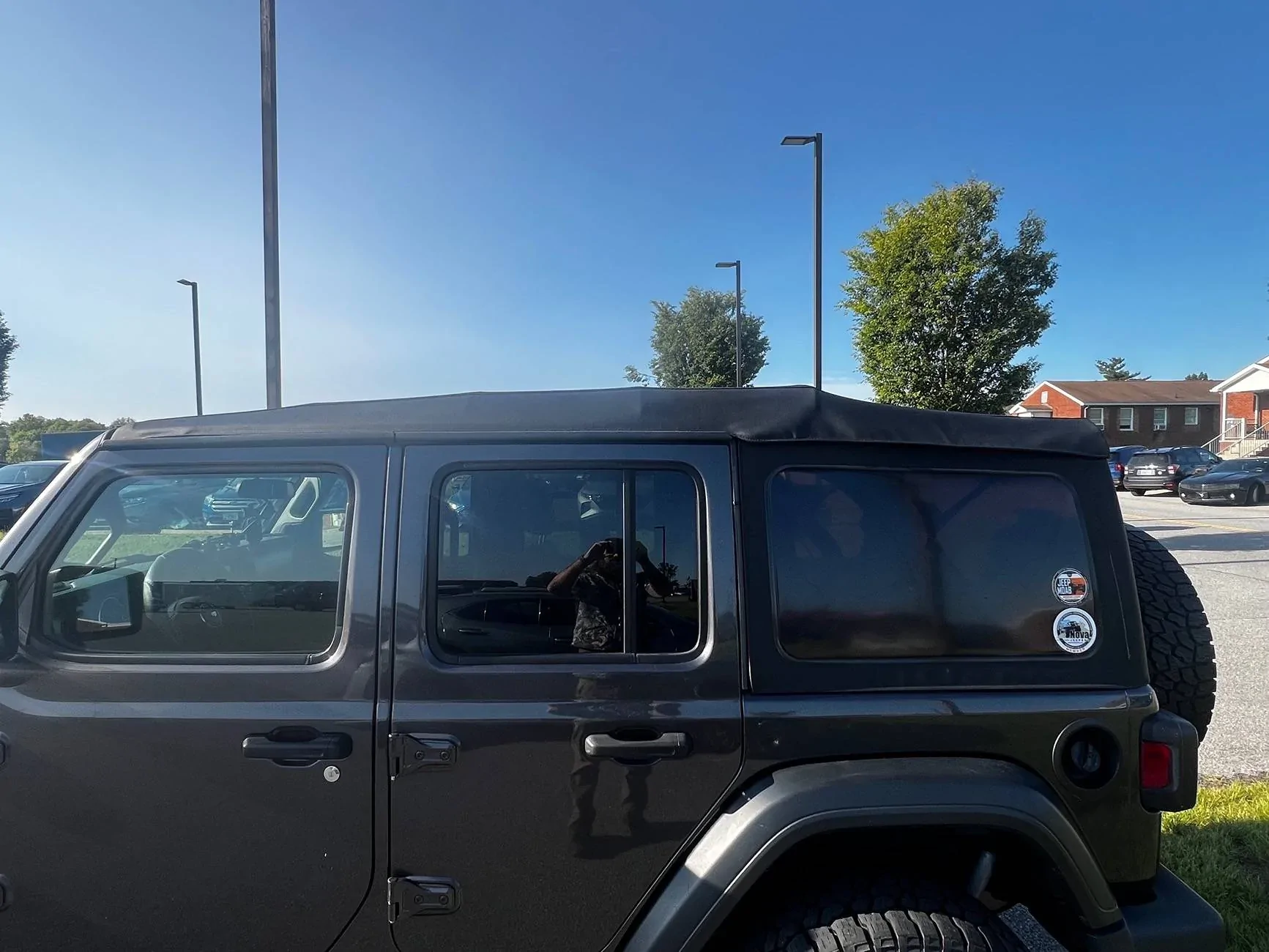

I installed my soft top for the first time, and ended up with wet carpet on rear floor, driver's side. I never had this problem with my LJ's soft top.

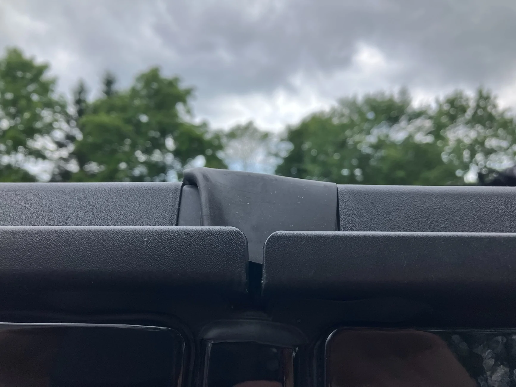

I double checked the instructions, and I don't see anything obviously wrong. This picture (found on this forum) shows the edges of the soft top inside the drip edge. Is this the best way?
That is correct. 👍
As for the leak, when you installed the soft top, did that include attaching the soft top-specific door surrounds? If so, you'll want to double-check to make sure they're correctly secured and seated. Doing so is as easy as flipping the top back into Sunrider mode to expose the relevant pieces. Have a look at all of the door moldings to ensure they're intact, also.

Thanks. I did install the door surrounds correctly, after watching a video from Quadratec
