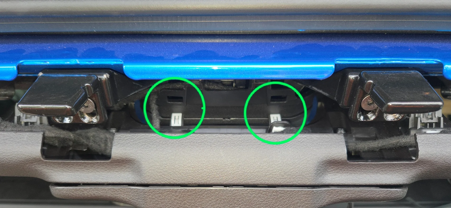

There are only two install videos I could find on YouTube and while I'm grateful to both of those fellows for the insight, neither of them had to deal with the huge ACC glob that my '25 has right under the bracket location.
If you release the two clips circled in my photo, it gives you an extra 1/2" of clearance, it still sucks, but it makes it possible with lots of patience (of which I have little) and lots of colorful language (of which I possess in abundance).
I did replace the included 1"+ long bolts for the front brackets with shorter hex heads which helped a lot.
Clips to release for slightly more room.
