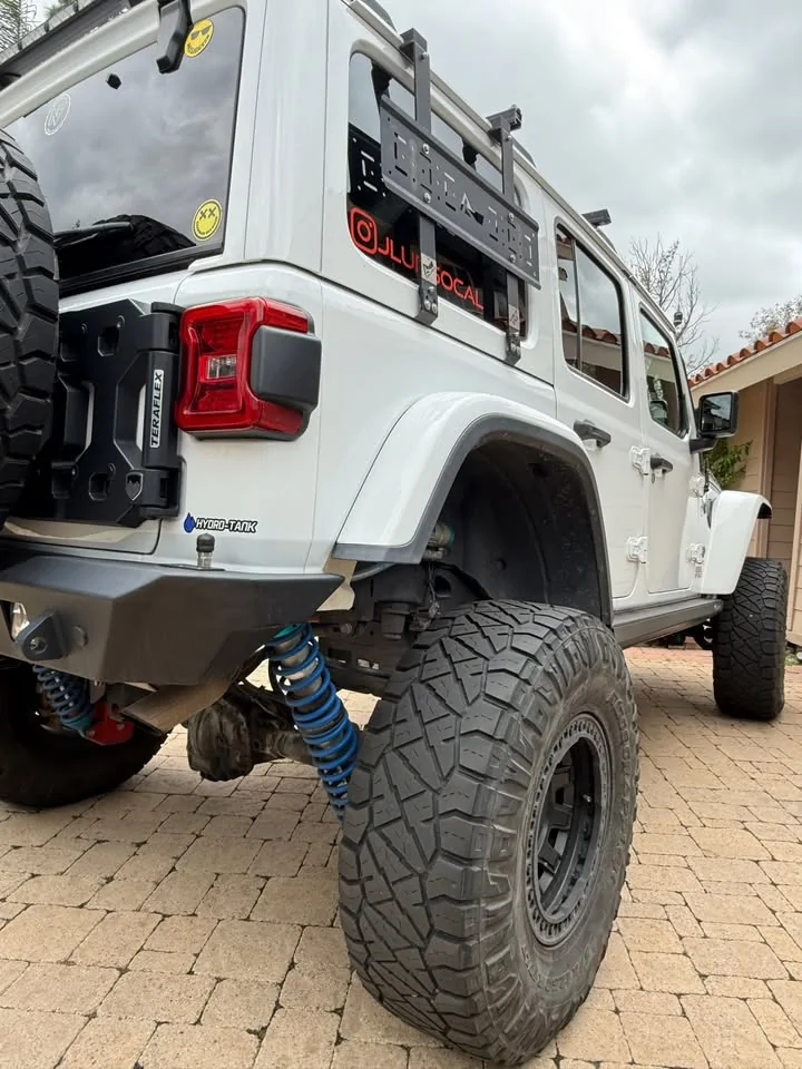

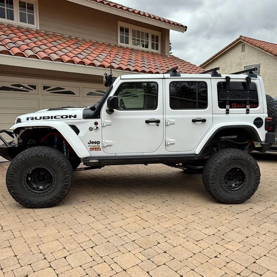

Hi folks, I'm starting this thread to chronicle my journey with a new to me 2018 JLUR. I bought this a week or so ago for $30K, it has about 70K miles on it. Here's what it has on it so far, in random order:
Rhino Rack Pioneer Platform RoofRack
Rock Slide Engineering Step Slides
Poison Spyder Front Bumper
Rebel Off Road Rear Bumper
CMM Spod Screen Mount
Vector Offroad Front Dash Mounting Rail
KC Gravity Pro 6 Light Bar
KC G34 Fog Lights Front Bumper
KC G34 Fog Lights Rear Bumper
KC Cyclone Rock Lights / Entry lights
SPOD - Bantam and LED Switch Screen
Genesis Dual Battery System
Cascade Designs Solar Main-Battery Charger
Rugged GMRS Radio and Speaker
SB 10K Winch w/ Wireless remote
King 2.5 Adjustable Dampening Coil Over Shocks
Terraflex IR Long Arms F/R
Yeti HD Front Track bar
Yeti HD Drag Link
Falcon Adjustable Steering Dampener
Synergy HD Reinforced Steering Box Bracket
KMC Tank Bead-lock Wheels 4+1
Revolution Gearing 4.88:1 Diff Gears
JE Reel HD F/R Drive Shafts
37ā€ NItto Ridge Graplers (60%) remaning
Terraflex HD Rear Tire Carrier
AAL Rear Cargo Shelf
This is what she looks like now.

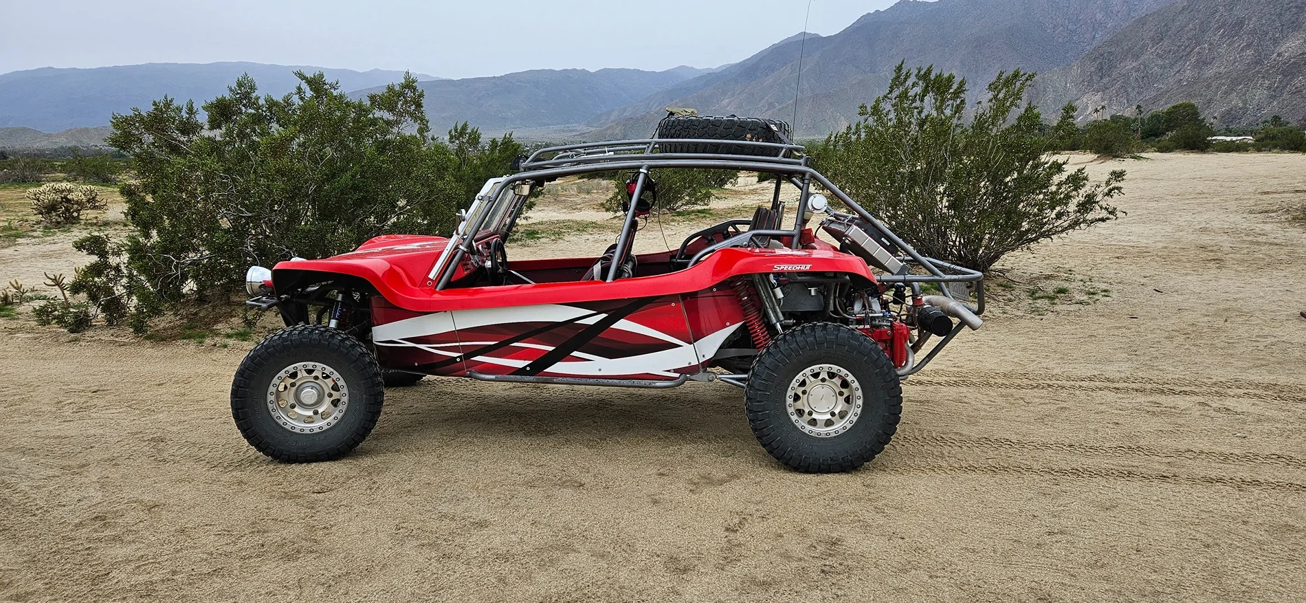

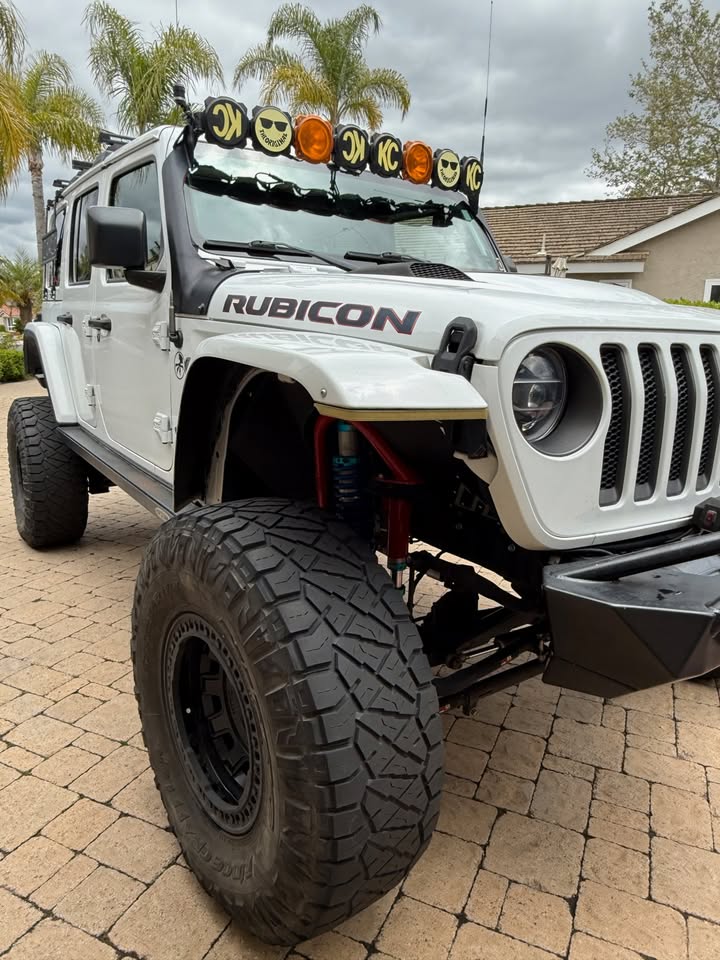

Pic of toy Jeep is replacing. This is powered by a Turbo Subaru STI motor (~300 hp).

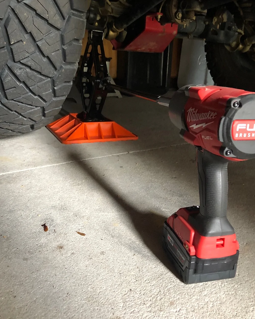

What are some good choices for a jack, I don't want to carry a high lift. Looking for a capable scissor or something. Needs to get under the axle with a flat tire and lift high enough to get a 37 back on.
I use the factory scissor, I bought a hi lift jack base that i put under it….. it lifts my 37s a few inches which is all I need to change the tire….i also use my M18 impact to turn the crank… jacks it up in seconds…

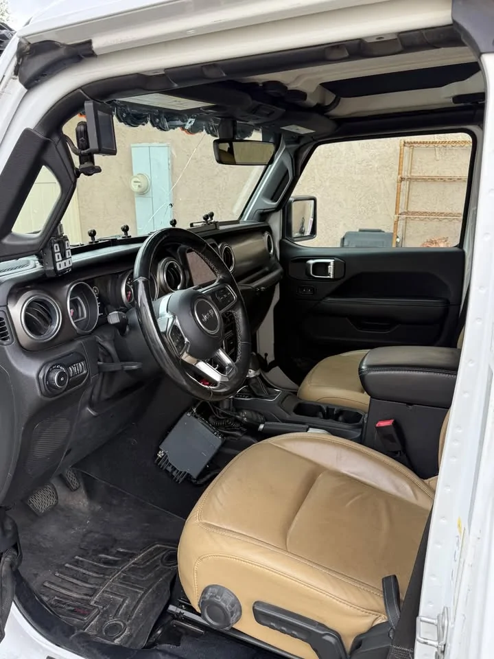

Been a busy boy working on the Jeep. I rewired most of the circuits on the Spod, installed a race radio and got it ready to tow behind the motorhome, also got a brake buddy.
Last time out the steering was an issue in 4L with both lockers on, so I bought the Apex steering boost kit with cooler and installed that yesterday. I didn't remove the front grill or winch, or the fresh air duct, none of that seemed in the way. I did remove the sway bar, and that made the cooler installation and the hoses really easy. Took me about 3.5 hours, will be testing it next weekend in the desert.
