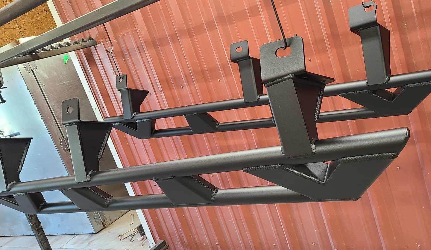

One of the tabs to weld on the frame was close to a body bolt, so not all of that one was welded.
if your sliders ship raw, I’d have everything sanded and avoid powdercoating the feet around where it will welded into the frame.
That will save time and money having to remove powdercoati mg before welding.
