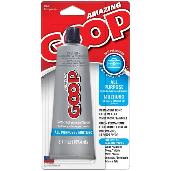

What I did to fix this 2dr. hardtop rattle:
Use the stuff in the pic below.. Buy at Home Depot, amazon, etc.
I have had it hold both covers for about 15,000 miles now. I have no squeal or rattle. No issues
Just press/attach the covers in place. Get them lined up and placed where you want them. The adhesive pads on the back of the covers will hold them in place o you can do the gluing.
It is awkward, trying to get the Goop along the bottom edge of each cover. All you need to do is put a good toothpaste like amount around the bottom of each cover. I used a wood tongue blade, but you can use a small plastic knife. To get the Goop on along the bottom seam of the covers, put the Goop on the plastic knife, then put the knife by the seam and the Goop will oooze downward into the seam.
You have to apply and let dry a few hours.. If you apply and don't let the Goop dry the covers will undoubtedly pull away when driving/moving gthe JL, and the cover bottoms will fasten down in the wrong place.
IF you ever need to remove the covers, (very doubtful) apply heat to the Goop with a hairdryer and it lets right go.
Bill
Doesn't matter if the Goop packaging says for Marine, Household or whatever, it is all the same stuff.

Awesome. thanks rhinebeck01 bill! Super helpful and i know i won't be the only one looking for a better fix on this as time goes on. My initial foam stickys worked for a while but at 8k miles, i'm looking for something better as i'm rattling and rolling down the road whenever i hit a bump now.
On edit: 4/11/19
Bill

I never would've thought to look there because it was just too easy to notice...and overlook. I ran my hand along the entire passenger-side interior & happened to touch it. I prepped myself for an hour-long project and it took all of 4 minutes. I didn't expect crappy adhesive on the interior of a 45k vehicle. The command strips were also a big help. Many thank-yous.

They're covering up wiring going up to the sound bar. Goop or Command Strips will resolve it quickly... I found the Goop to be more secure.
Don't throw 'em out!
