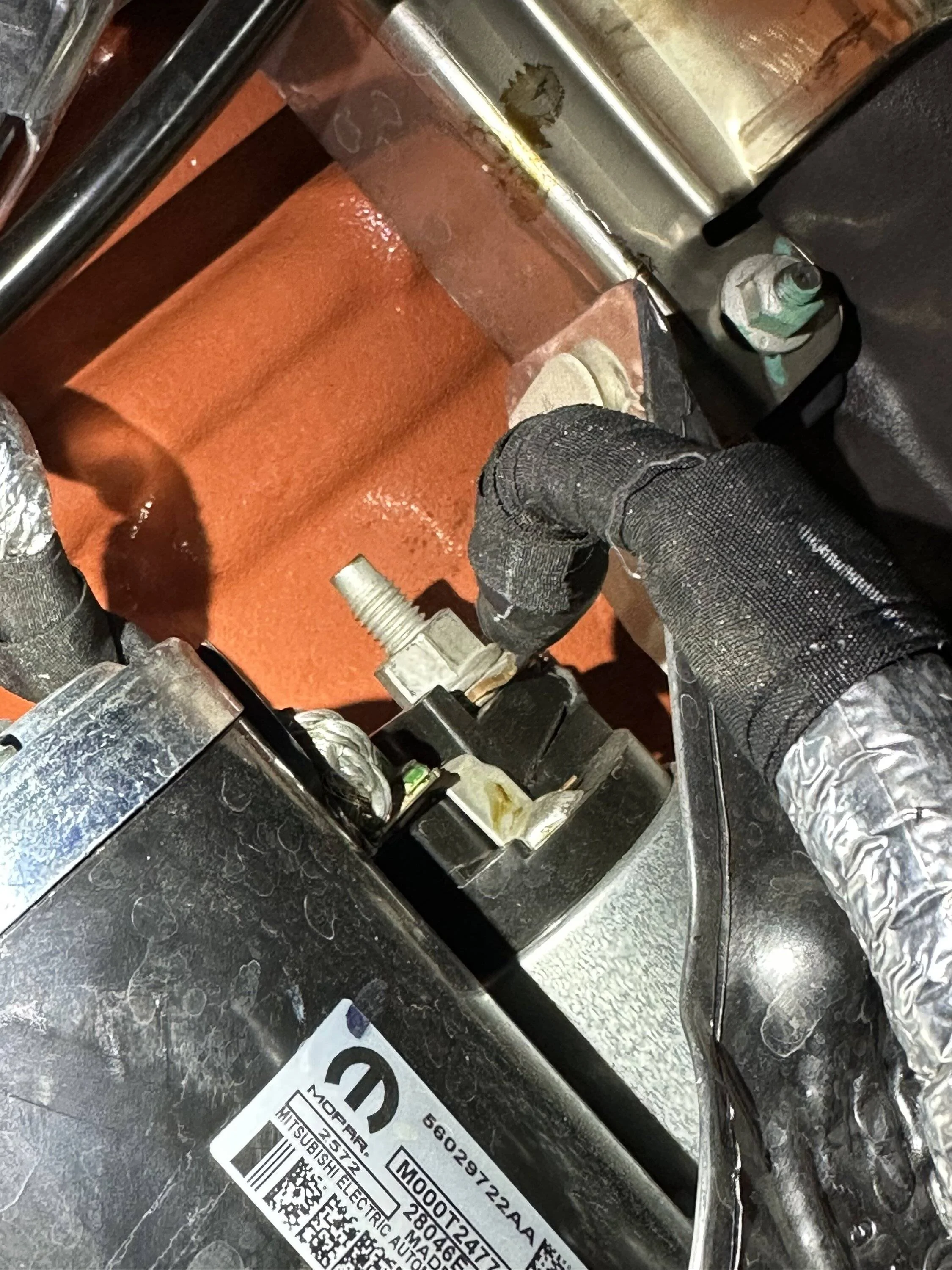

Starting about a week ago, once every 4-5 starts, the Jeep doesn’t. Sometimes there is nothing when the button is pushed. Sometimes a click under the hood (like a relay) Some times a brief Rrrr.
Battery voltage is good. All terminals tight. Connections at the starter good. All fuses/relays seated. Wiggled the shifter. Doesn’t make a difference. Everything powers up normally, no warning lights.
If I “key off” and open the door to shut all the way down and try it again, fires right up.
Any ideas? I don’t want to take to to the dealer to leave it for the day and have the, say it wouldn’t act up for them, because it probably won’t.

Have a link? I did a search and got bupkis. What was the determination?

Update: problem found. Broken starter. Waiting for a tow truck.
