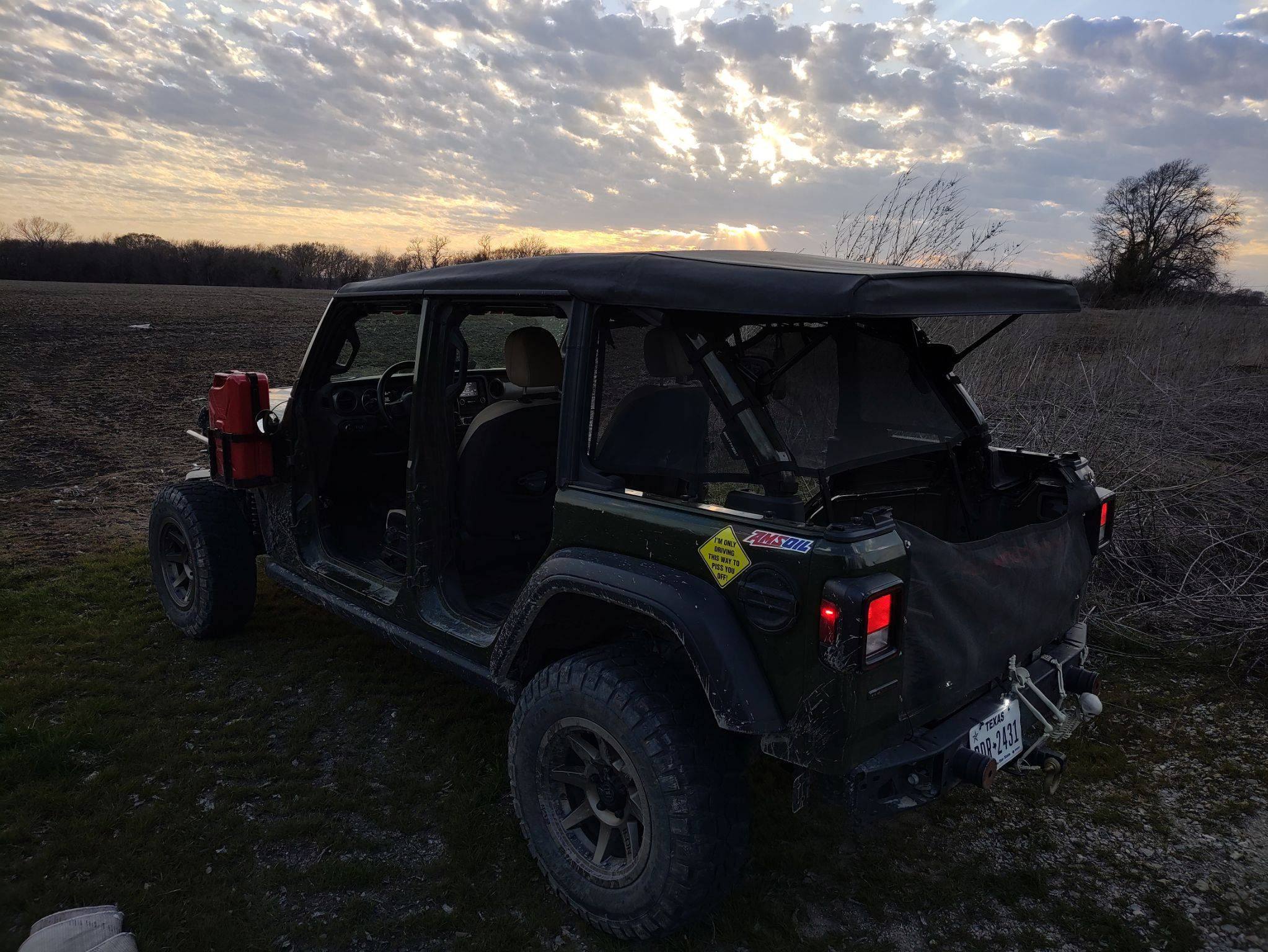

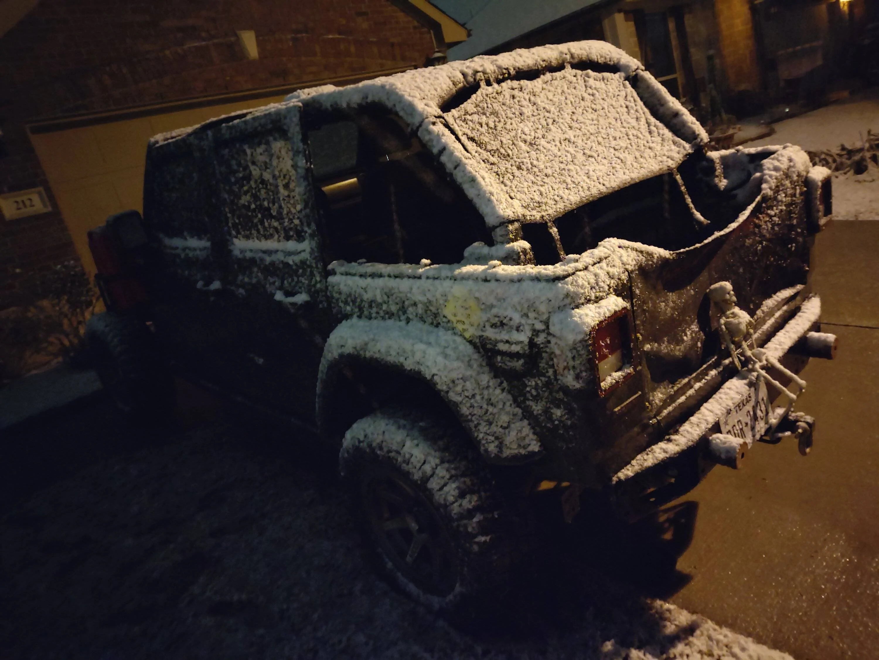

Jeep Wrangler JL Weight reduction IMG_20230221_175542
Jeep Wrangler JL Weight reduction IMG_20230124_203243288
Oh yeah, depending what state you're in you don't need fender flares. They are fender flares, not fenders. You have fenders already and I believe in most states you have to have fenders, but fender flares are cosmetic thing, you don't need those in most states that I know of.
I've been running without sway bars end links for the last year and a half, and recently just took off the whole sway bar entirely because why have the extra weight when I'm not going to use it.
So I guess let's get a all inclusive list here while I'm at it...
Remove the bumper covers
Remove all the plastic trim
Remove the carpets
Remove the spare tire
Remove tailgate
Remove hard / soft top
Remove doors / replace with soft doors
Remove fender flares
(check your state's laws)
Remove sway bar (might want to get comfortable with the body roll before you start driving on highways and such)
