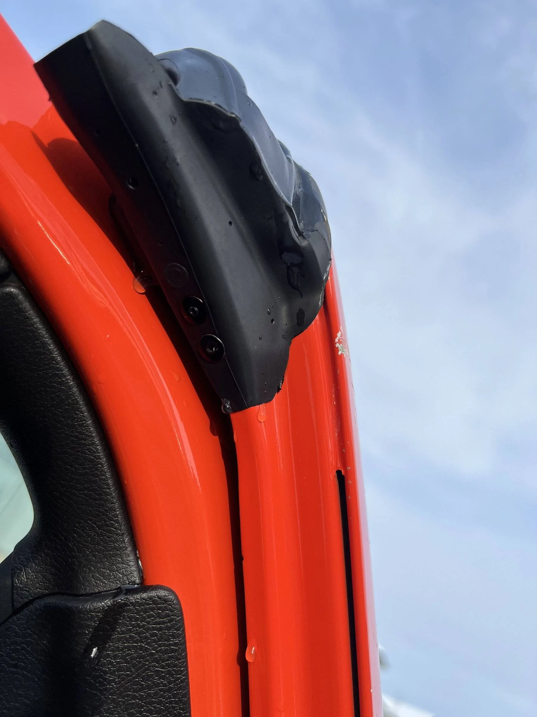

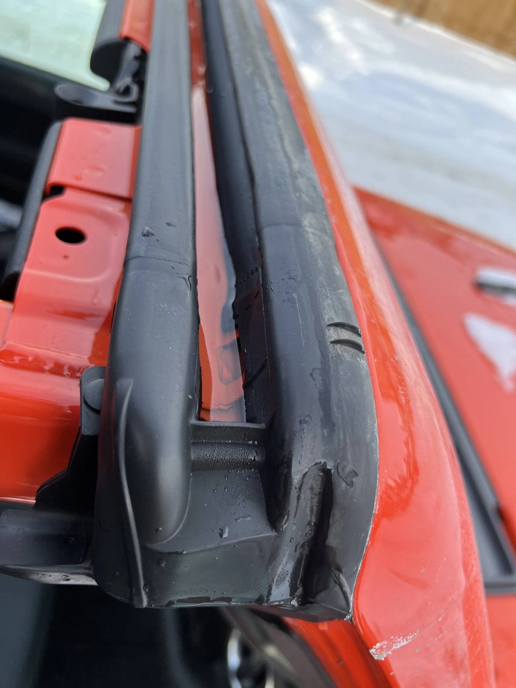

There is a water leak from the passenger side upper corner by the windshield it’s dripping badly after a snow melts or heavy rain it starts dripping on floor any fix available or any idea how to fix it thank you
I had the same issue on the driver side when I first got my JL. It turned out to be an improperly installed door seal from the factory. My dealer's leak specialist found the issue and repaired it under warranty.
