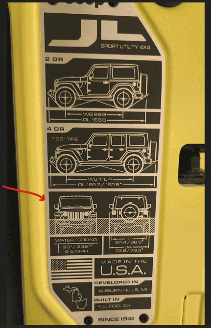

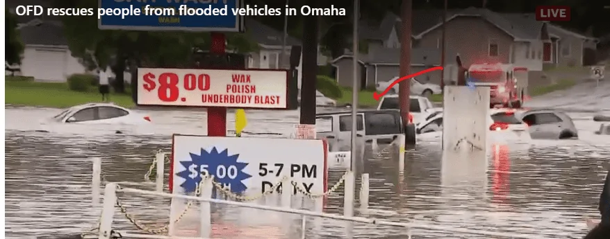

I have crossed streams on several trails, but for those that don't know how deep of water your JL can "Ford" or have never looked at the labels on the tailgate, your JL shows how deep of water it can "Ford" thru when it was stock. Obviously in the second picture that person never read the label. Yes, that was from the flooding we had in Omaha this week. Not sure what people are thinking when the drive into water like that.

The other problem is they go, "oh sh*t" and let off the accelerator. Smooth pedal, low speed, and once you're in, don't panic. The Jeep may drown, but I think most people drown it through their own action, letting off the accelerator. That Jeep had a couple of car lengths before it came out of the deepest section.

That water fording line is essentially at the top edge of the front and rear stock bumpers.
If my Jeep is lifted and on larger tires, is that line still the high water mark? i.e. can I now go that much deeper, 30" plus my added lift height plus added tire height?

Assuming the picture is drawn to scale, it looks like pretty much the top of the front and rear bumper is the safe limit according to Jeep. I'd be curious to measure mine tonight and see what height they're at these days. According to my napkin math, I should be able to ford 37" of water (31.5" stock is what my 4xe Rubicon manual says + 3.5" lift + 2" additional tire height).
In reality the deepest I've ever forded was probably 24" and I don't know if I'm brave enough to really try anything deeper than that. Guessing the water depth wrong could be the most expensive mistake I ever make.
