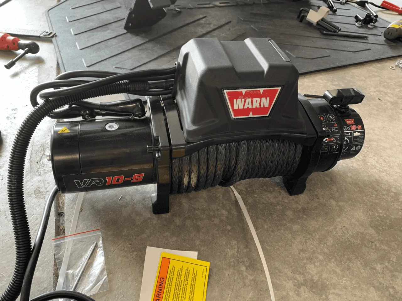

When I was looking for a winch, both of these were in the running. I came across a great deal on a used EVO, but when I went to get it one thing changed my mind, the wires/cables sticking out of the side of the control box. I know its only cosmetic, but in my opinion it looks terrible. Might not bother some folks at all, but exposed wires infuriate my OCD.
Yeah, watching the video above reminded me of that. The zeon uses a busbar style contactor, which is definitely sexier in its cleanness. I'd go as far as saying that the VR looks way better, when not sitting right next to the Zeon. Also, that contactor has less resistance than the added cabling, so a slightly stronger current is getting to the motor. So, a looks and function benefit.
Good grief is that ugly! Even Rough Country winches look better than that.
