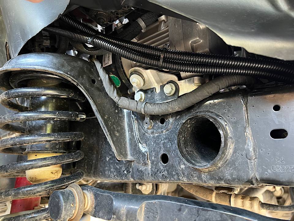

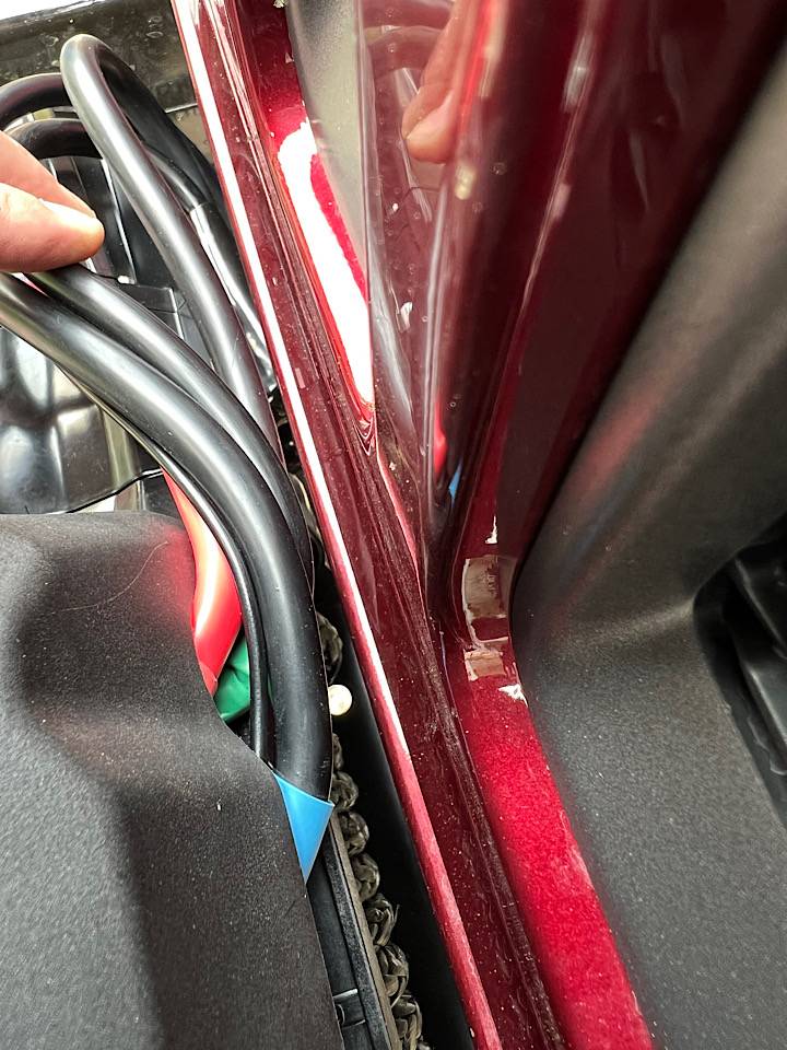

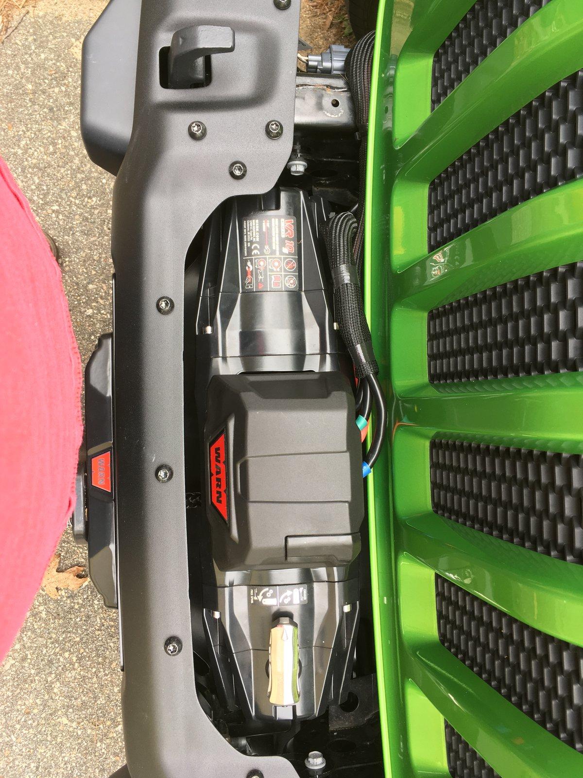

No cuts to the plastic or grommets. I chose to go over the frame up front and run the wires along the frame. I hope I can explain how I did it and you can follow with these pics.

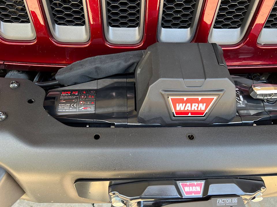

The first pic shows the the wires going forward under the top of the bumper to the outside of the frame. The "red" wire is inside the black corrugated protector and the black is running beside the motor,
Jeep Wrangler JL Warn VR EVO 10S & Warn Plate Install Pics IMG_4320

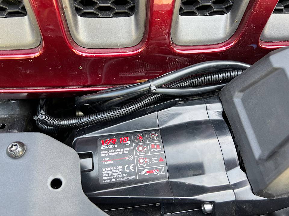

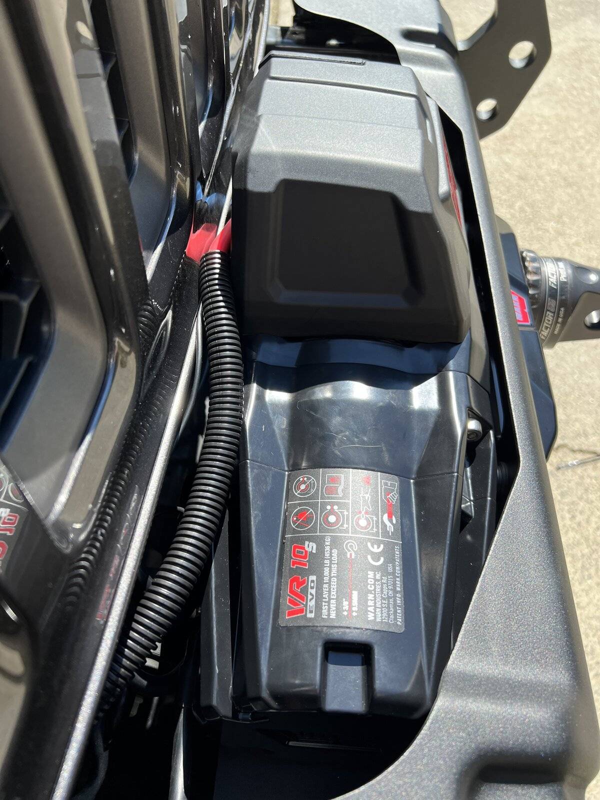

The next 2 pics show both wires on the outside of the frame.
Jeep Wrangler JL Warn VR EVO 10S & Warn Plate Install Pics IMG_4319
Jeep Wrangler JL Warn VR EVO 10S & Warn Plate Install Pics IMG_4318

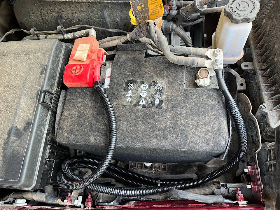

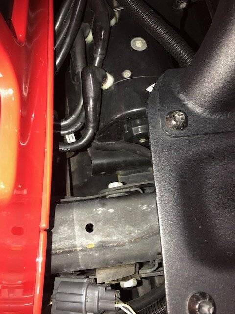

I brought the wires up between the battery and air box. I was concerned having a front end accident with the wires being "hot" so I installed a relay to keep the wire from being energized and a 300 amp (if my memory serves me right) on the positive side (just in case).
Jeep Wrangler JL Warn VR EVO 10S & Warn Plate Install Pics IMG_4321

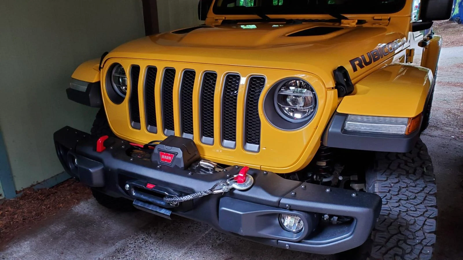

Is that a EVO 10-s? It looks different than mine.

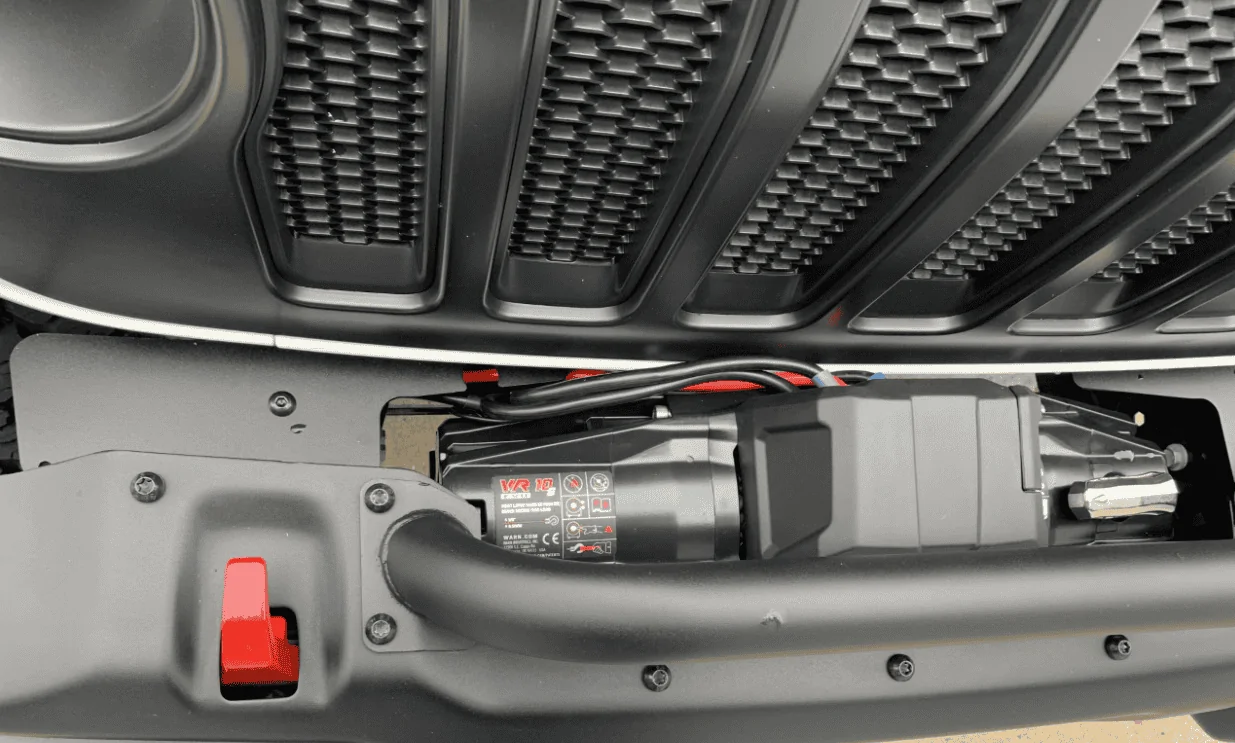

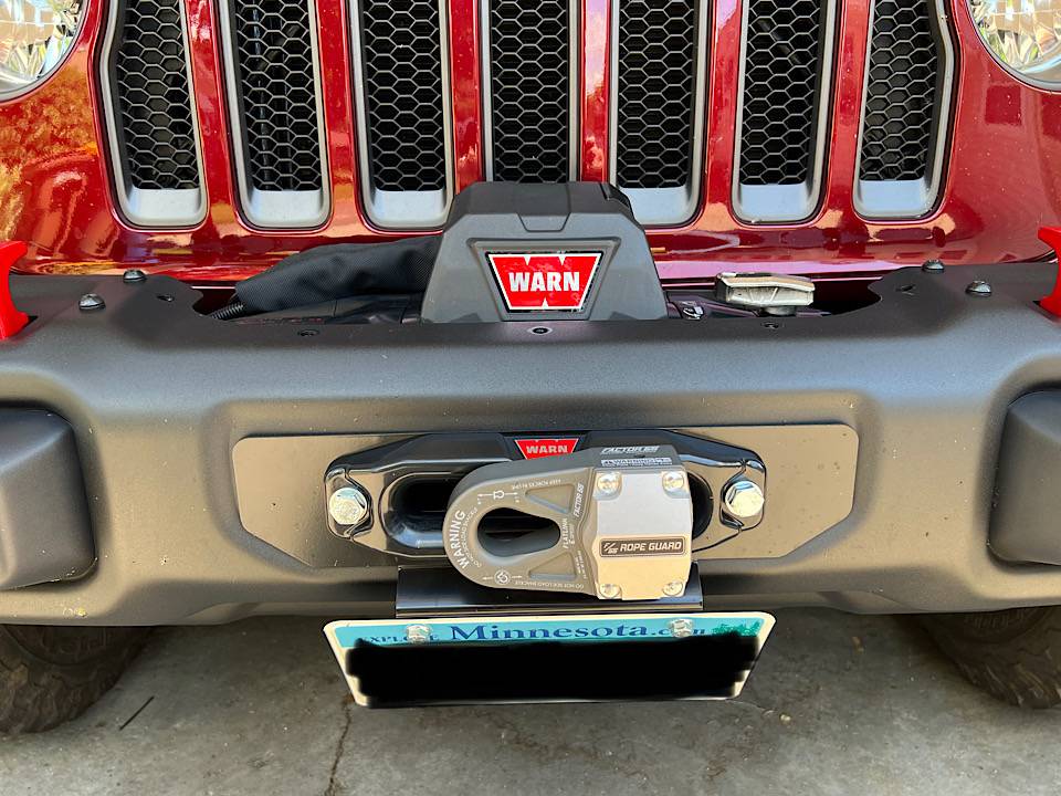

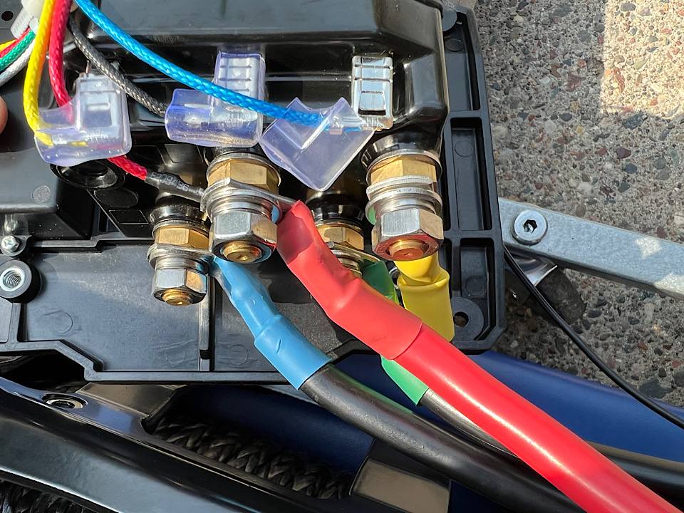

What plate are you using? I used the Warn plate, and my wires are pressed super tight to the bottom of my grill.
same here because i too used the Warn plate.

Thinking I might upgrade to the Zeon as it has internal bus bars....however I see in other threads that some people have issues fitting the Zeon between the frame rails....
I wish there was a way to get an optimized winch plate for each winch. If the holes were 1/2 inch forward then my VR EVO would fit fine...

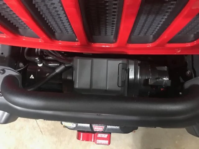

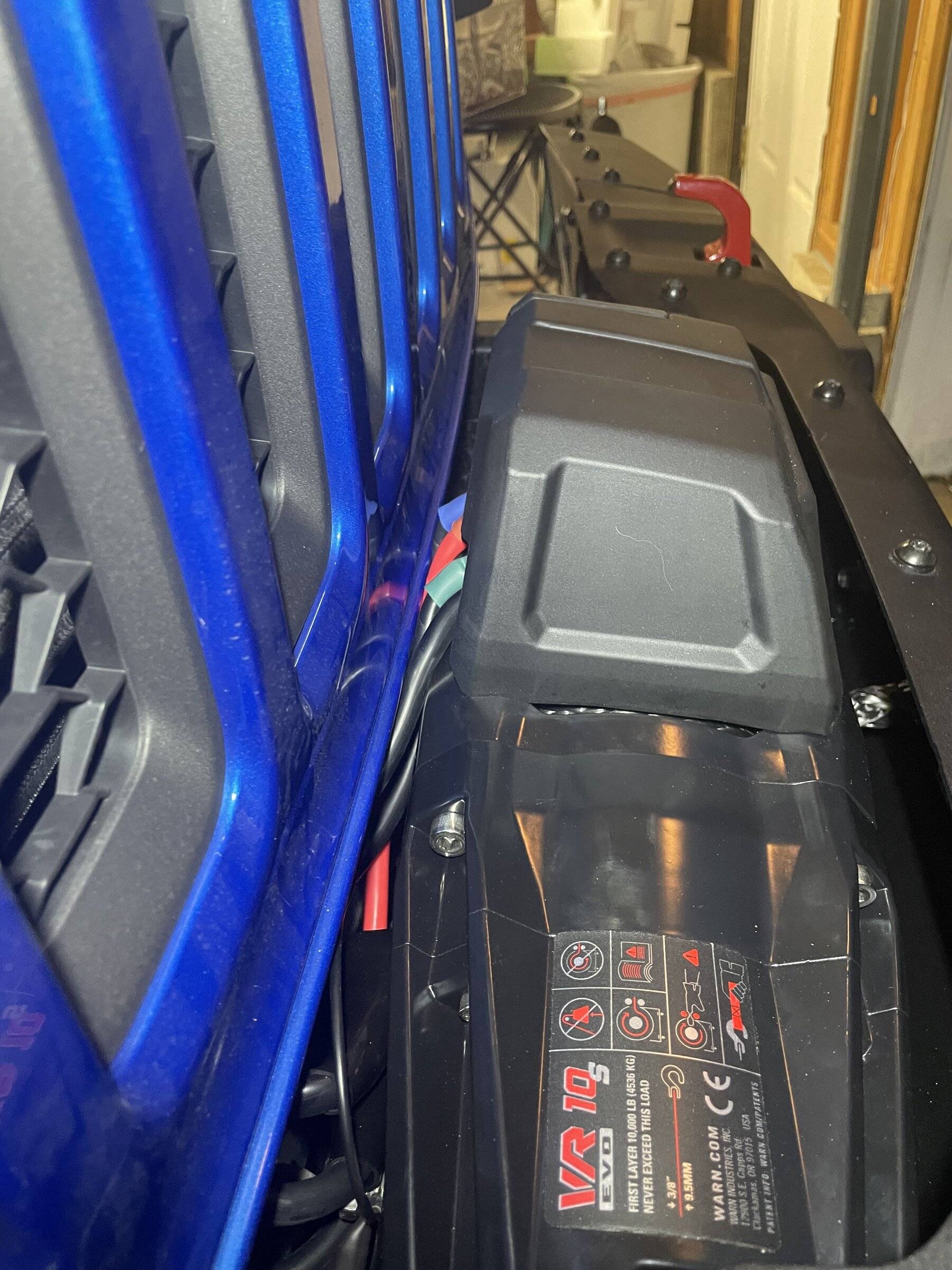

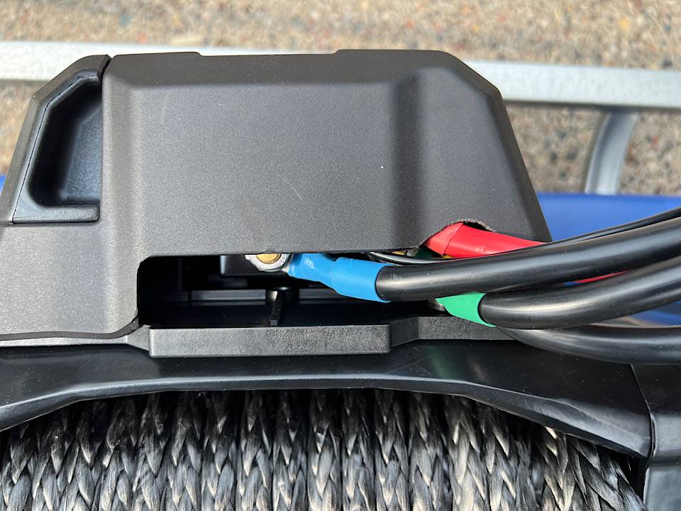

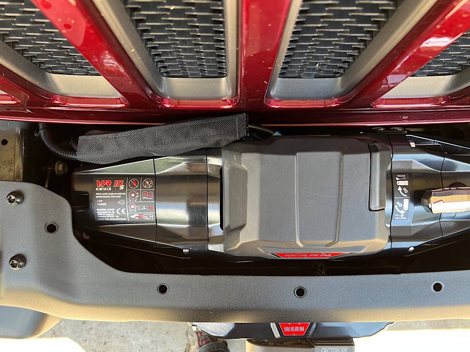

Jeep Driver, how did you get the wires to come out of the side of the WARN control box? All the VR EVO 10s that I have seen have the wires exit the rear of the controller it mashes the wires against the grill.
LCW
Jan 22, 2022
1,032
1,965
Twin Cities MN
'19 4R TRD (gone '22 JLUR) (gone '23 Bronco BL 2d)

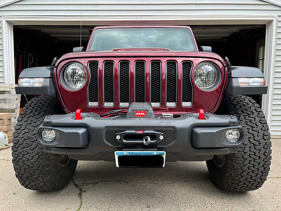

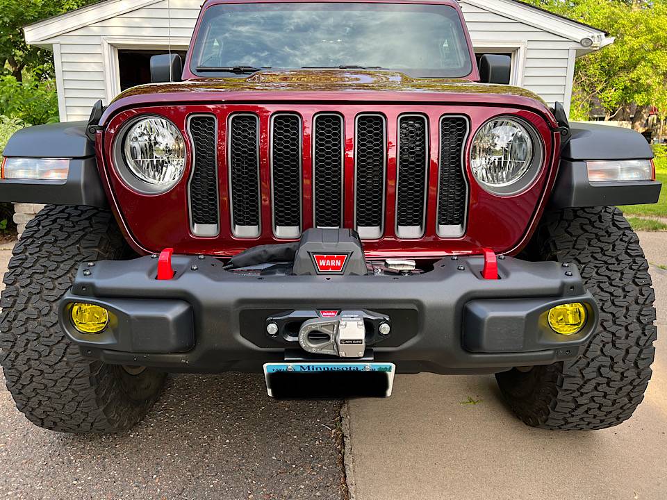

I dremeled the cover a bit and reclocked the wires so they didn’t press into the grille. Just need to get a harness sleeve to cover they up a bit.
