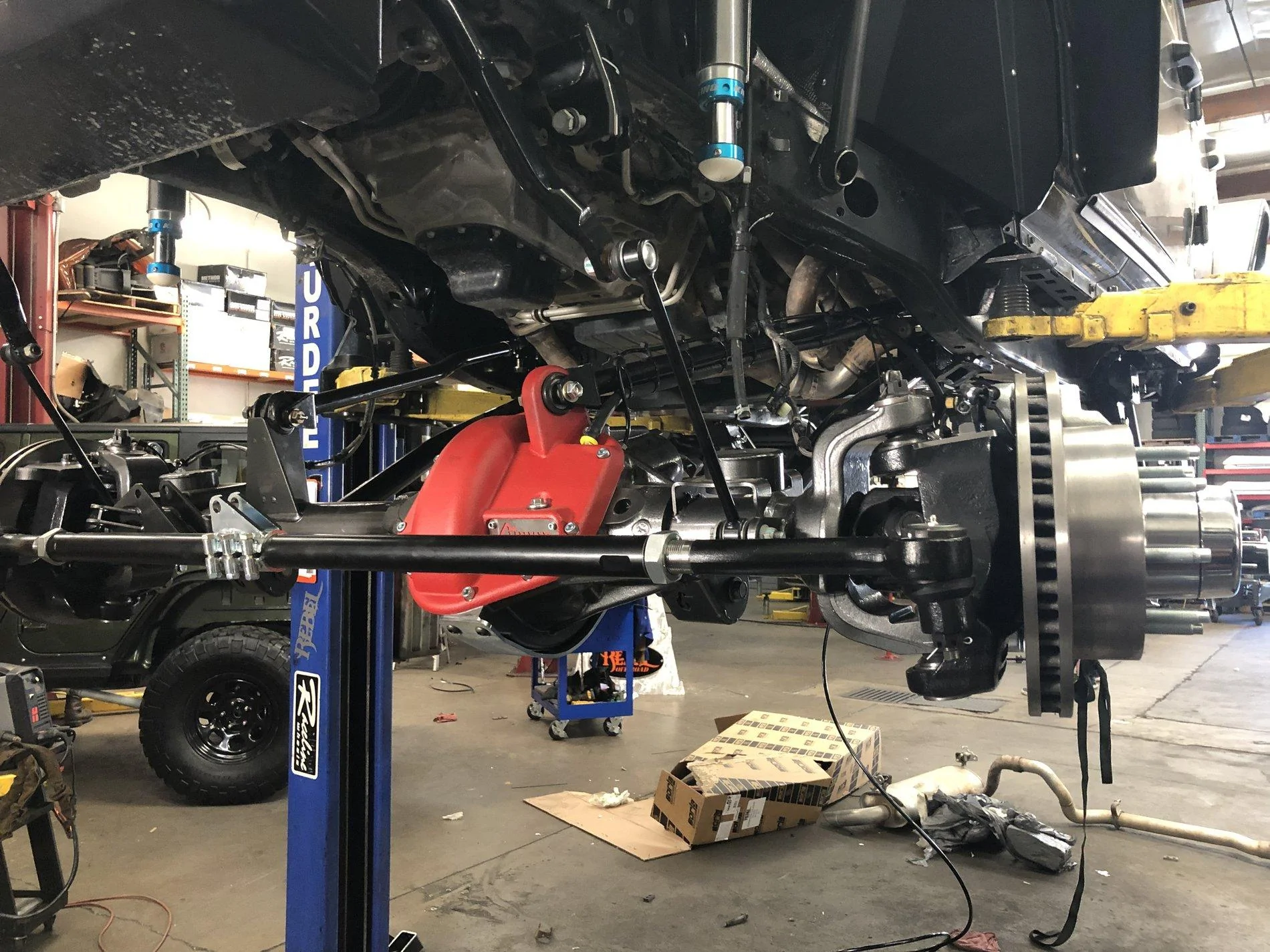

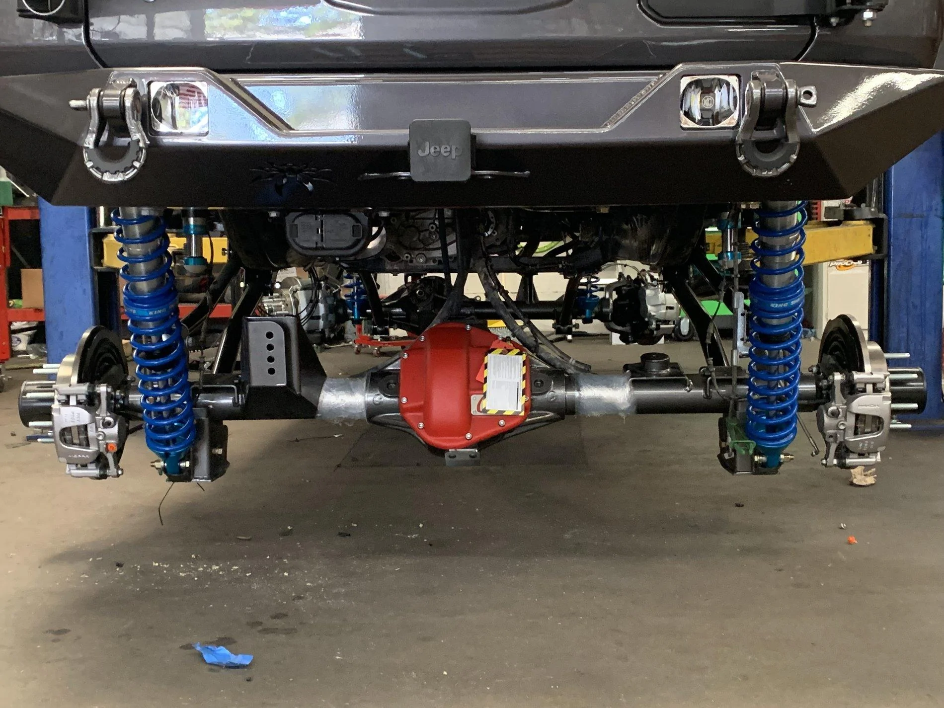

Thx! I am running RockKrawlers 3.5” Long Arm kit.
What gearing? Are the axles locked? ARB?
Do you have a build thread? Also curious about the rear bumper.
