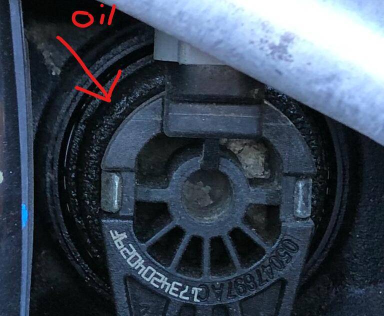

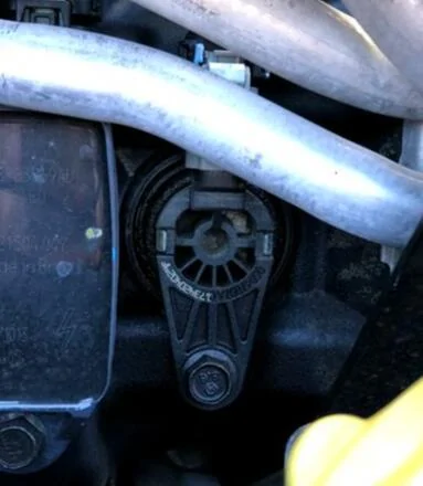

My 2018 3.6L had that same issue on the passenger side with low miles on it. Making sure that I got the right size o-ring, I just replaced it with a new one that came with o-rings already on it (link below). After replacing it and cleaning around it, the oil stain never returned. If this is what you are talking about (photos below). The toughest part was getting the electrical connection disconnected. After that, it is just a matter of removing the bolt and pulling it out.
https://www.amazon.com/VIKKSAER-05047897AC-Variable-Solenoid-Replacement/dp/B0BVVFGHBB
Jeep Wrangler JL VVT Solenoid seals 1751495368924-ga
Jeep Wrangler JL VVT Solenoid seals 1751495780366-ah

I think the one I posted is the rear sensor.
