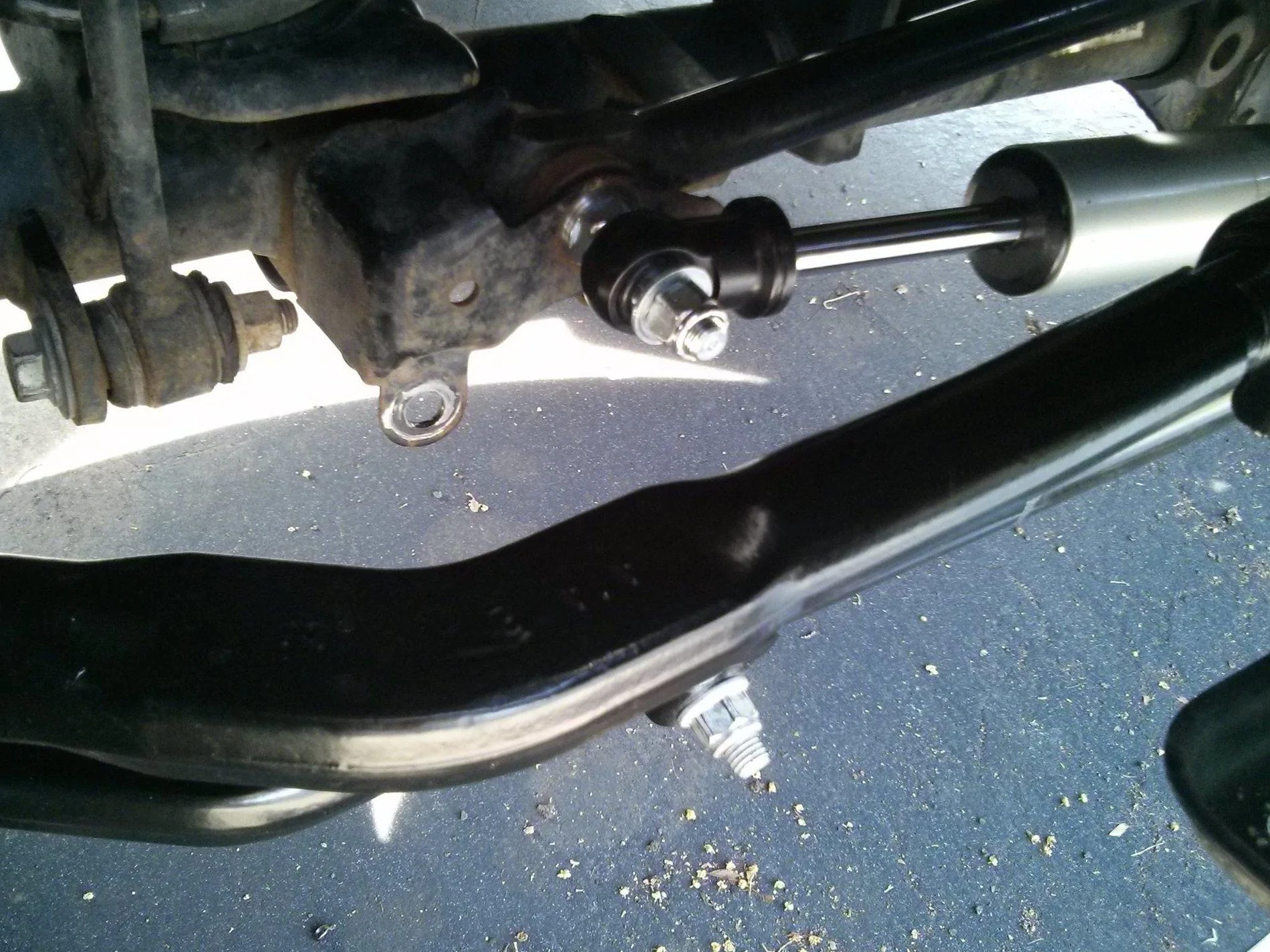

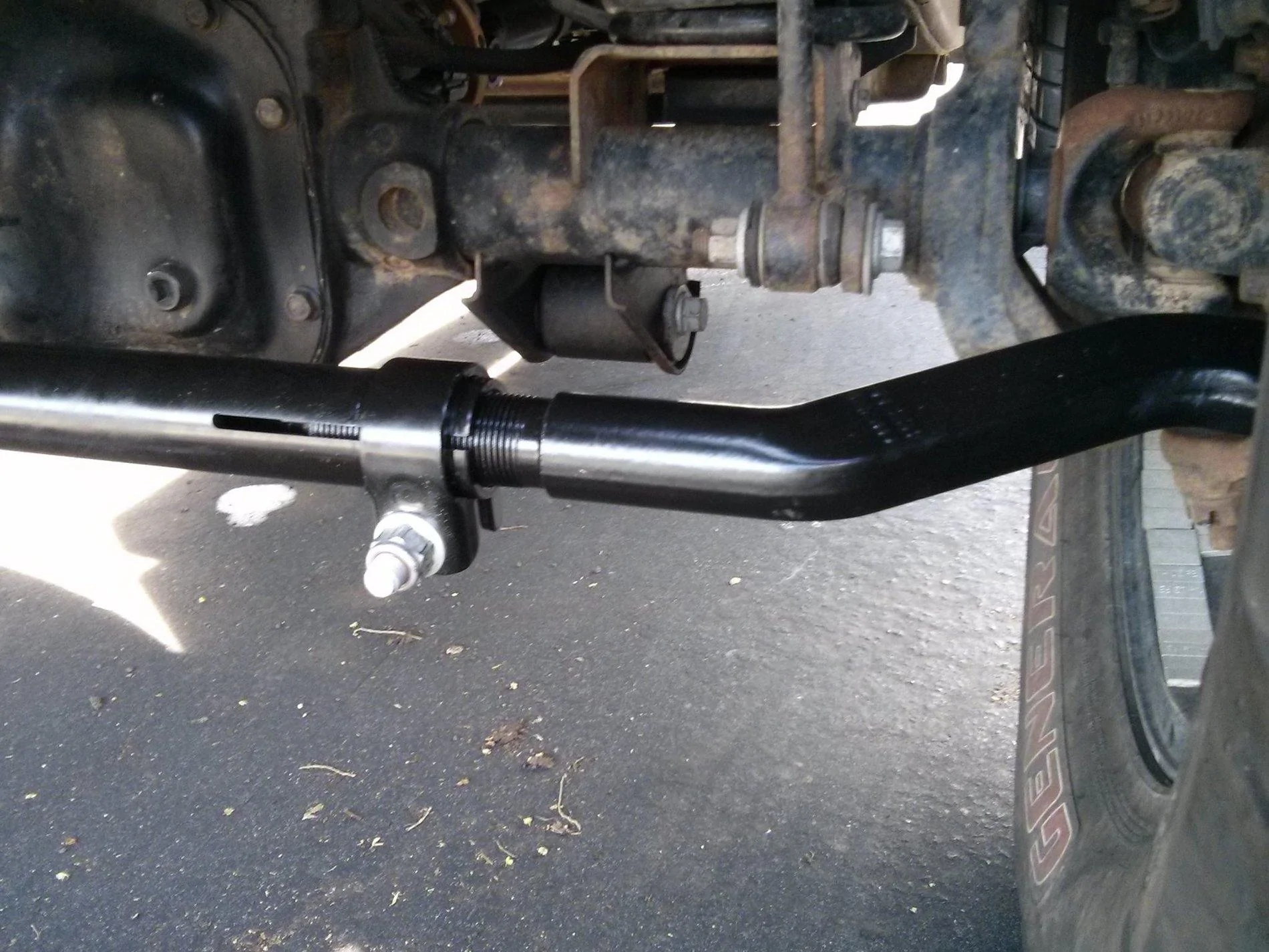

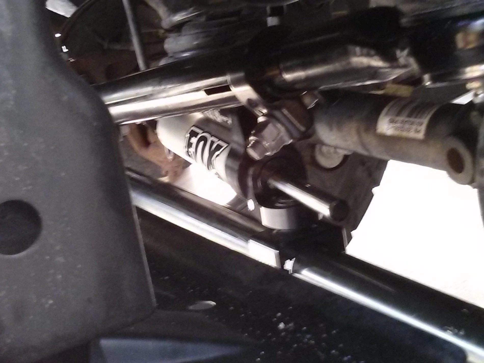

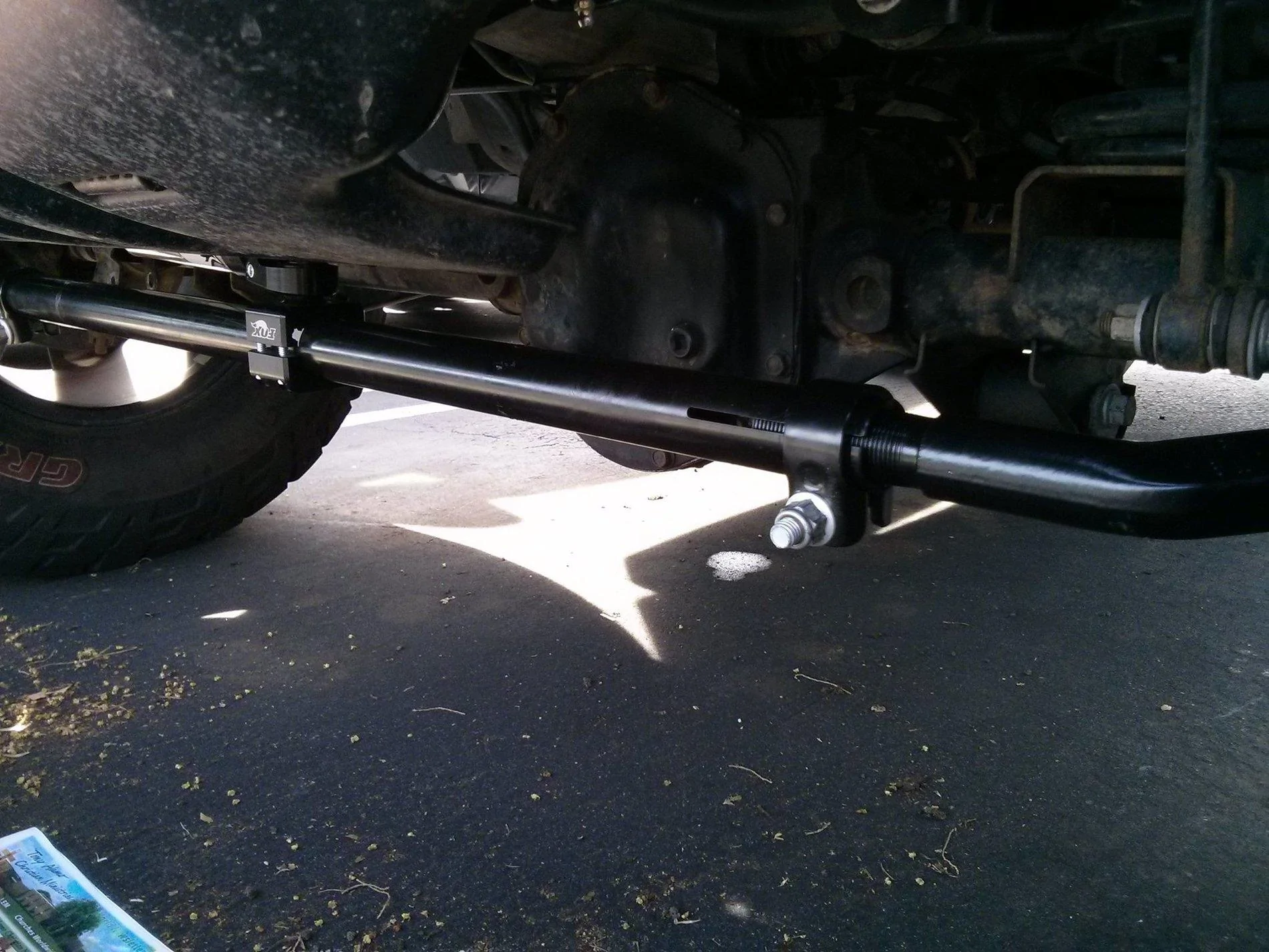

I had something somewhat similar on my 2013 JK Rubicon 2-door, with a 2” Mopar lift and 35” MT tires.
When I decelerated, the front-end vibrated and rattled. Worse, when I stomped on the brakes on uneven surfaces, the steering wheel pulled left and right.
I took my Jeep to the dealership. My Jeep dealer at the time was super cool. They identified that the factory steering parts were constantly battling those heavy tires. Turns out, my tire and wheel combo weighed 110 lbs each, vs the standard 65 lbs.; by 13,000 miles the added weight and contact patch had completely worn out the factory steering components. The service manager said “I could put a new steering damper, drag link and tie rod under warranty, but you will be in the exact same position in 10,000 miles. If you want to keep your current setup, best would be to put on some beefier aftermarket parts.”
I did my research, and ordered a YETI drag link and tie rod, and a Fox steering damper. The dealer even offered to do the labor at a competitive rate.
That was the end of the vibration and the rattling. Not only that, that 2-door JK always had handled quite squirrelly; the new steering components even made it track much more linear at speed.
Hope that helps.

Here’s the end result:
