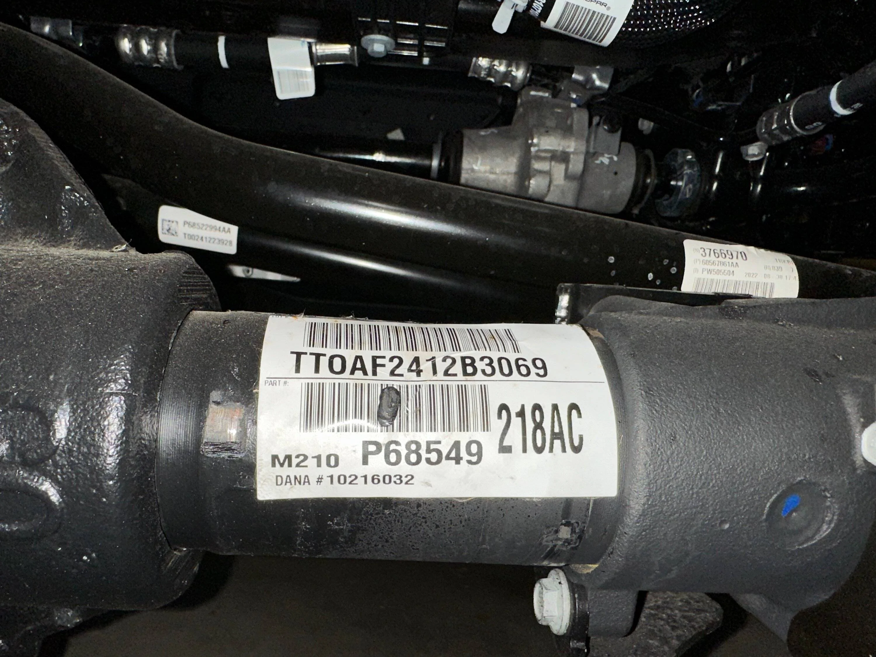

In looking at the XR package I see that it comes with the larger tires, different rims, a small lift, fender flares, HD spare tire mount, etc. The list of add-ons also shows 3rd Generation front axle and upgraded brakes.
Is the front axle on the XR any different than the one on a non-XR Rubicon? Are the brakes any different? I've tried to verify there are differences by looking up part numbers, but so far haven't been able to verify any differences in brakes or front axle between the XR and non-XR Rubi. The answer may dictate which way I go with an upcoming order.

The front brakes are the same between Rubicon & Rubicon XR, it’s the rears that are slightly larger on the XR package.

XR does have stronger front axle than regular rubicon, also steel knuckles. The axles are the main reason I went with the XR package. Worth it, IMO. Obviously not if you intend to upgrade the axles in the future anyway.... but I will feel very confident with these stock axles on 38s when I eventually make that jump.

Thanks. I'm planning on 37's and a stronger axle and improved brakes would be great. Hate having to pay for 35's with the XR package, but someone will buy them.

XR includes some nice parts, like the lower gearing and the strengthened axles.
The absence of a true "lift" and the oversized bump stops have been a point of contention since the package was first announced, though.
I read somewhere that XR has actually less articulation than a regular Rubicon due to those large bump stops.

Larger rear brakes, 43% thicker axle, iron steering knuckles, 456 gears are all on xr and are not cheap to source aftermarket
