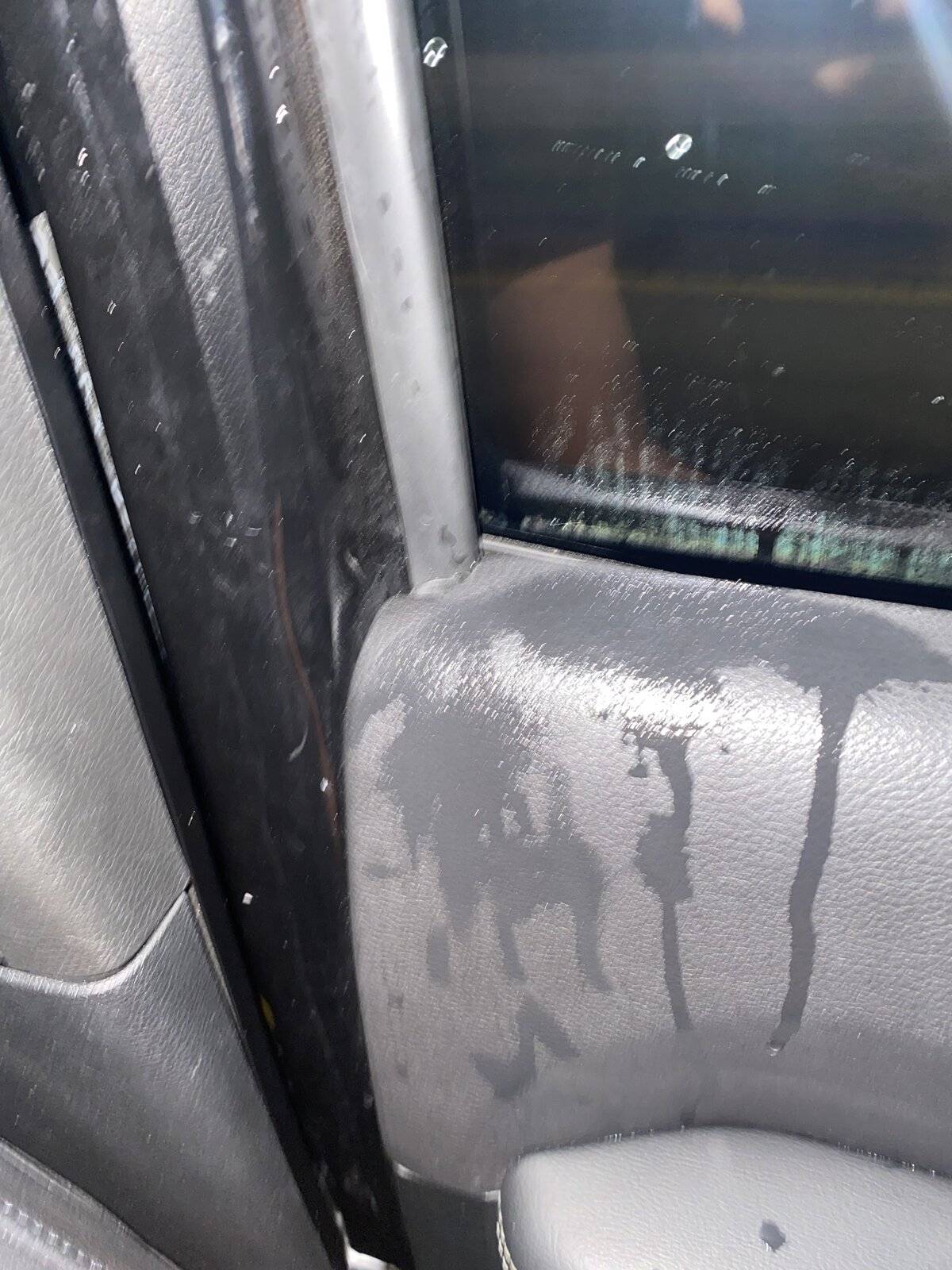

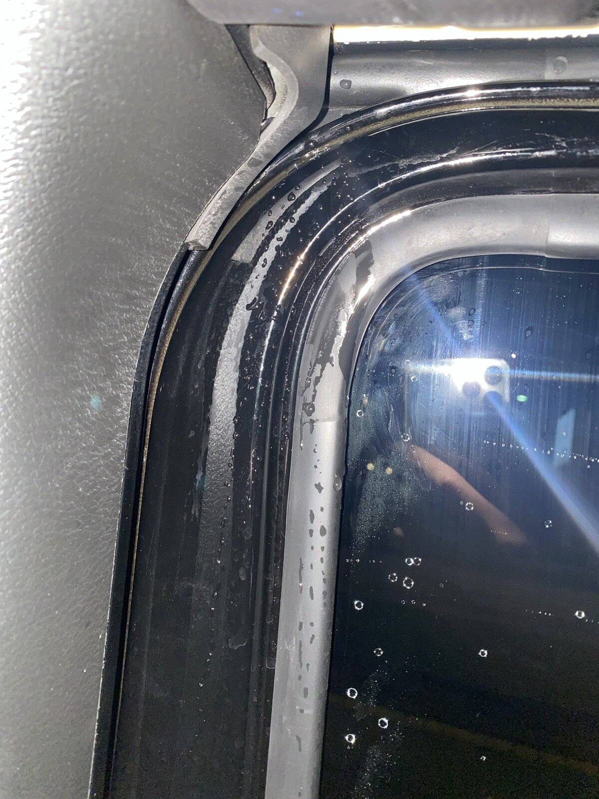

Hey everyone, I got this leak around the upper part of my door, I cant figure it out for the life of me and it is starting to drive me crazy. Here are some pictures, let me know if you would like some more. Thanks

It only occurs every time it’s been raining and I make a complete stop, then it starts to drip down.

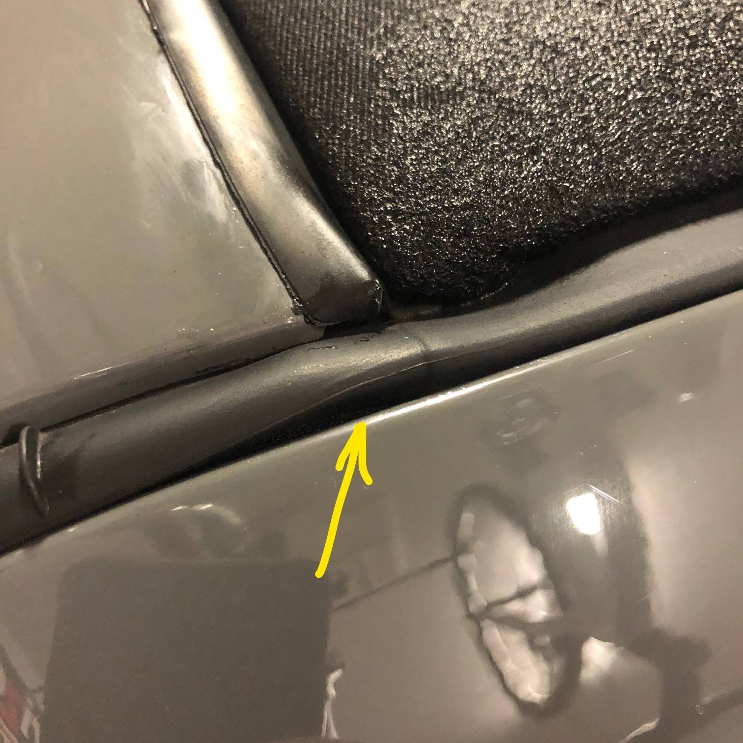

I had a leak that looked like it was coming from the upper forward corner of the door but was actually the header seal. If water can get in on the forward lip of the header seal where it butts to the windscreen frame it will not make it to the proper water channels and come in that corner. You might also want to check that the drain lines are all free from blockage. There is one on each side in the header seal channel.

Sorry for the delay. So this is what a header seal should look like against the windscreen frame:
Jeep Wrangler JL Upper Door Leak IMG_8411

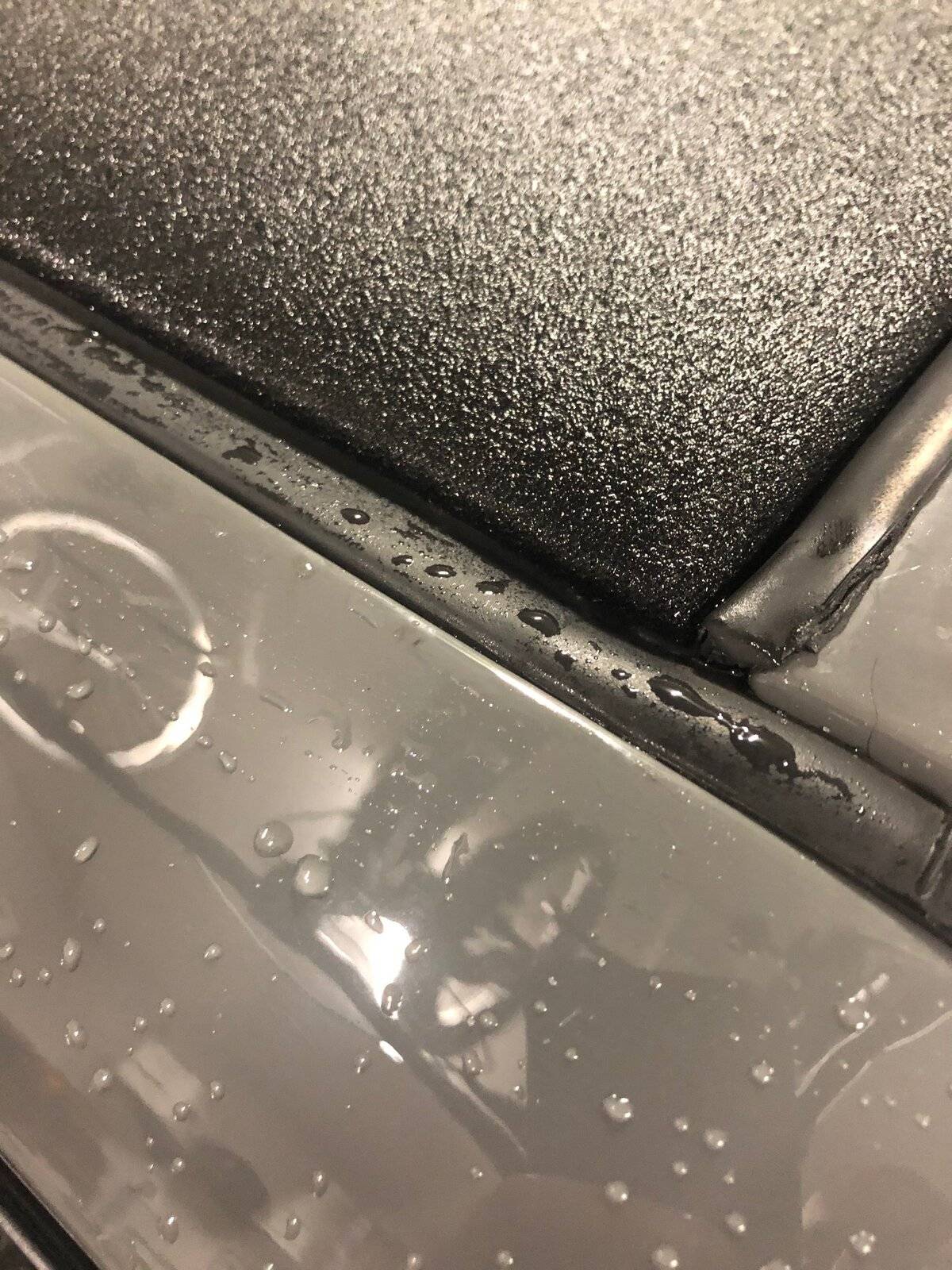

This is what the LHS looks like on mine and this lets water in that makes it in by the top of the front door.

The dealer fix was to use a sealant, which held up for about 1.5 years, but now it is starting to leak slowly again. I'm about to start the process again and push to replace the header seal.
