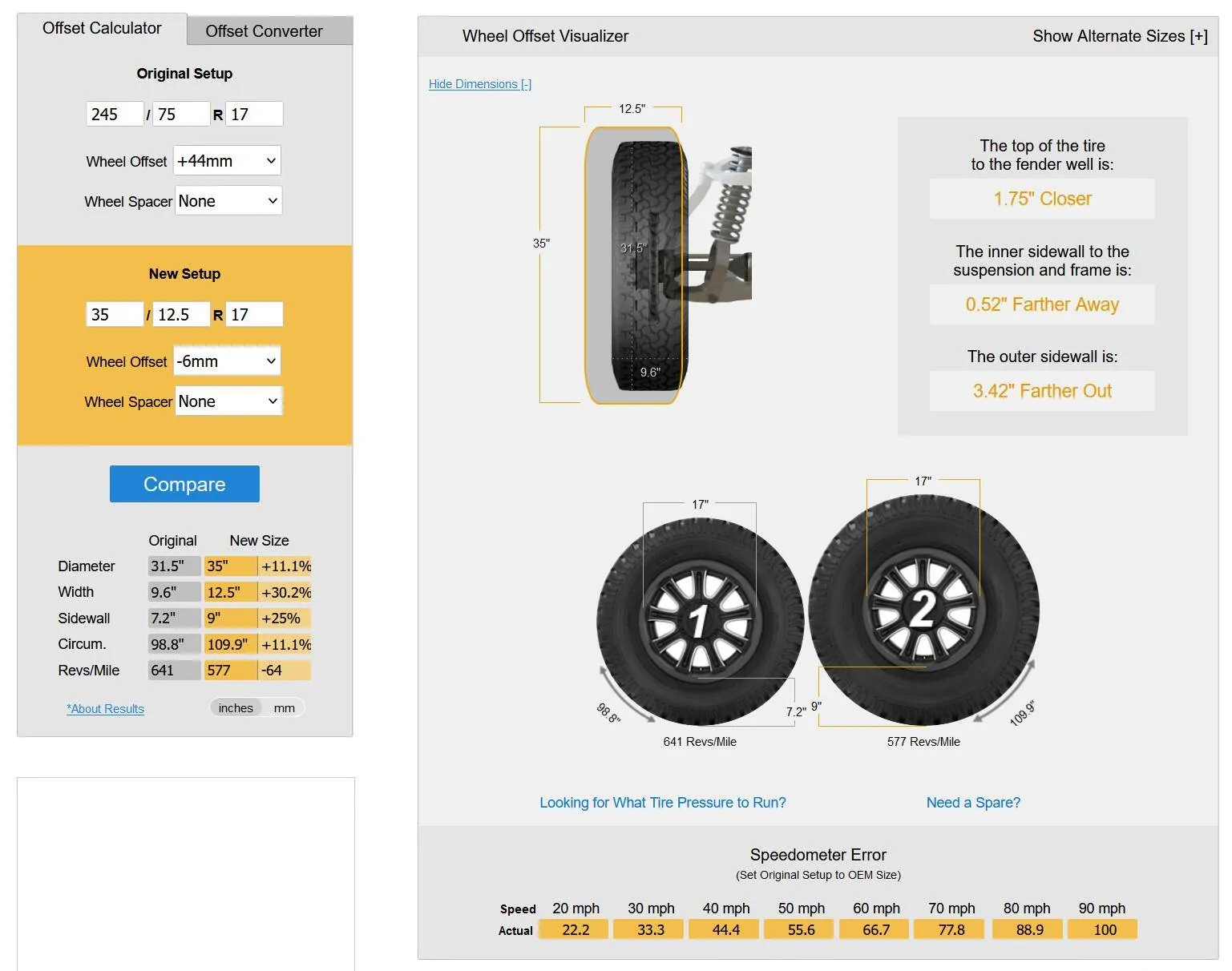

OEM on my Sport was 245/75R17, 17x7.5", 44mm or 45 OS, and I forget what the backspacing is for OEM.
New:
275/70R17 17x9, -6mm OS, 4.7" BS.
Are these going to stick out like crazy?
(Thanks and I hope I didn't hijack the thread. New member here, new Jeep owner as of last week. I've been meaning to post just an introduction thing)
Depends on your definition of crazy. They will stick out 3.42" from where they are now.
Thank you Reinen. Maybe I'm mistaken but I believe a 275/70R17 is a 33"x11", not quite so large as 35"x12.5". (I will not claim to be anywhere near an authority on wheels tires or general mechanics/suspension)
