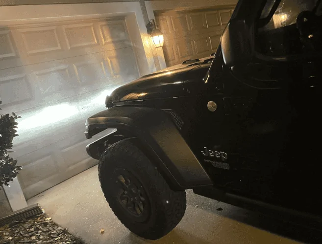

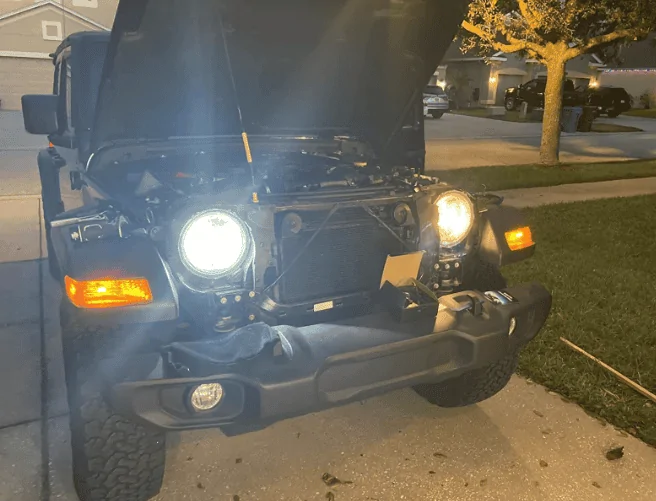

Got these AUXITO H13 LED bulbs, plug 'n play installation in my 2018 Jeep Wrangler JLU, no errors on the dash, visible cut-off line means you won't blind oncoming traffic! Works great in the stock/OE headlight housing. In the photos posted you can see a comparison of LED and halogen output on the garage door both showing the color variation, output, and cut-off.
