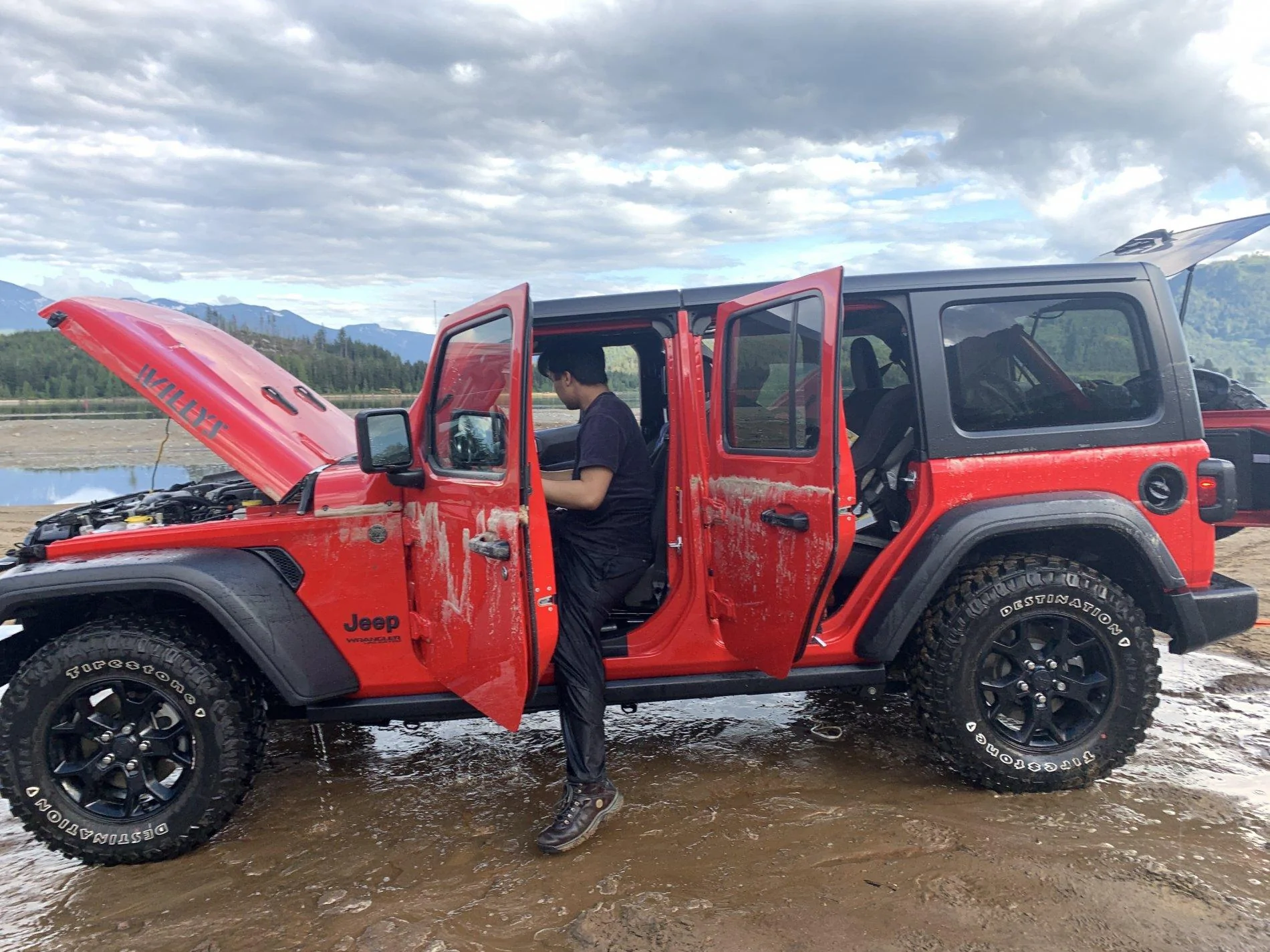

I got into a bit of a pickle with my Jeep. Water was inside up to chest level, passenger side was up higher so I’m glad water didn’t get into the air intake..
I was stuck in the water for awhile until help came, so I am guessing water eventually made it in the diff.

For reference, here’s a pic of how deep I was in the water, was probably in there for at least a 15-30 minutes.
Picture was taken maybe around 2pm during the day..
Didn’t get out of the mud flats until 3 am. Towed back to my home at 4 am.
Took a month to make sure everything was dry and clean
