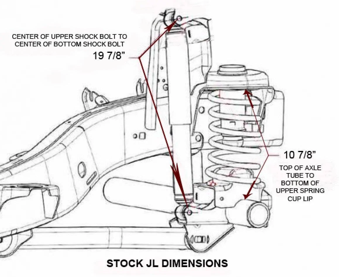

using this what are your measurements?
Jeep is still at the dealership, so I can't measure at the moment. That said, shocks were one of the first things the dealership examined and ruled out.
