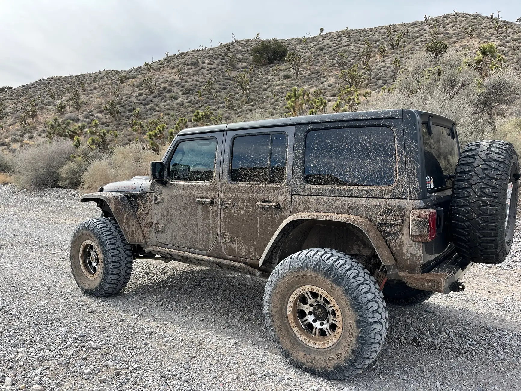

Looks Great! What Backspace are your wheels?

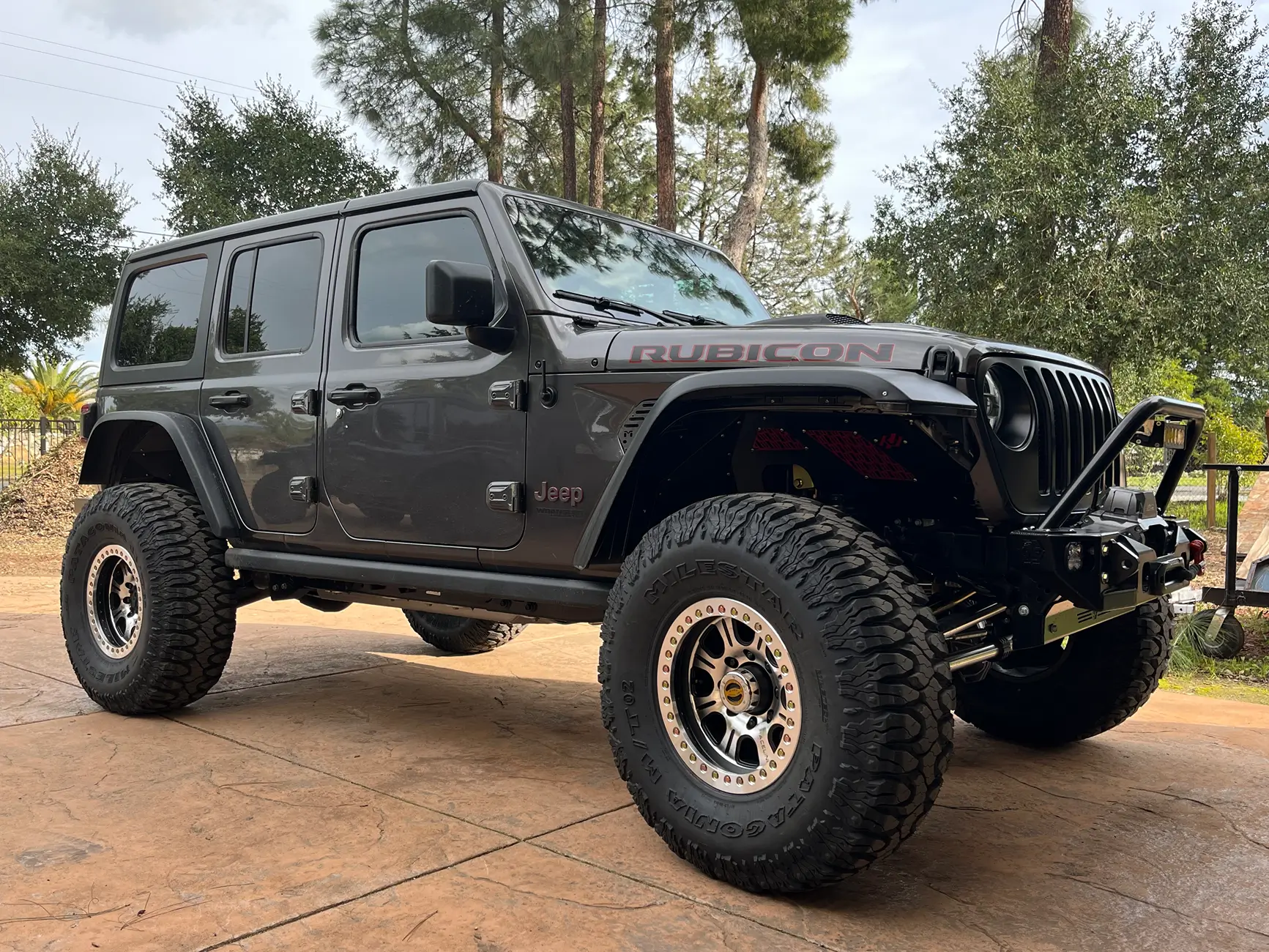

UD 60's with 4.5" back spacing. I believe I saw a instagram post from Dana indicating that they are going to start producing 72" wide axles soon. With that said, I am plenty happy with my 69.5" width.
-38, and I’m super happy with the Dana’s. Had a few issues with the place that installed them, but they made it right. Drives smooth, steering is great. I spent about 4 months doing research on Dana, Dynatrac, and fusion. At the end of the day the Dana was what I wanted. They’ve been around forever, I know how to work on them, and I really couldn’t see how the other brands are better for the money. Not saying they aren’t better, and not saying they aren’t good products. Except for Spicer they are both owned by ECGS. It really comes down to preference. I talked to a lot of people with the Spicer that are harder on them then I’ll ever be and they’ve had zero issues.
