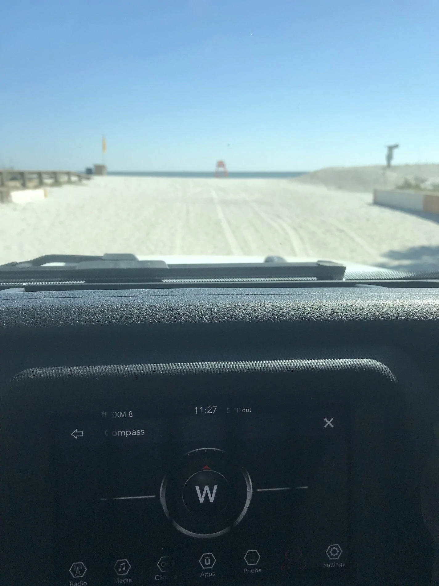

Just got mine back from dealer for some recall (steering damper). 1st attempt GAVE me front end wobble, that I didn't have. Second attempt new trail bracket??? Still have bit of wobble. But now My radio and compass are off! Compass 180 degrees out and Nav says im in baltimore when in harrisburg. I was invited to leave it again. Ahhhh no still trying to get the loose steering back to where it was before recall. UGH.

Took it back to dealer, was told need to leave it again.
Was still evaluating the loose steering issues. Didnt want to leave it again!
After driving it a few days, i see steering is still loose, so will be dropping it off again.
Hopefully they can look at radio.
As a side note looks like the jeep reverted back to the location it was picked up originally from day 1 in Maryland.
Seems to be a reoccurring theme also compass is 180 degrees off.
Uber loves me, back n forth to the dealer!
A person from jeep did call me not sure how they influenced the dealer??? If at all

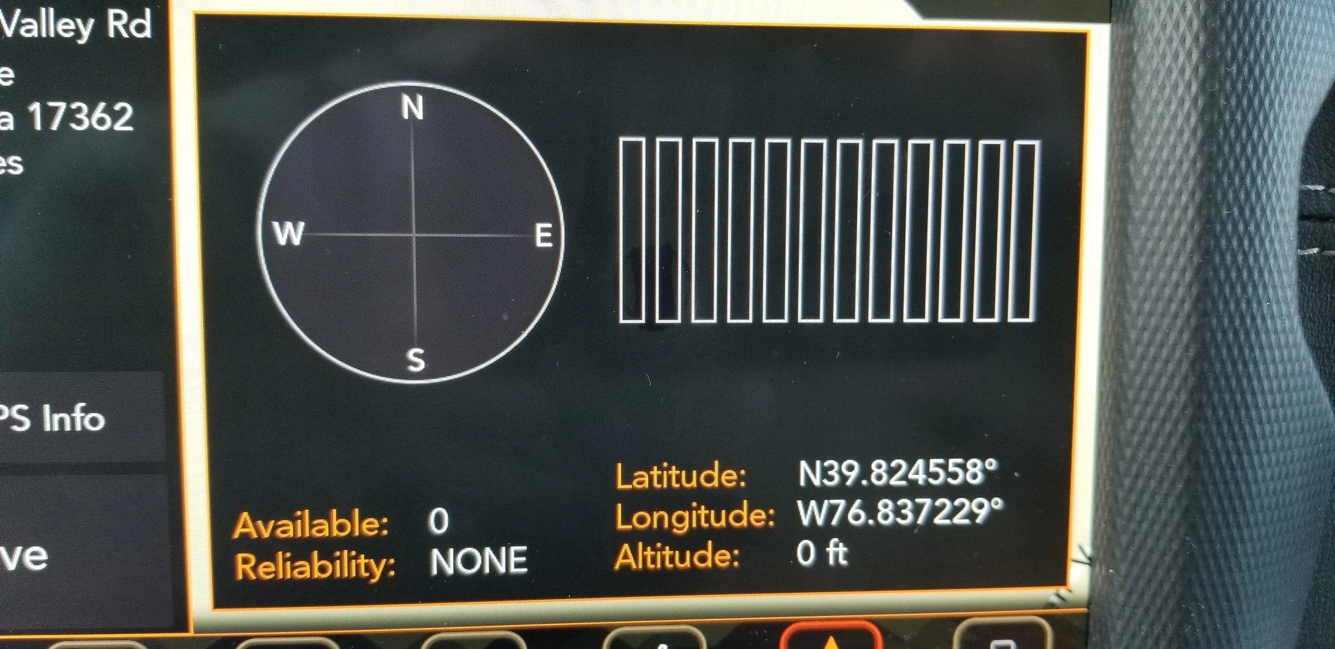

I see why its lost, no satellites. Ugh
Jeep Wrangler JL Uconnect CarPlay wrong location 20190929_151450
Jeep Wrangler JL Uconnect CarPlay wrong location 20190929_151446

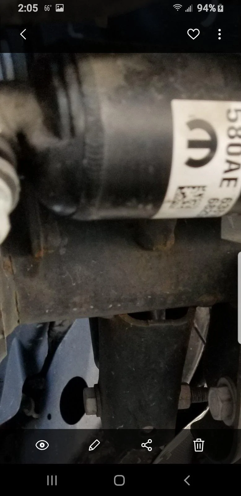

New radio, has satellites showing up now, must be diff software also as i have different icon on screen.
Also the spots where it normally cuts out for few seconds has improved to just a momentary click.
As for steering, they put the latest AE steering stabilizer with oil pod down and replaced track bar. Seems alot better!
Jeep Wrangler JL Uconnect CarPlay wrong location Screenshot_20191003-140522_Gallery
