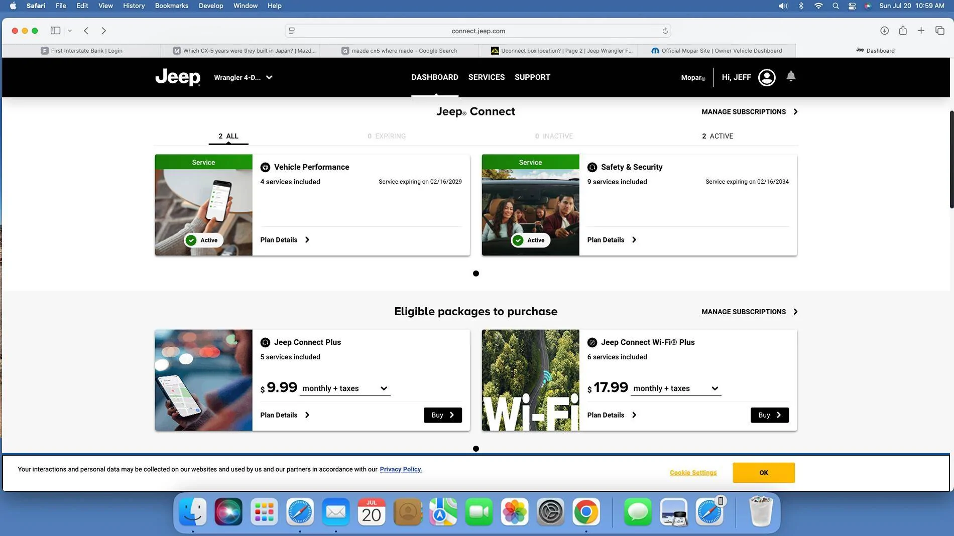

You might have to subscribe to connected services to have that function. Seems like you'd still have the free trial though. Maybe they didn't set that up at the dealership or used the wrong email to activate. You can call them to get it fixed. The dealer fat fingered my email but a call cleared that up. If I remember correctly, I just hit the Assist button in the Jeep.
yes it is free for 5 years..might need to set it up in this page..

Yes, we're fully subscribed, but our SOS and Assist don't work. All other connectivity functions work. Maybe that's why we don't get the trip info? We're 3 weeks and 2 cases open with Jeep Connect, and they can't figure that out. We have to take it into the dealer as the next step.
