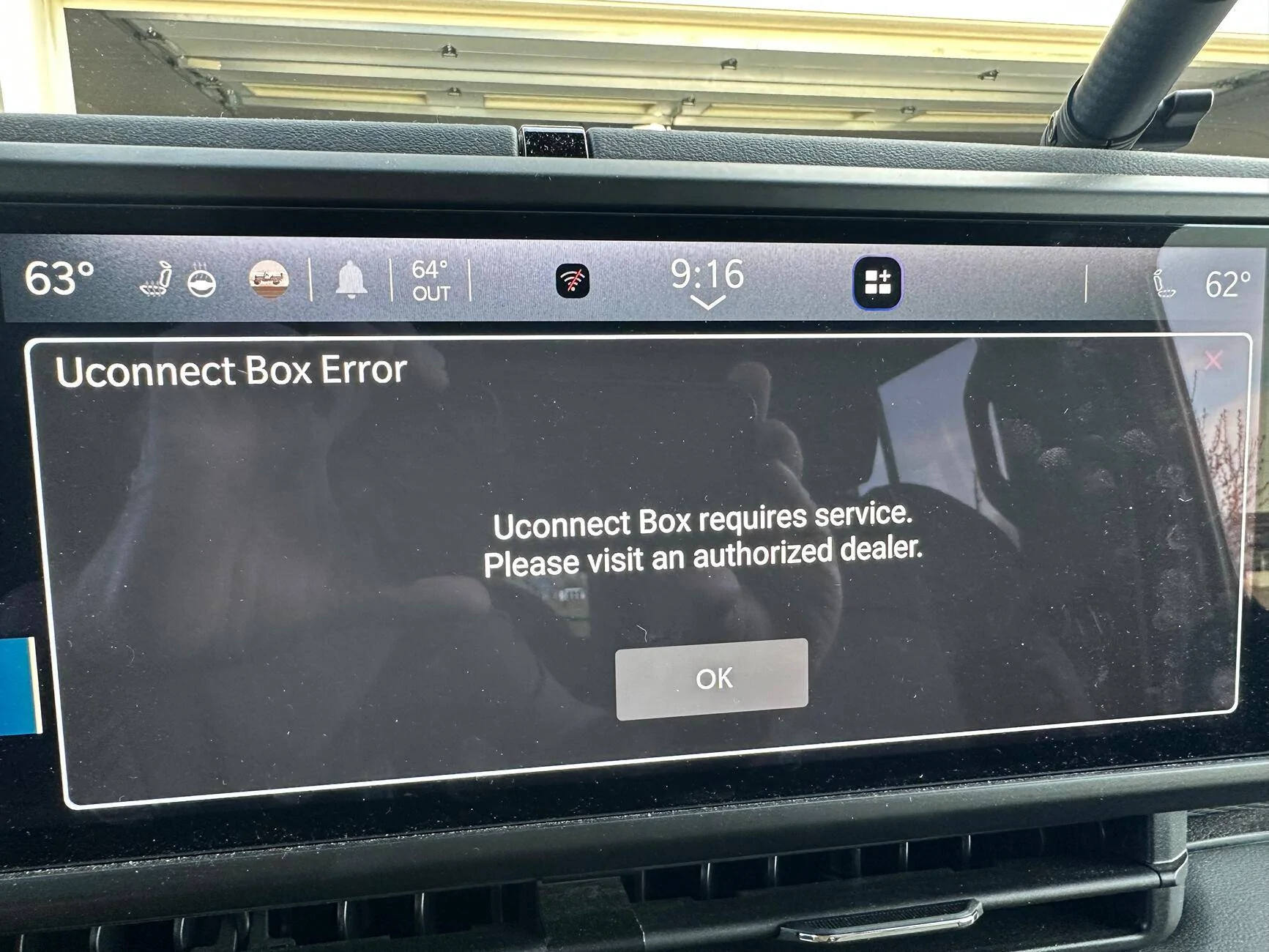

been doing some reading and some have said there can be loose wires causing the "uconnect box needs service" alert..I read it was behind the glove box but nothing behind my 2024 glove box. Any ideas where to look for loose wires/connections? my XM radio works fine thanks.

You'll need to scan the code to see what's causing it. The cellular antenna #2 code due to a bad antenna connection is VERY common on our products, but I've never seen it on a JL before. I have, however, had to replace a few telematics modules on 24s already for internal failure DTCs.

so will it actually need to be showing the uconnect box error for them to get the code as it comes on and then goes off and will stay off for several miles before coming back on. yesterday it was off most of the time I was driving and the red assist and sos buttons were also not lit up today it came back on for a while but then went off again. thanks.

Codes should saved in the system. I actually ran into this exact issue the other day; the 7-way microphone in the front headliner failed and was causing this. It was two microphone open DTCs active. It was a 2024 as well. With the microphones not working assist/SOS is obviously disabled

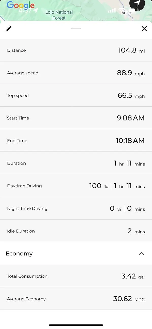

well for the last 3 days it hasn't popped on the screen and the sos and assist have not lit up red..the trip log in the app tho is only partially working. today I did about 150 miles and it only logged part of the trip and said I was averaging 88.9mph yet it showed top speed I went was 66.5mph and averaged 30.62mpg..

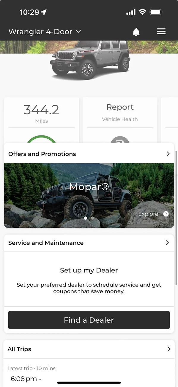

Hi, @jadmt, How do access the trip log? I don’t see that in the mobile app for our 2025 Rubicon X. (And never saw it in the mobile app for 2018 JL Rubicon.)
I can otherwise access all other mobile features, e.g., remote start, current location, send-and-go, health report, etc.

on mine it is on the page that has fuel gauge and vehicle health report. it is the opening page I just have to swipe up and it is there..

Thanks for responding. We definitely don’t have that. I wonder if there is a setting somewhere.
